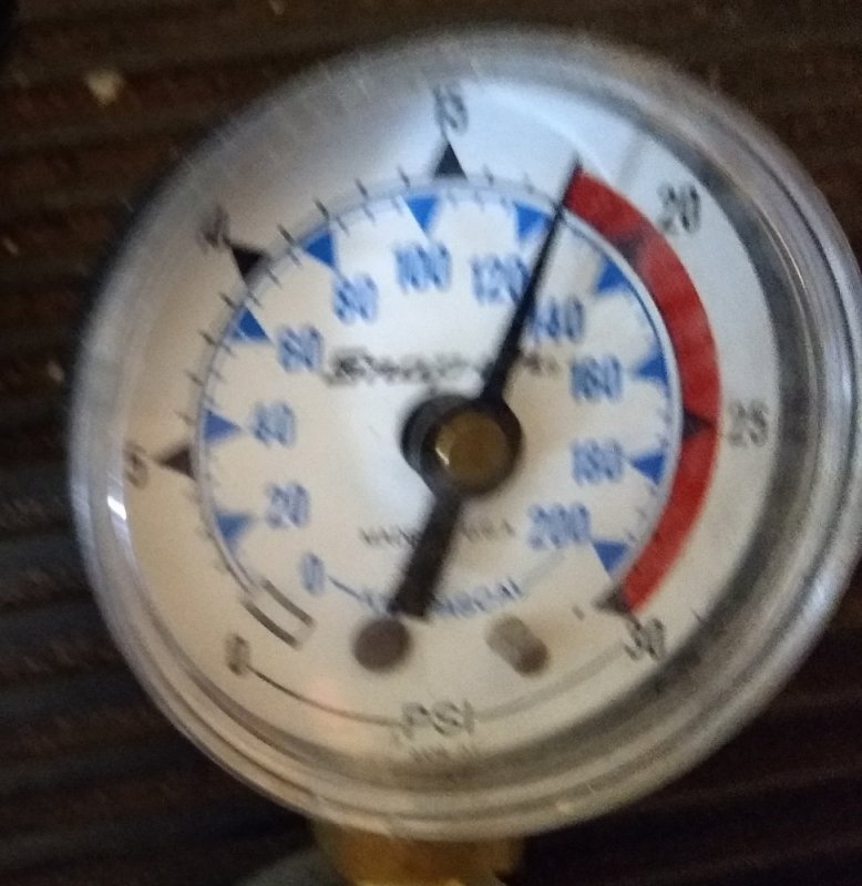

Got the dash back in it today, buttoned back up most of the way, fired it up, and charged the ac. Looks like I'm going to have to put an ac control head in it. No matter what I do, it will not trigger the solenoid for the heater control valve to close, so I have to dig into that, but I have a feeling it's the control head as it looks ROUGH! I'm also having an issue with the fans. They run as soon as the ac kicks on, but don't kick out at the set pressures. They turned on and off(at least on low speed) for the 1st fan stage no problem, but I set them to kick off at 175 psi on the high side, but they were staying on down to 155. Hopefully it's just a setting I goofed up in the tuning, but it RUNS! Another day or 2 and it's on to the next project(got a th400 to 4l80e swap to do in an 88 square body).
