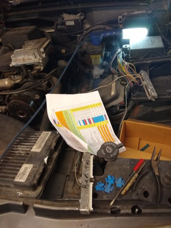

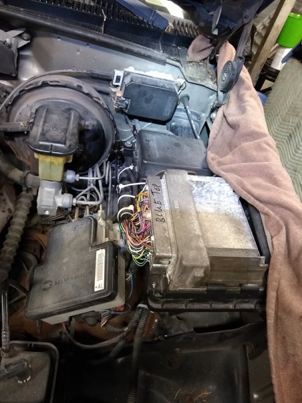

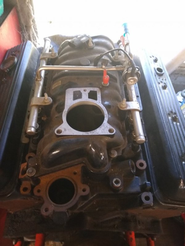

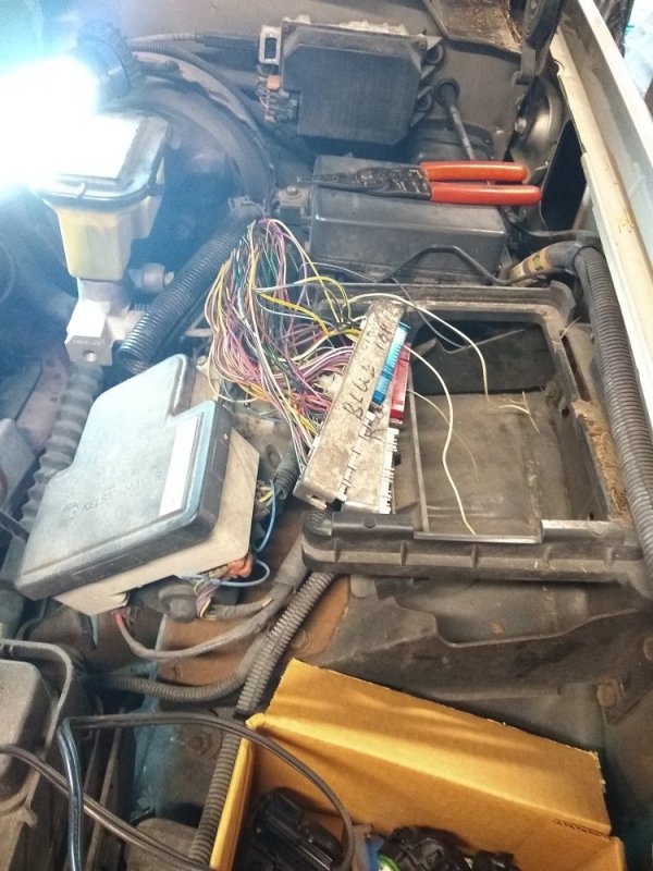

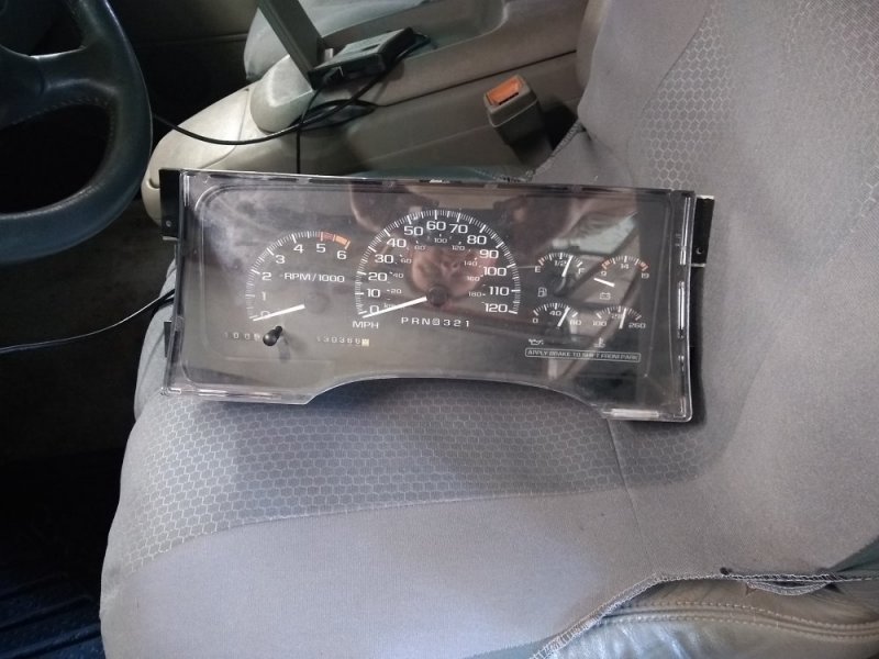

And so it begins. Haven't even tagged it yet, but the mods have started. 1st up is the 0411 PCM swap so I can tune it for mod #3. Working on repinning the plugs today(courtesy of lextech's spreadsheet) and adding the nsbu wires. Next mod will most likely be my ESCALADE cluster(120 mph speedo, white needles, and it lights up in blue). Then comes the marine intake. This one has the notorious pos spider injectors that are dribbling and giving piss poor startups, so why spend almpst $400 for the mpfi upgrade when I have a NEW marine intake that was given to me by a friend for helping him out through the years(karma does come around every now and then).
