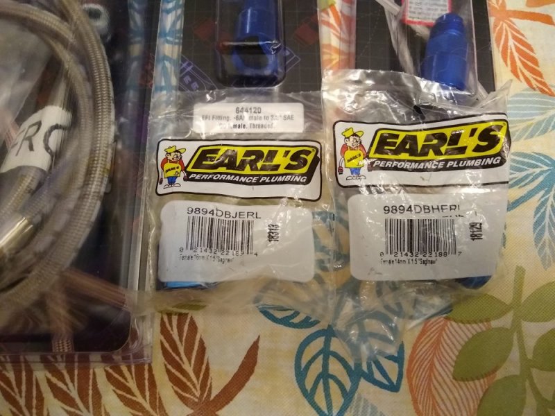

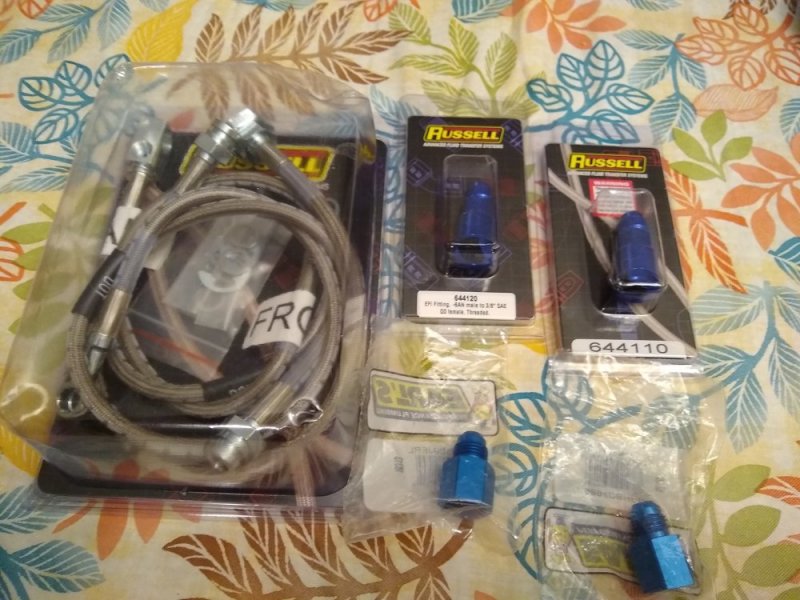

You can use these fittings for hooking up to the factory fuel lines that use an oring seal and then connect them to an hose.

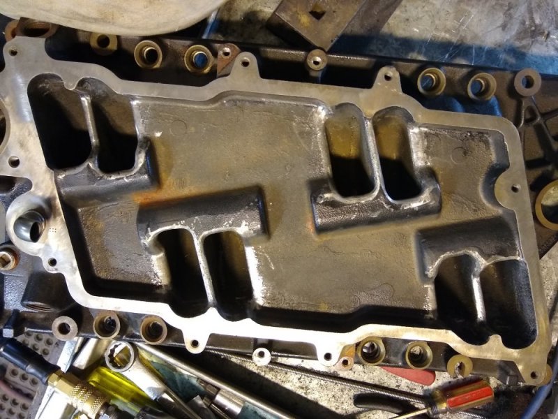

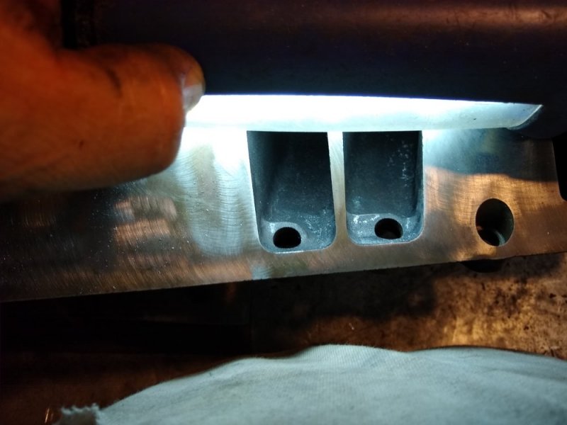

Since I'm this far into it, I started doing some porting on the intake because I'm not that fond of how they designed the intake ports and injector bosses to increase swirl and bottom end pull. I also picked up a 454 throttle body so I didnt have to port mine and mess with the throttle blade. I'm also doing a 145 amp alternator, 05+ dual electric fans, relocating the battery to the drivers side, and upgrading the cables in the process. So I've got a BUNCH of work to get done now and parts EVERYWHERE in my shop.

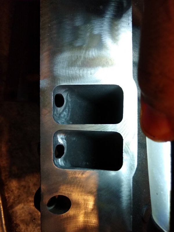

I wished I would have taken some before pics of the intake runners to show just how bad they looked. The 1st pic is after I tried beveling, rounding, and back smoothing the injector bung area. The 2nd pic is what I'm going to run. I know I could take some more, but this is for street use, so no reason to go hog wild yet. The only reason I can figure they made them this way was to have a downward ramp to create spiral where the fuel came out of the injectors to increase bottom end pull.

Here's a couple of pics I took of the intake showing some of the mods I had to do. I'll try to get a few more of it to show what it took to fit the fans. In hindsight, a set of dual SPAL fans, and a custom shroud would have been cheaper if I figure in how much time I've spent messing with these.

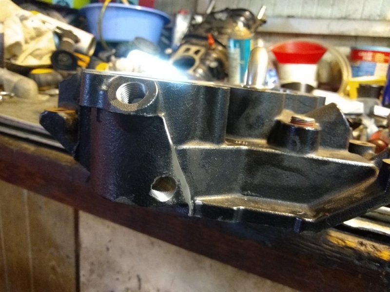

The 2 bosses I had to drill and tap for the t-stat bypass and coolant temp sensor

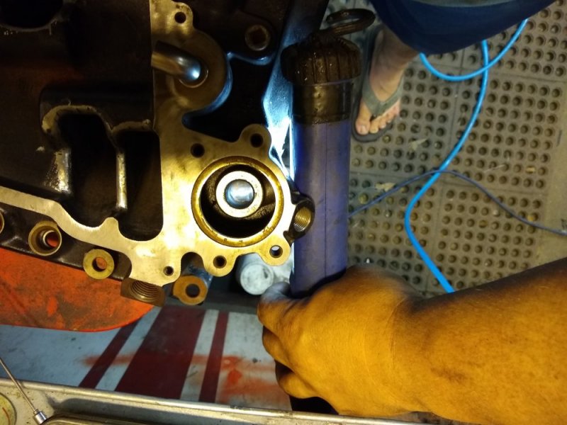

This gives you an idea of how deep I had to drill, through cast iron, and hit a certain spot while doing it. Then I took my dremel and ported the area out so it can flow better.
The inside of the intake plenum after I cleaned it up.

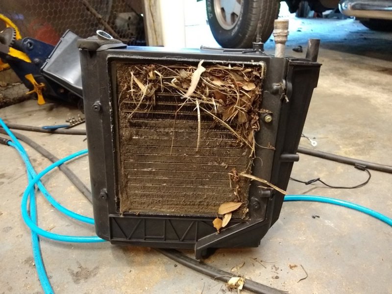

It was ice cold before, but not much airflow. The surprising part is this truck lived it's whole life near the beach with clean air, but he did have dogs he said.

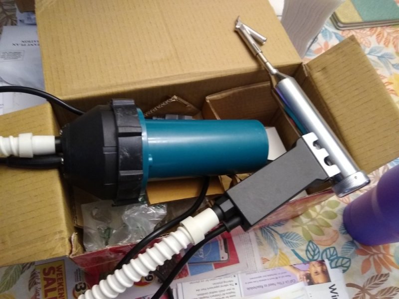

Got a project ahead of me. My dash is AWFUL(Florida sun is rough, and it crumbled when I pulled it for the evap), I can't bring myself to not do something about mine, and I haven't been able to find one much better that they don't want a fortune for. So I picked up some plastic weld epoxy and screen mesh to put on the backside where I can get to it and I'm going to try and learn how to use my new gadget to try and weld the dash from the top. It will have a dash carpet on it so I'm not to worried about how it looks so long as it is together and solid.
From what I could find on the dash it is made of PC-ABS, I can't locate any pc/abs rods in the states, but polyvance says to use PC rods on it, so that is what I'll try.
Most plastic welders are either an overgrown soldering iron, or a giant all in one unit that most say you can barely grab onto, so I decided to take a chance on one from amazon that uses a gun with a wire and hose running back to the main pump unit. The only drawback to it I can find is it's only 1080 watts where most are 1600 watts, but it said free returns, so I figured I'll give it a shot.
We have that style at work (ours is bigger) and when soldering plastic duct or pipe together it’ll look just like a tig, stick, or mig weld bead kinda. You’ll have to sand it flat when your done unless somehow the tip is different than ours.
is that hot air?
Yes, it's the same as the big hand held ones, just set up with a 4 foot hose between the air pump and heating element portion. There was alot of positive feedback on them for ease of use which worried me with how bad my joints in my hand has gotten.
It's like one of these, but in 2 pieces instead of 1 big one.
A plastic welder I am not. Got it all back together, but it aint pretty. Ran into 2 problems. The 1st problem I was expecting, and that was the welder puts out way to much air. It was blowing so hard it would blow the plastic all over the place. So I found an orifice to choke it down to about half. The 2nd problem wasn't so simple. Turns out the dash is made of 2 different layers, there's the top layer that is very soft, and is the color layer, then you have a harder layer underneath of just black. So it would blow off the top before it would get the bottom warm or the rod would melt. And with these multiple layers, i also found it changed plastic from section to section. So I did the best I could with it, but it isn't pretty.

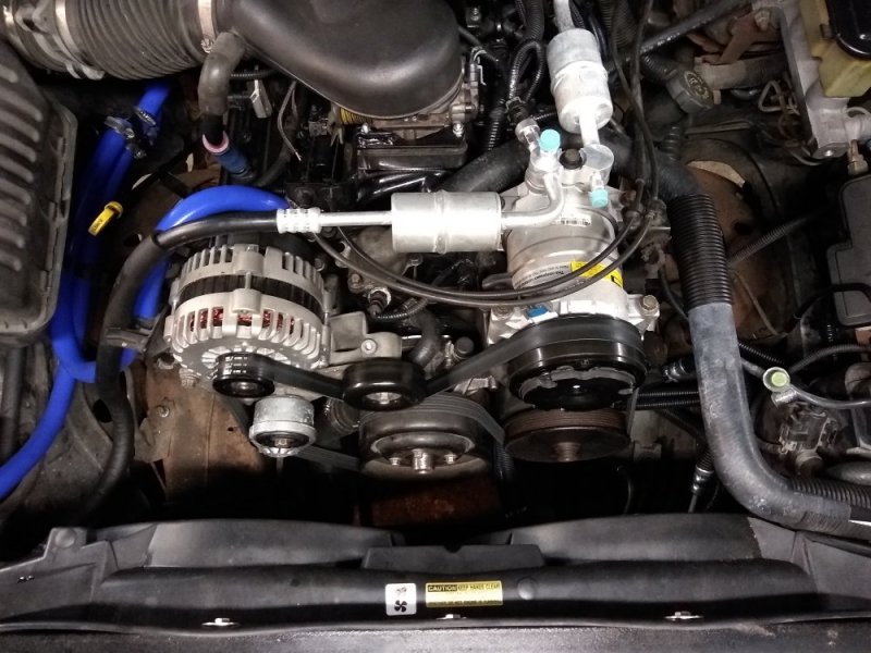

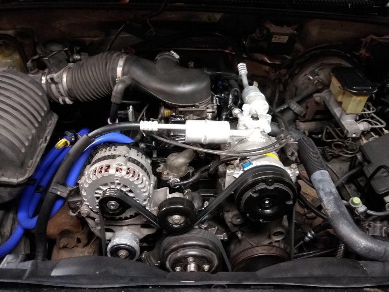

Marine intake all buttoned and egr deleted(wasn't worth the extra hassle to put in). Installed silicone heater hoses and routed the return to the radiator instead of the water pump like GM used to(it keeps coolant moving across the trans cooler at all times to maintain more consistent trans temp). Relocated the battery to the drivers side(future plans for a true cold air intake to go where the old battery was).
Cleans it up a bit without the engine driven fan. These electric fans move an INSANE amount of air. I put them on high and holy crap at the air moving.
