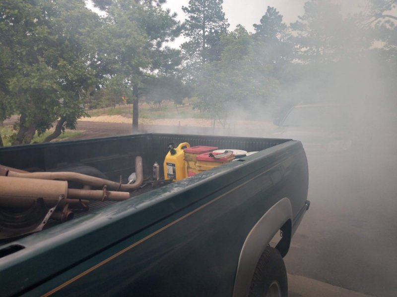

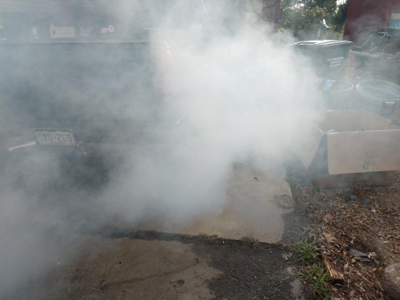

I am using the gmtd scan tech to time, eventually. It still smokes so bad . I wish I could post pictures of the this cloud . I just don't know. I don't think a compression test will tell me much, the rings have set in. No hard hoses no coolant in oil. Doesn't smell like water / coolant. Smells like diesel.
