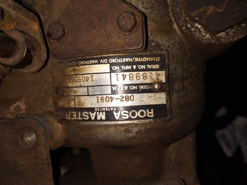

Does anyone know anything about the roosamaster db2-4091 ?
Roosamaster --> Stanadyne
Same thing, different name. Literally "Standard Screw" becomes --> Stanad yne
https://www.stanadyne.com/history/timeline/
Very likely that old pump could use a rebuild esp. for improved governor parts and worn advance piston. I know (same brand) Pumps on Oldsmobile had governor flex ring failures/recalls from drygas use and same stuff is in modern diesel now. (Engine runaway from governor failure and BOOM!) Think of it as a carb rebuild.

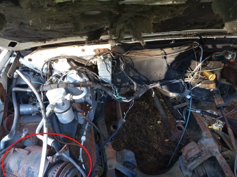

Looks like an A6 compressor! Some debate awhile ago on here as to if the A6 was ever put on a 6.2. That big displacement cast iron Tank of a compressor will perform better than the newer one that you don't have (missing in pic) on the 6.5. Lifetime of the A6 clutch not so much as it has to get a lot of compresser mass spinning. Thanks for confirming my memory as to what I recalled our 1988 6.2 had on it.

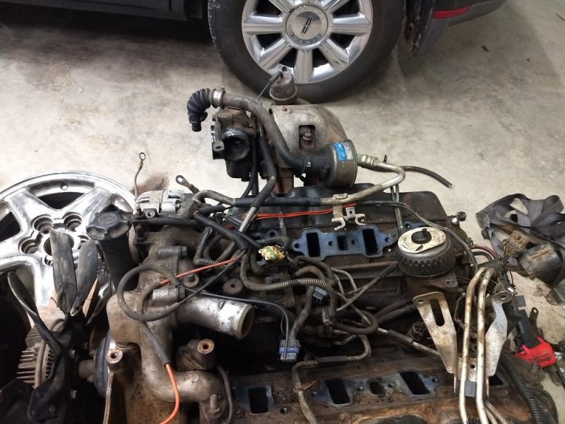

Have the old 6.2 or pile-o-parts? Looks like you are missing manifolds, air cleaner, etc.

As WarWagon said at https://www.thetruckstop.us/forum/threads/6-2-6-5-td-swap.47751/post-564282 the Turbo is going to be a problem. We had a guy move his forward slightly by having custom piping for under it made by a muffler shop and using a weldable turbo mount plate off eBay

That is the 6.5td I bought to replace the 6.2

A6 compressor under the hood here is what I was referring too, circled. It looks like the 6.5 doesn't have an AC compressor on it.

The rossamaster labeled pumps are the old ones, and all the newer ones are labeled stanandyne. Yes same company- sorry my bad on crappy description.

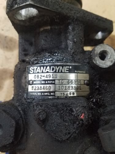

The 2831-4911 is one of about 6 highly desired 2 piston pumps. The main reason they were desired is the “31” part of the numbers as that is the size of the 2 plungers and the 4911 already had some of the better hardened parts.
Having any of the 31 sized db2 that gets rebuilt with all hardened parts achieves the same thing afaik.
It would be best to inow the plunger size, but like mentioned before, roosamaster (labeled) info is hard to come by.

On to the 6.5- you have the crap 4 bolt unbalanced waterpump. You need the new AC Delco spinon with kenedy fan clutch.
