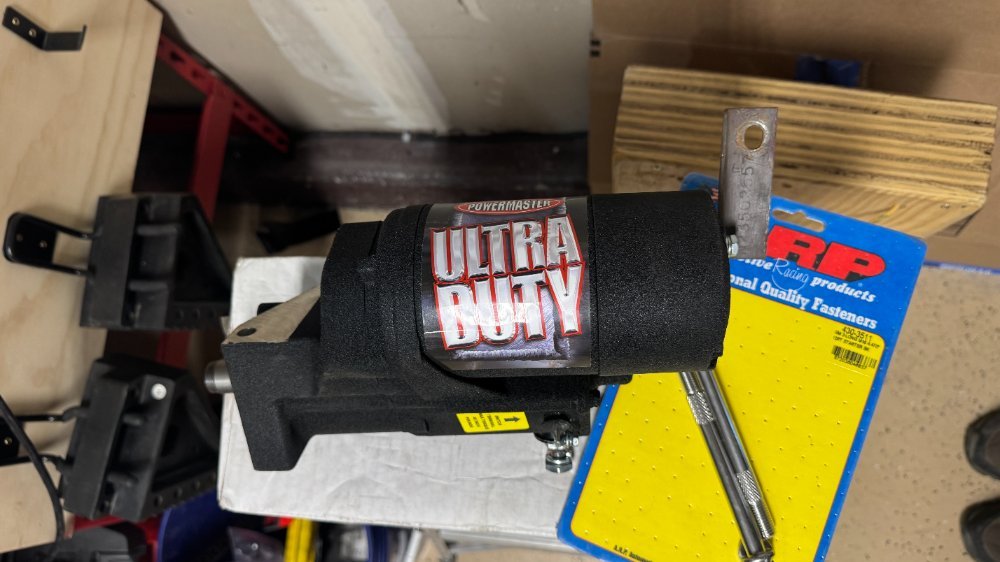

Decided to replace the starter with the new PowerMaster 9052 I acquired a few months ago.

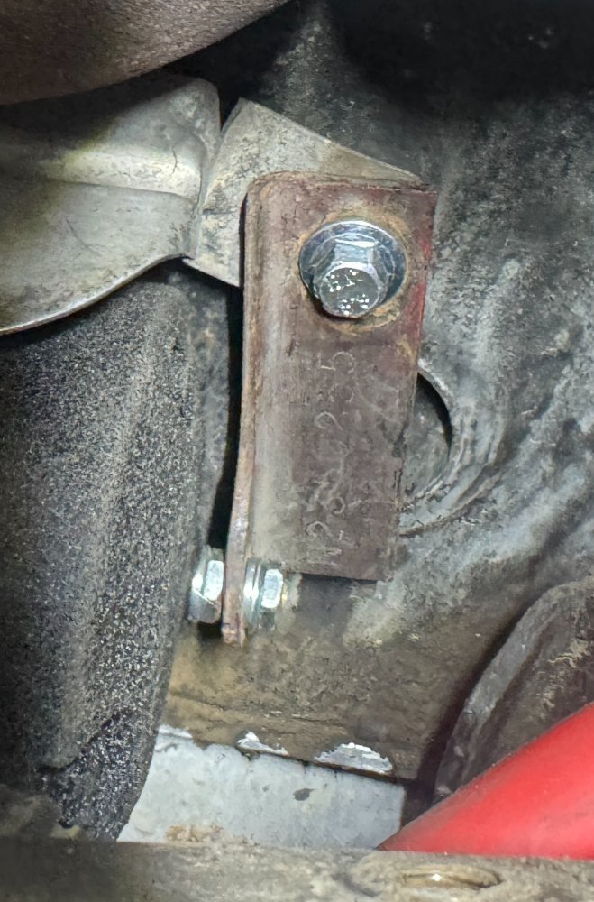

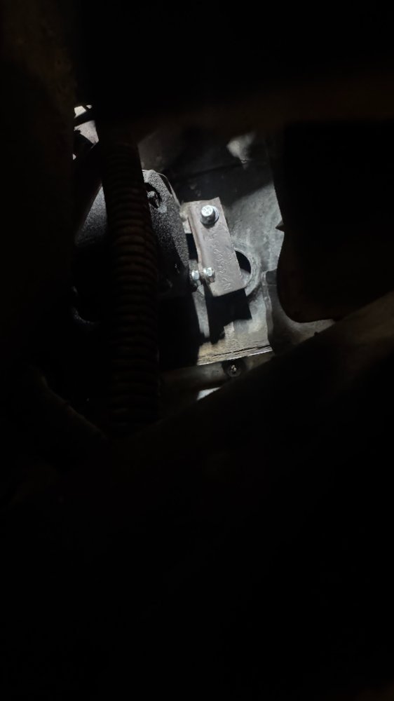

Glad I chose to go ahead because I discovered that the starter brace wasn't connected to the starter!! I mean, $%^&*

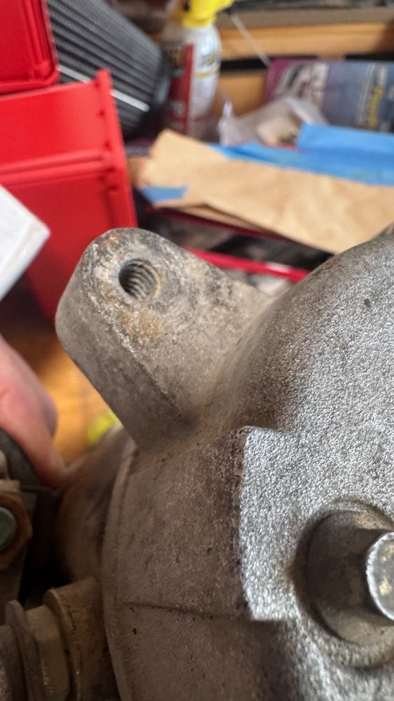

It was firmly attached at the block but, no bolt and/or stud with nut for holding it to the starter was present on the front. The threads inside the mount are fairly dirty so that bolt/stud have been AWOL a while.
It's been a couple of years since I replaced the starter on a visit to BigT's and at the time I know I had that thing buttoned up.
No damage to the block and neither the 'through bolt' holes in the old starter nor the bolts show any signs of the starter twisting. Anyway, how long it's been missing I don't know but, that's the second bullet I've dodged with this block WRT starters now.

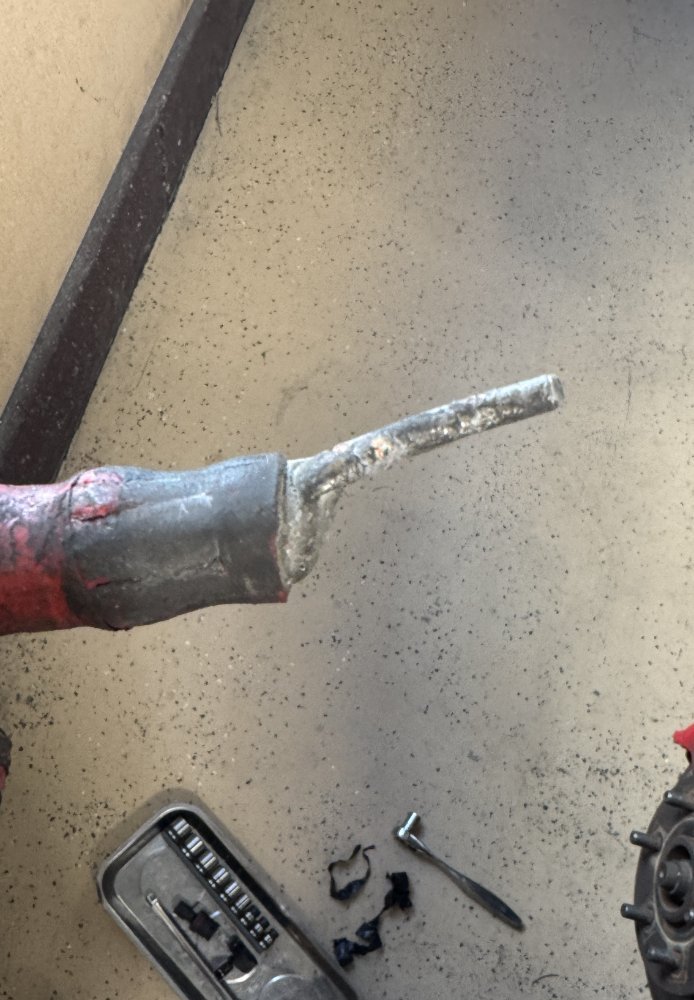

The PowerMaster went in easily enough. The main power cable put up a discussion. I've got the upgraded set from PTWiringsolutions (AKA Racedaymechanic) and with the different connecting point on the PowerMaster vs. the OEM location, the 90* angle on the cable had to be straightened out to work.

Additionally, the brace doesn't line up correctly either so there was some adjusting that had to be done there as well but, that brace is on and tight now.

The design of the PowerMaster is such I can check and retighten easier without the drama or contortions I normally have to go through
