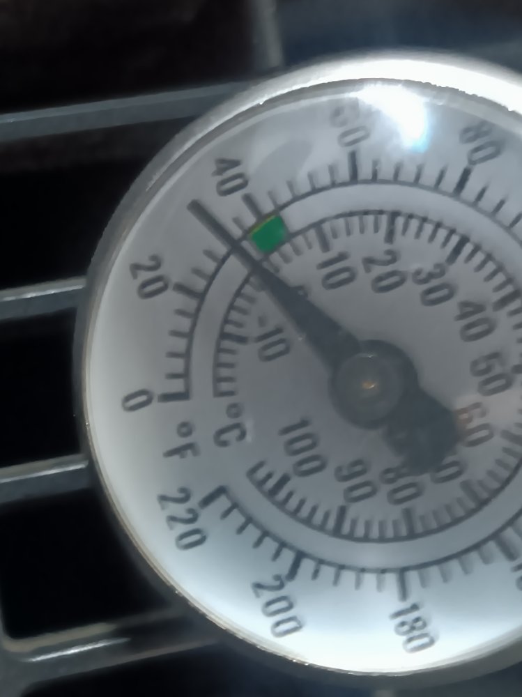

I decided to get my AC in the 93 dually going, in the past I just tried to band-aid it..
Think it's better, I'll have everything back together tomorrow for a drive...
At idle or a little more it's blowing 37* ... Idled for about 30-45 minutes not frozen yet... IMG_20260530_135132.jpg
