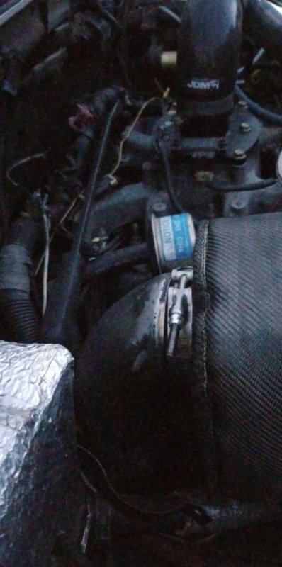

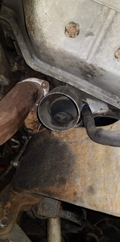

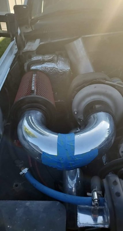

Picked it up from having a new downpipe built. 4" from the S364SXE to the tailpipe. Kid did an awesome job on it, wicked fast too. Now just need the intake elbows welded and ready to run.

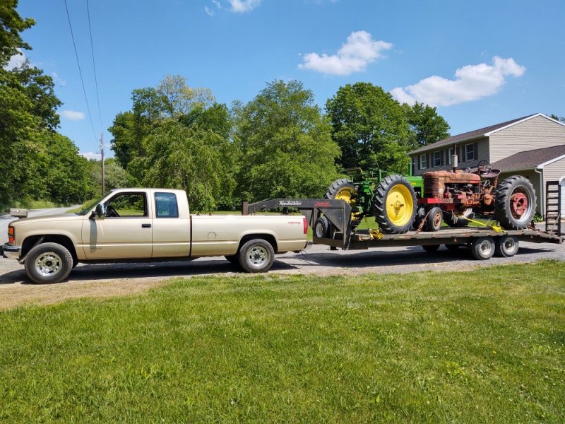

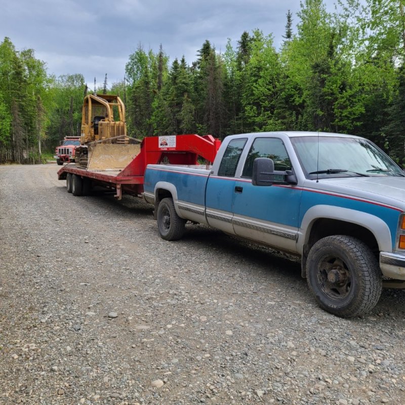

Does the truck have a 6.5 in it ?

Yes it has a 6.5. He didn't haul it very far, maybe 10 miles. He said he thinks the trailer weighs around 5k so all in around 21k. He uses that trailer to go get hay with for his horses. IIRC he hauls about 9-10k of hay with it. He goes to Delta to get it about 300 miles north.

Thats a nice load for that truck. Not too heavy, but, heavy enough to blow the cobs out of it.
This is clearly well over what the truck is rated for. I'm not criticizing. I'm more curious if what its like to pull something so far over a trucks rating.
I feel like I would need to take some extra underwear with me.
Biggest issue is brakes. He had just redone the brakes on the trailer so had pretty good brakes on it. We stopped at a light and he had a state trooper right next to him. Trooper didn't pay any attention to him at all.

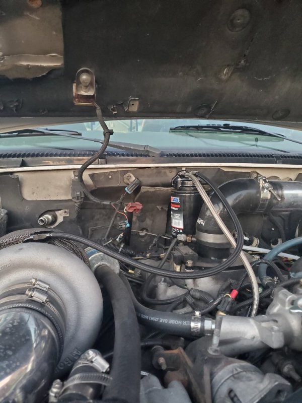

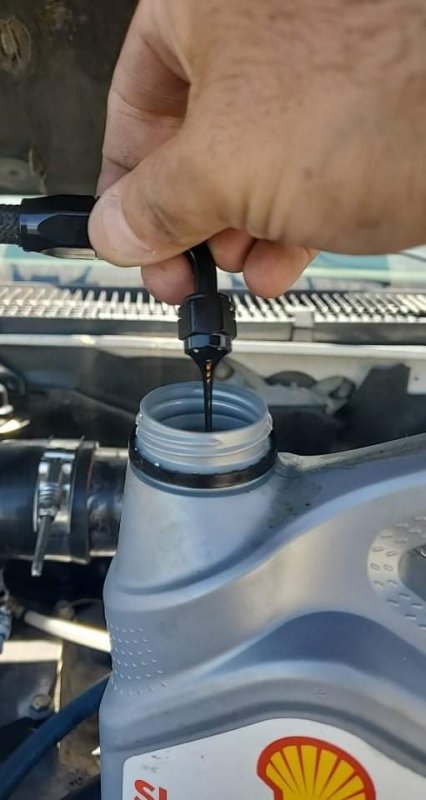

I had an idea and needed to try it out. Purchased an Amsoil bypass oil filter and head and put it in line with the turbo feed. Already had a 4AN feed hose, so I just needed one more hose. Two 1/8 NPT to 4AN adapters and it's plumbed. I prefilled the filter with Rotella T5 before starting the engine to test flow. It took a minute, but it seems to be working. Now to find a permanent mounting place.

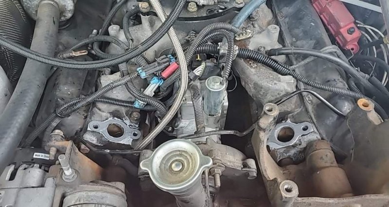

Driver side crossover gasket decided to start seeping this week for some reason. New Victor Reinz gaskets and some RTV and good as new.

‘Some reason’ where steel meets aluminum is often a clue...electrolysis test lately? This video jumps to coolant flush but if ya do that and it doesn’t solve it- or you want to save the aluminum parts of your system- get an anode.
I think the shop that did changed the heads reused the old gaskets and they finally gave up. Holding well so far, but I need some kind of anode to help hold the new aluminum radiator together.
Not different anodes. What you need is one anode that will get sacrificed before the aluminum.
The electrolysis is basically electrical charge in the coolant. It finds the weakest metal and eats it, dissolving it into the coolant.
An coolant system anode is weaker than aluminum. So that will get eaten up if there is electrolysis occurring keeping the aluminum unharmed. So all you need is one anywhere in the system. There are different types, some on the radiator cap, some screw into the radiator. With a plastic surge tank the cap style doesn’t work, It has to mount into a grounded component
So putting it into the crossover would be a good choice.
Many hummer owners replace the plastic surge tank with aluminum (i will make one from steel) and mount mine there.
Could you pull the drain plug out of our factory style radiators with the plastic sides and put the anode there with a wire running to the block or battery ground?
Would be nice if you could undo one of the big radiator hoses and just let the anode sit in there if it wouldn’t move around.
