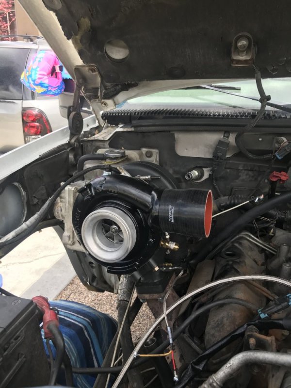

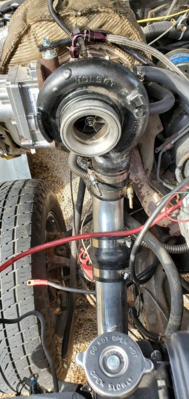

John built the adapters to mount the Holset HE351VE to the exhaust manifold, turbine outlet to the downpipe, modified the compressor housing for side exit instead of front, and compressor outlet to the intake.

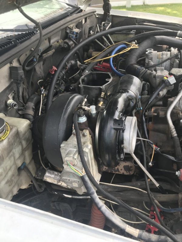

It was a complete take off turbo that the previous owner said worked fine. The actuator ended up being bad, but they are easy to replace. Sent it to John for mockup and part build on an engine, and he made and modified what he needed to make it fit, basically ended up being bolt on.

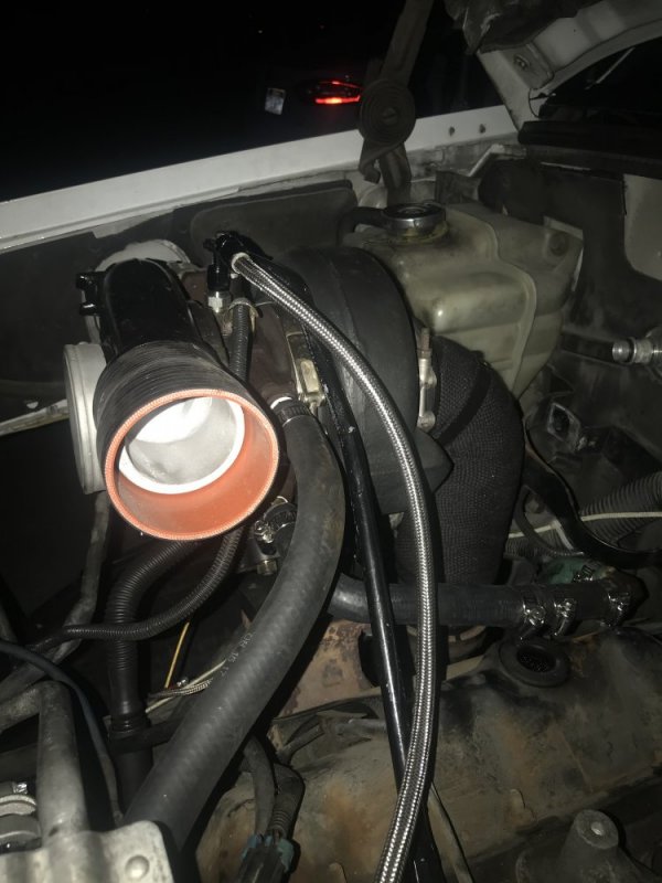

This is how it sits now. Stock compressor wheel and housing, only modification is for side exit. I clocked the compressor outlet down for the CAC.
When doing the CAC install, I was thinking about changing the compressor back to front exit but couldn't find another one reasonably priced, so I started looking at aftermarket housings and wheels, but decided to make what I had work.
