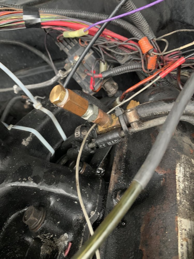

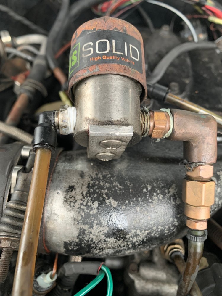

I seen some pics of the CDR in place, a hose run to the provent and another hose from the provent to the turbo hose where the CDR normally attaches to.I was looking at the CKO provent 200's on the jungle site (I'm not posting a link since I am seeing some sort of associate thing in my links) the prices are around $40, they also are showing the real filters separately. I also started thinking about what was inside the CDR. there was an extra one in the parts pile that came with the truck. pulling it out I can see it's basically an empty tuna can with a spring and baffle inside.
the thought occurred to me to stuff a stainless pot scrubber into the bottom (valve cover side) of the CDR so there would be something surface area wise for the oil to grab on to as it passes into the CDR. this might allow some of the oil to collect and drain back into the valve cover minimizing the amount of oil that would go into the catch can. whats your thoughts on this?

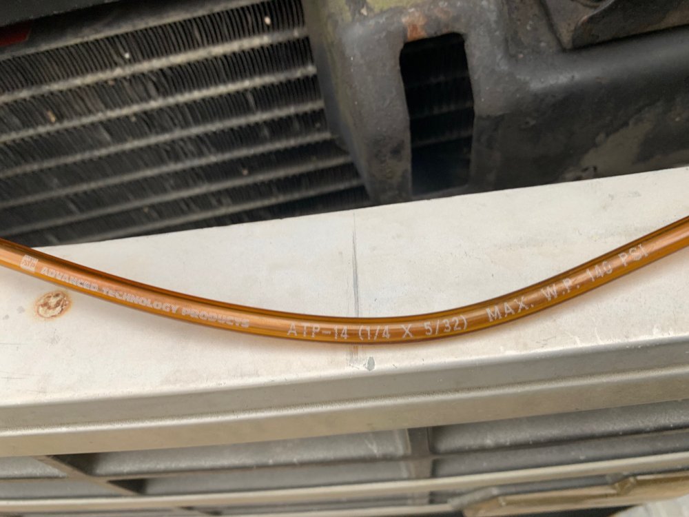

as far as finding the ideal place to mount the provent catch can, I was thinking if it could be mounted on the firewall up so that the drain hose from it might be able to be routed around and down to the oil fill neck. I have a couple of oil fill necks that have an extra hose port on them. the older 6.2's had the CDR connected there instead of the valve cover. I could reduce that hose down to the 1/4" line for the catch can drain, not unless I can have a 1/4" barb brazed onto the side of the factory oil fill tube allowing it to continually drain back into the engine.

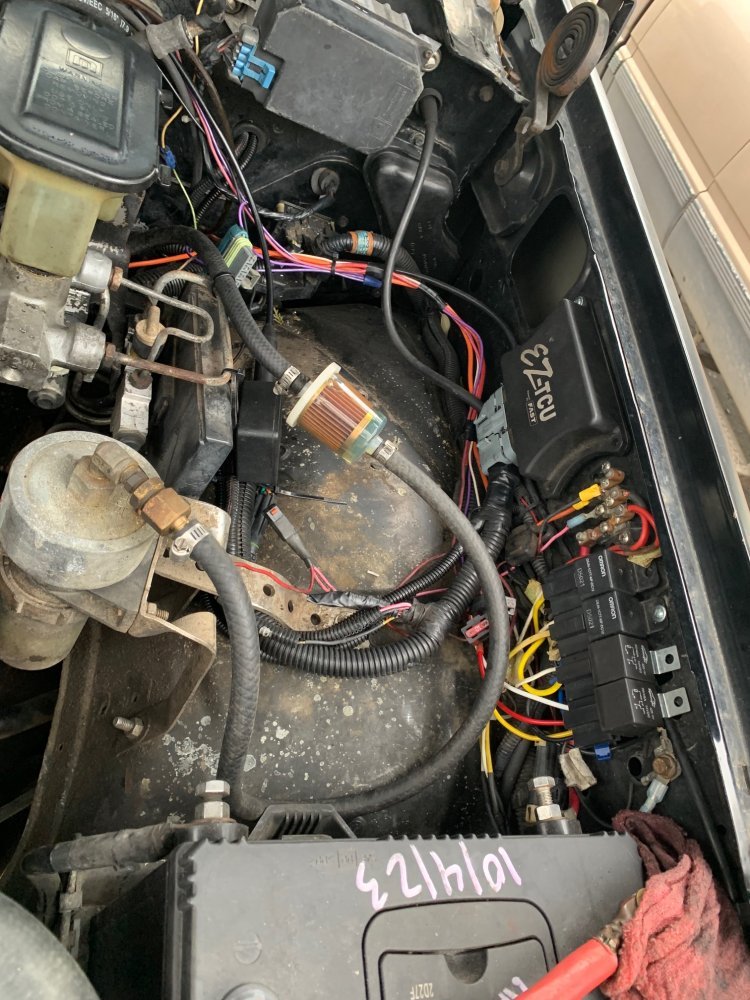

Thanks.LP relay during CRANK only.
Fuse is for LP.
IDK, I thought that relay functioned as soon as there is oil pressure.Thanks.
so I'm curious if I really needs a relay for during crank only. not sure if it actually works since while cranking I see the fuel pressure gauge drop to 0 for a split second then back up as soon as I let off the key. maybe something else I can eliminate while cleaning up wiring the PO added.
Engine shouldn't die without the lift pump. The lift pump is flow through on fail.IDK, I thought that relay functioned as soon as there is oil pressure.
Maybe after the engine is running pull that relay.
If enjun dont die then for chranking only
