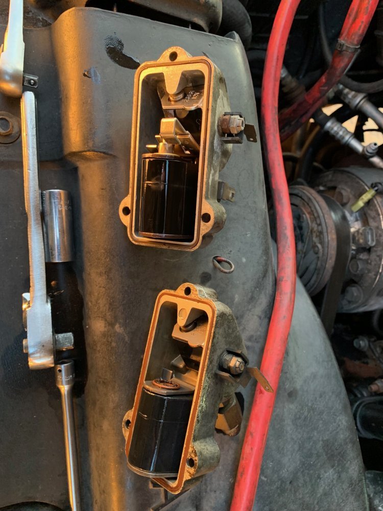

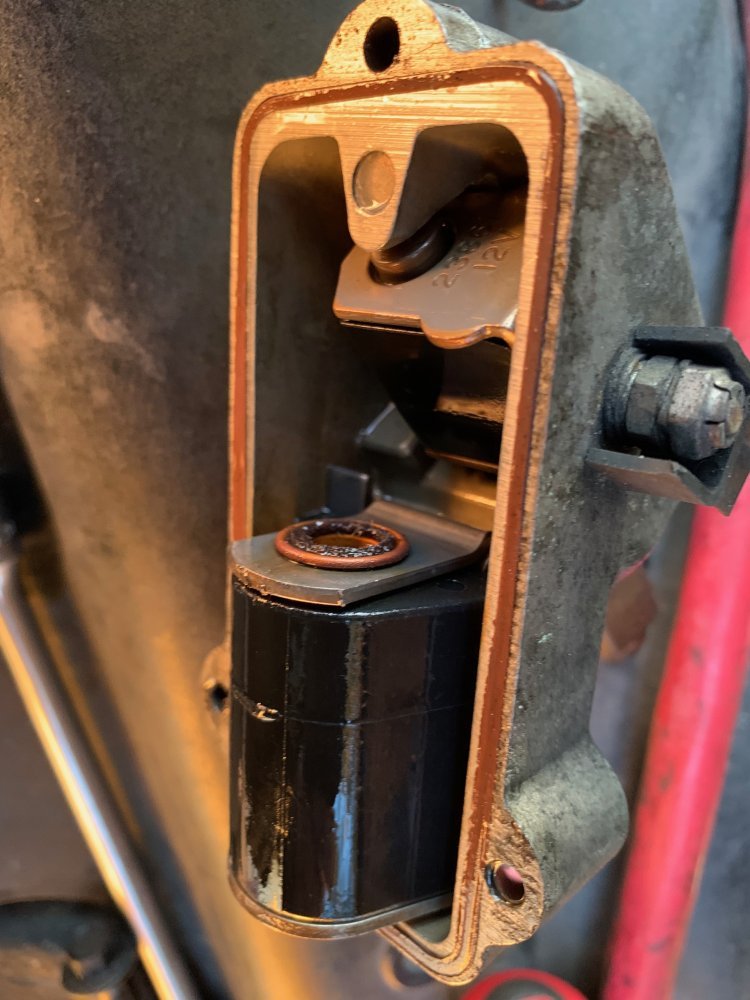

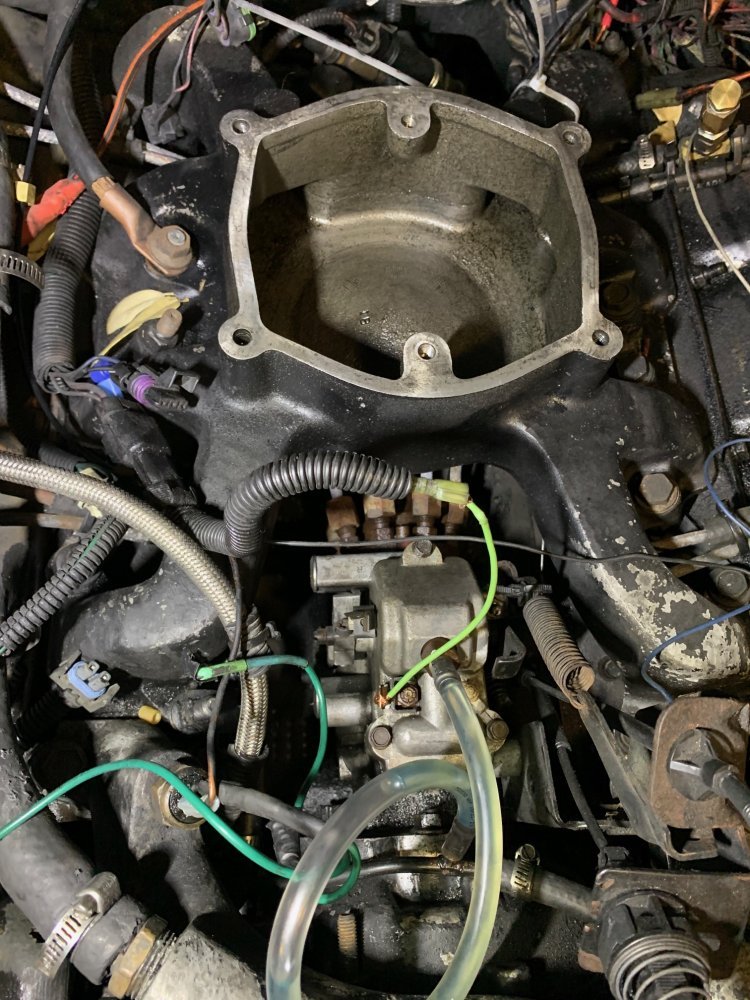

When I pulled to top off the IP on the 93 I found that part of one of the solenoids was removed. here is a couple pics on the one from the engine I have and the one that was on the 93.
Thank you! Idk what I would do without you guys. I was trying to use the wrong solenoid connection. funny thing was the rear most connection when I applied voltage I could plainly see something move looking directly down into the return line barb on the IP. I assumed that was the one. NOPE! the one that's more towards the front of the IP had a larger spade connection on it so after seeing your post I used a stripped piece of wire and stuck on the tiny hole in the spade to the wire for it since the spade that was there wouldn't fit. tried cranking once more and she fired right up!
Got the truck all buttoned up, then took it out on the road. had to go pick up my son from his friends house. Now that the factory shutoff solenoid is working, the truck immediately shuts off with the key. No more "dieseling" I even connected the other solenoid and the fast idle one on the linkage that was running to the coolant sensor on the crossover. on startup the engine was cold and it's about 42 degrees outside. that pat kicked in but not until I touched the throttle. I guess that little solenoid on the linkage needs some help to push. That part turned off in about 3 minutes after starting.

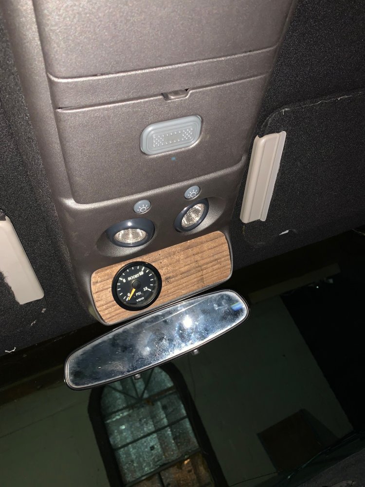

I wasn't planning on opening up the intake today but it warmed up and the sun came out so I went for it LOL. before I got into that I had been working in the cab trying to re-locate the boost gauge. I ended up pulling the overhead console and removing the rounded face that just snaps in there. wittled down a piece of old scrap pallet wood to fit in the hole, then cut the hole out for the gauge. The PO had ran more of that same 1/4" clear tubing that was used on the fuel pressure gauge for the boost gauge. I pulled all that out and ran some 1/8" tubing though the firewall, up the drivers front pillar and over to the console along with a power wire for the gauge light. when I got all that buttoned up and started to connect it under the hood is when I decided to open up the intake and do the shutoff solenoid.
Here is a photo of the results on the console. I still have room for one more gauge. the gauge trio the PO installed has a trans temp gauge but the probe won't reach to that area. I'm thinking about removing the cubby where the factory radio goes and mounting it there.

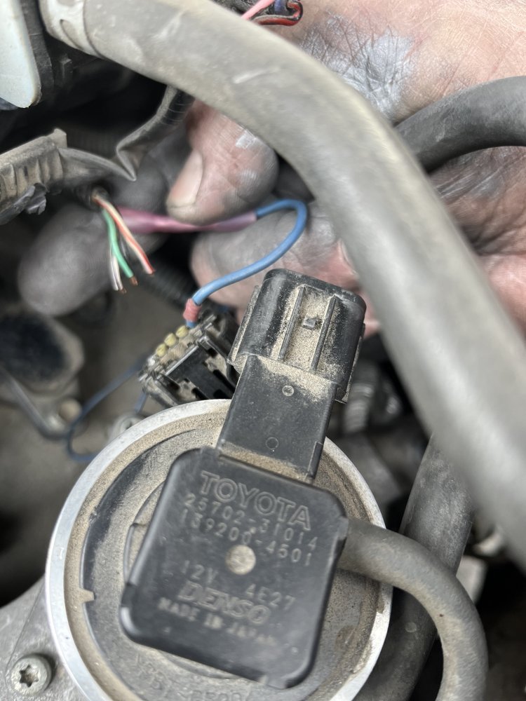

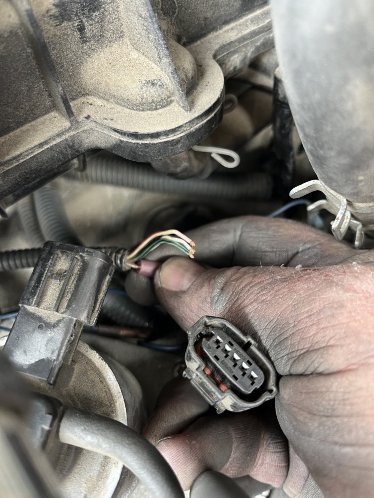

This will be a rant. Love our Toyota 4Runners, but their wire harnesses are weak sauce. Changed the spark plugs on the 2014 at 349K miles today. To do this you have to pull the secondary air valves (emissions) on each side of the V6. The driver’s side harness plug has previously been problematic with a wire pulling out the back. I repaired that, but today the remaining 4 wires pulled out the back of the 5-pin plug. I’ve ordered a new pig tail plug off Amazon, and I got the proper wiring order off the 2023 4Runner. Should have the replacement pigtail plug by Thursday or Friday. Would take ~30 minutes to install. Worst case, we drive the 2023 to SoCal.
