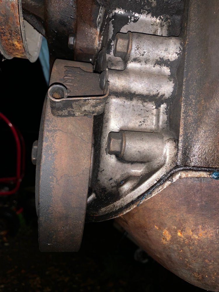

@Glagulator I stand corrected. I "thought" it had the old timing cover installed but I got a closer look. when I first looked I saw the timing indicator tab that is for the DB2 for using a timing light and only assumed this was the older cover.

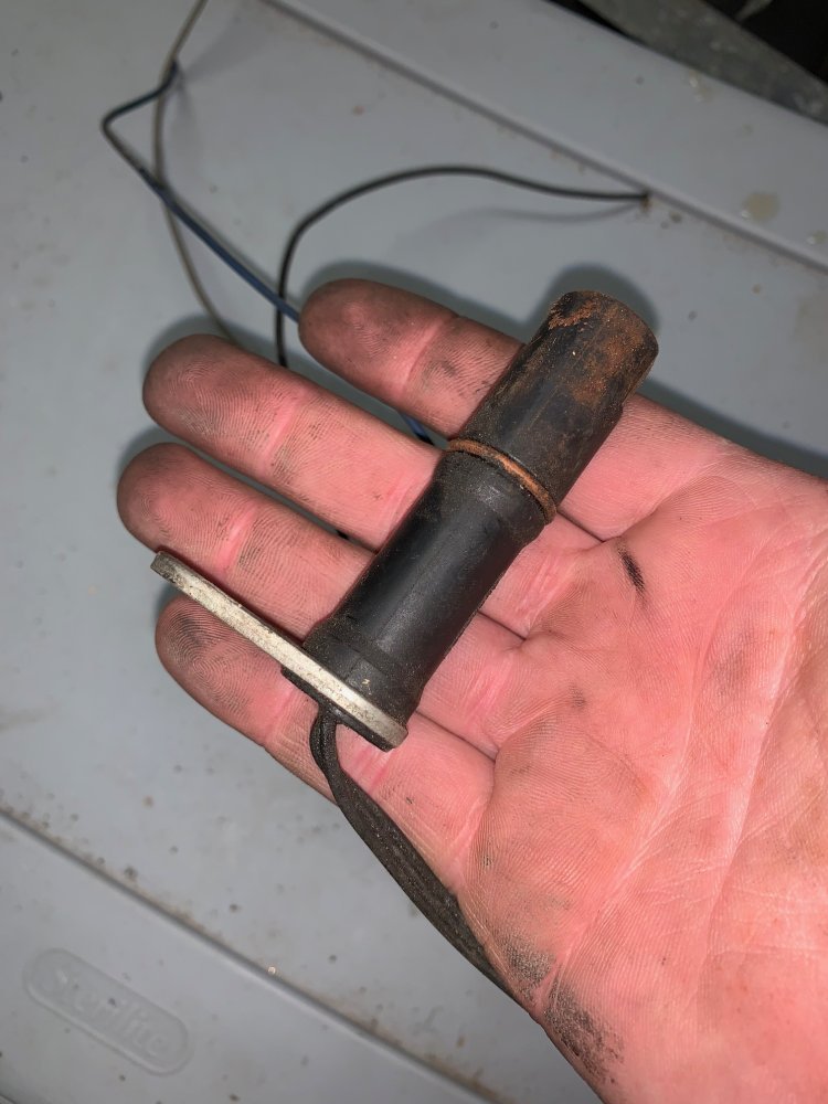

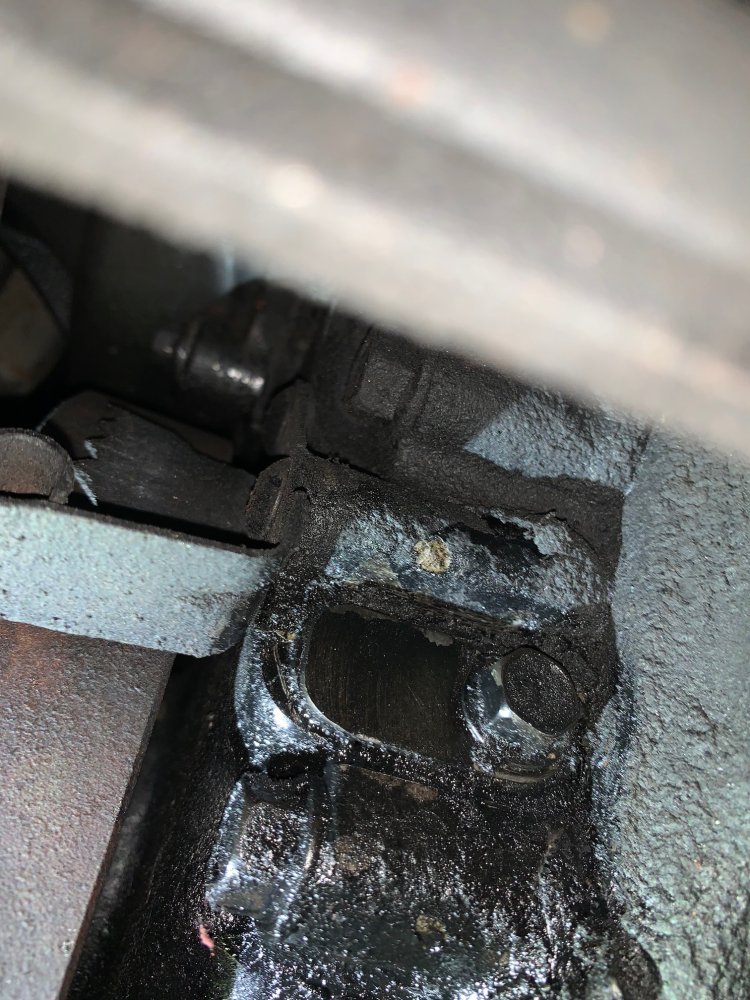

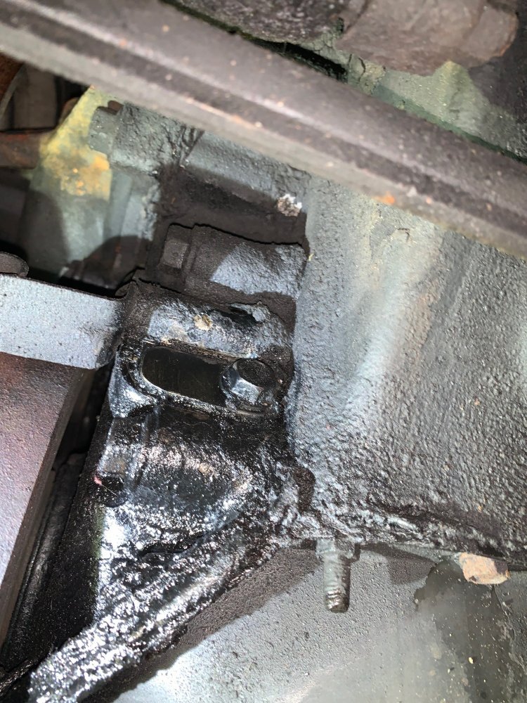

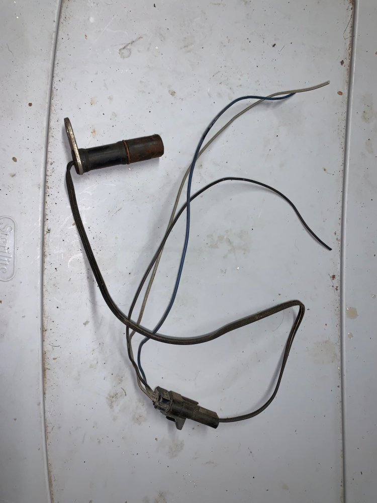

I crawled under the truck and found this... after scraping it off with a flat blade and a rag there is some sort of cover plate here. I also recalled seeing a sensor in the slew of spare parts I was give with this truck, I pulled out this sensor with a pig tail. Photos below. the last photo is a pic of the timing cover on the 6.2 block I have to compare to this one.

Thank you :) but I think I just found what I needed and had it all along. not sure if I have the right sensor, the one I have seems to be rather long.
if it's the right one, I need to find out how to wire it up to work. I might need a timing chain for it though. time will tell once I get all the grimlins worked out here lol
I will do that in the morning. we have some heavy thunder storms that rolled in. from the looks of that cover, it seems that it's hand made, there might be a sensor in there broken off. I hope not but I won't know till I get the cover off.
