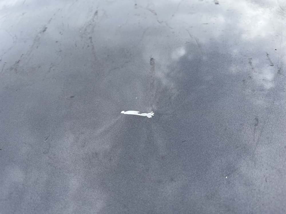

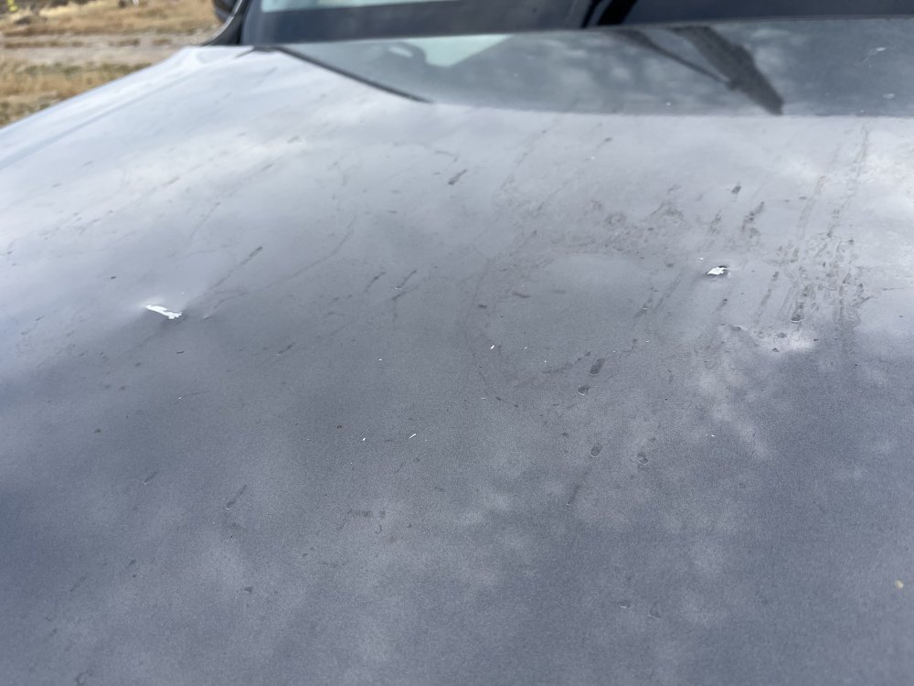

It is rare but not insanely rare. At work, typo btw it was over $105,000 not 150, the conversations started with how did this happen. What went wrong and how do we make sure this can never happen again?
“Easy- replace the fan and it’s drive every oil change.” I said and continued “Why so often is the first time I saw this occur was on a chevy that had 5,500 miles on it.”
Tire shops sell warranty because it is profit, 95%+ tires never get a single repair. The few that do they loose some time but the profit is already been paid. Go ask a tire shop salesman often they see a full blow out and have to warranty it. They are rare but not insanely unheard of.
The fan clutch is not the cause. Correlation does not equal causation. If it was the cause 99% of semi trucks made from 1950 till now would have blown up their fans.
You KNOW the clutch was engaging because you stopped engine and tested it, or heard the noise and felt the drag? Could that have been the blade flexing where it cracked before failing? Yup. Could it have been the clutch? Yup. How come all these other of other fans withstand locking up instantly without the damage?
How come the fan at my work which NEVER UNLOCKS BECAUSE IT IS CONSTANT DRIVE failed without the force of instant lockup? Simple- the fan failed.
