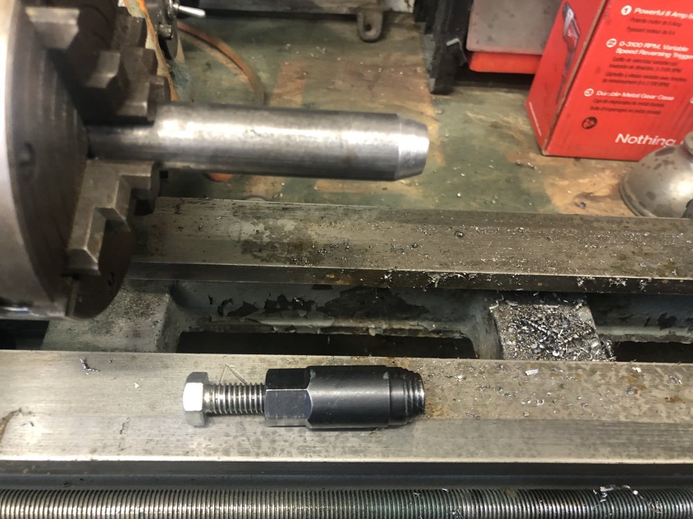

Shift shaft seal. I’m going to order the tool that fits over the shaft and the end is taper threaded and with pressure and screwing it in it grips the seal, then a bolt in the end is tightened down to pull the seal. Another tool in the set for driving in the new seal.
If NAPA cant get in the Balkamp 7769250 seal tool over night then I’ll see if this one auto repair shop mechanic has one and if He will let Me RENT/ borrow it.
