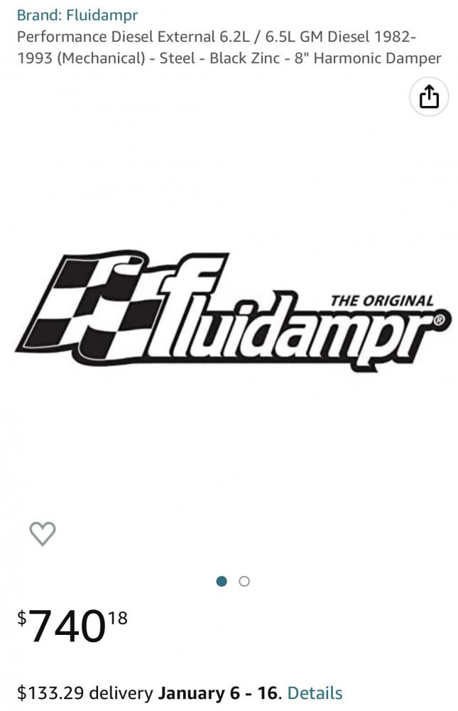

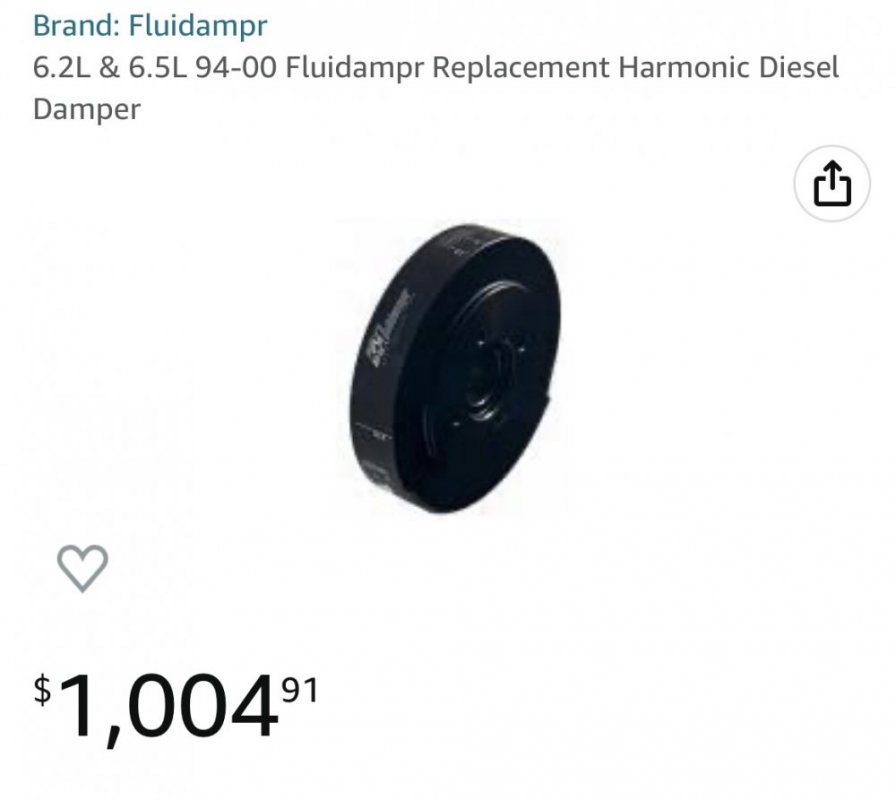

I checked a few places online and it showed close to a grand.EBay is pretty high as well but it’s certainly ridiculous on what everything costs now.Every year the prices are getting higher.
That would be over $700 with exchange rate.Not sure about Canada’s pricing but, multiple US sites to include Leroy are listing their Fluidamper HBs at around $530.
Then add in any import duty fees and shipping and you could very easily be at $800CDN.

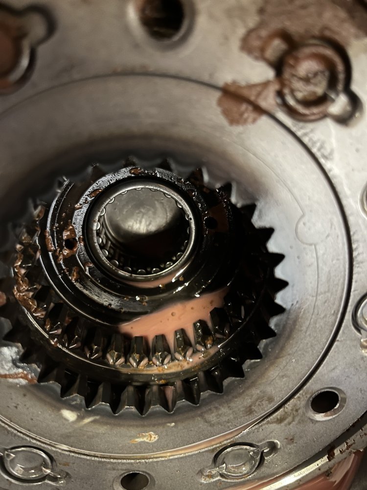

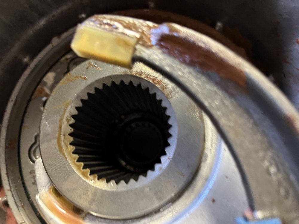

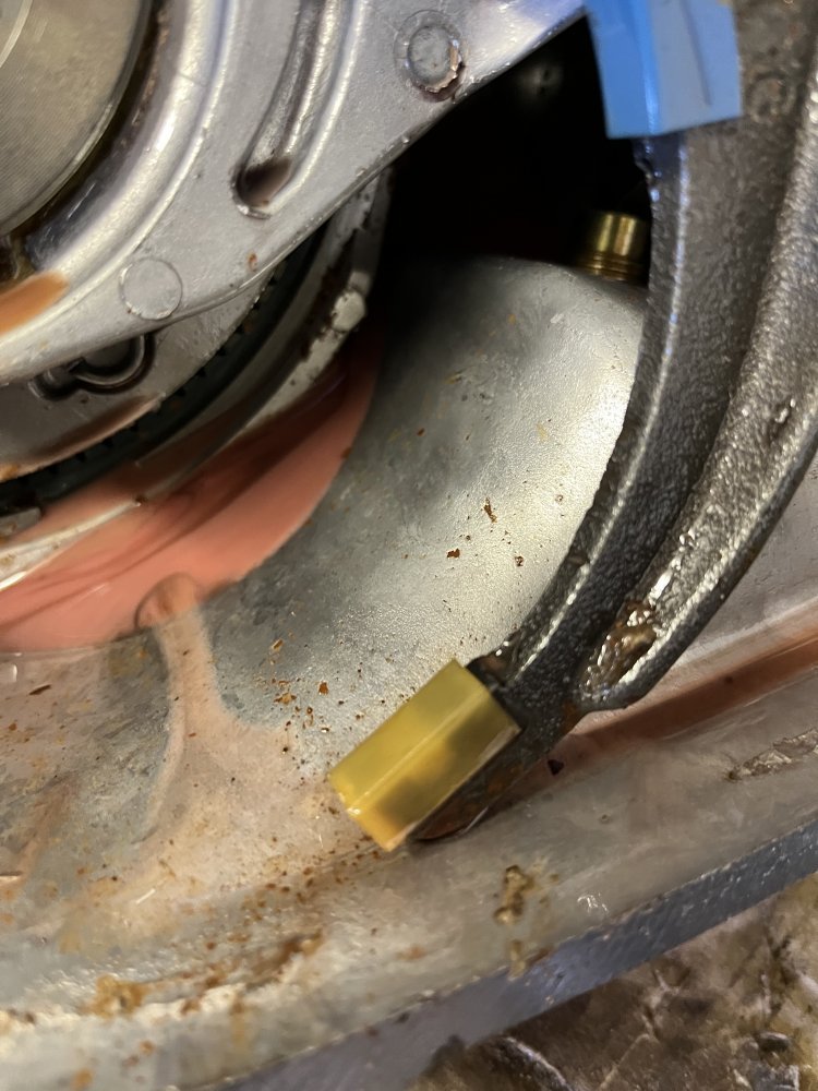

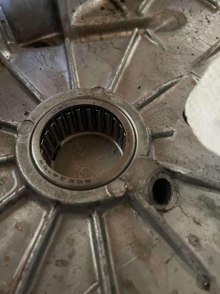

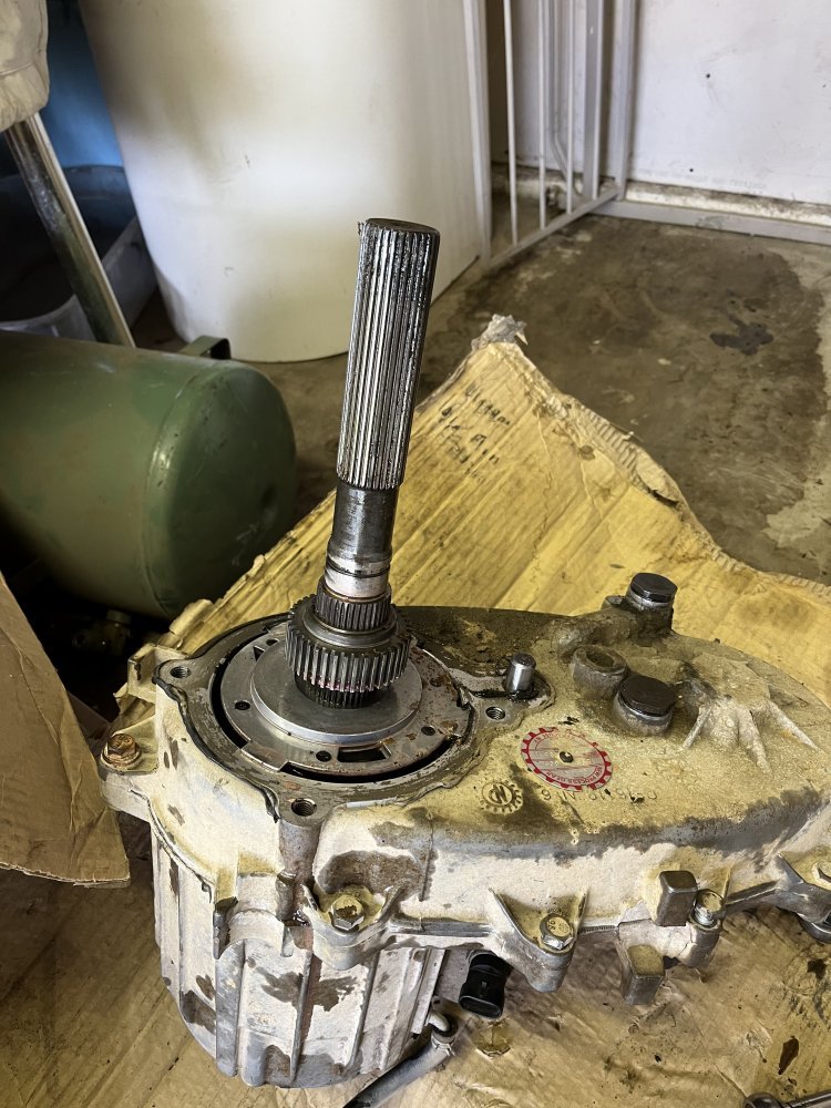

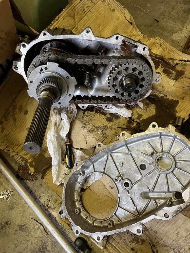

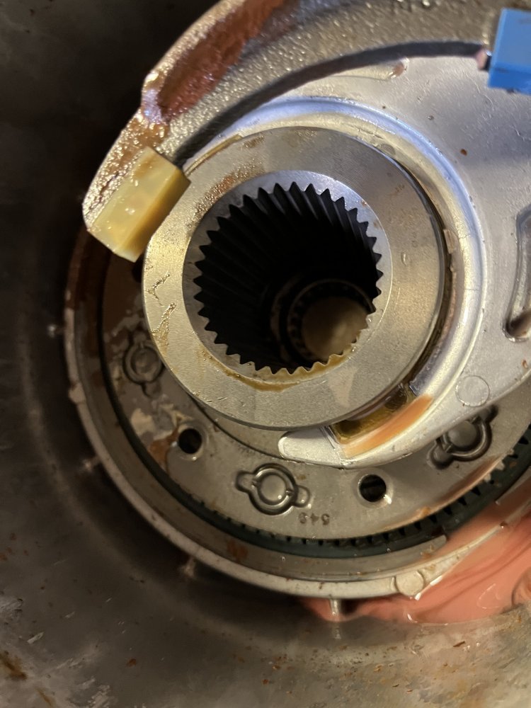

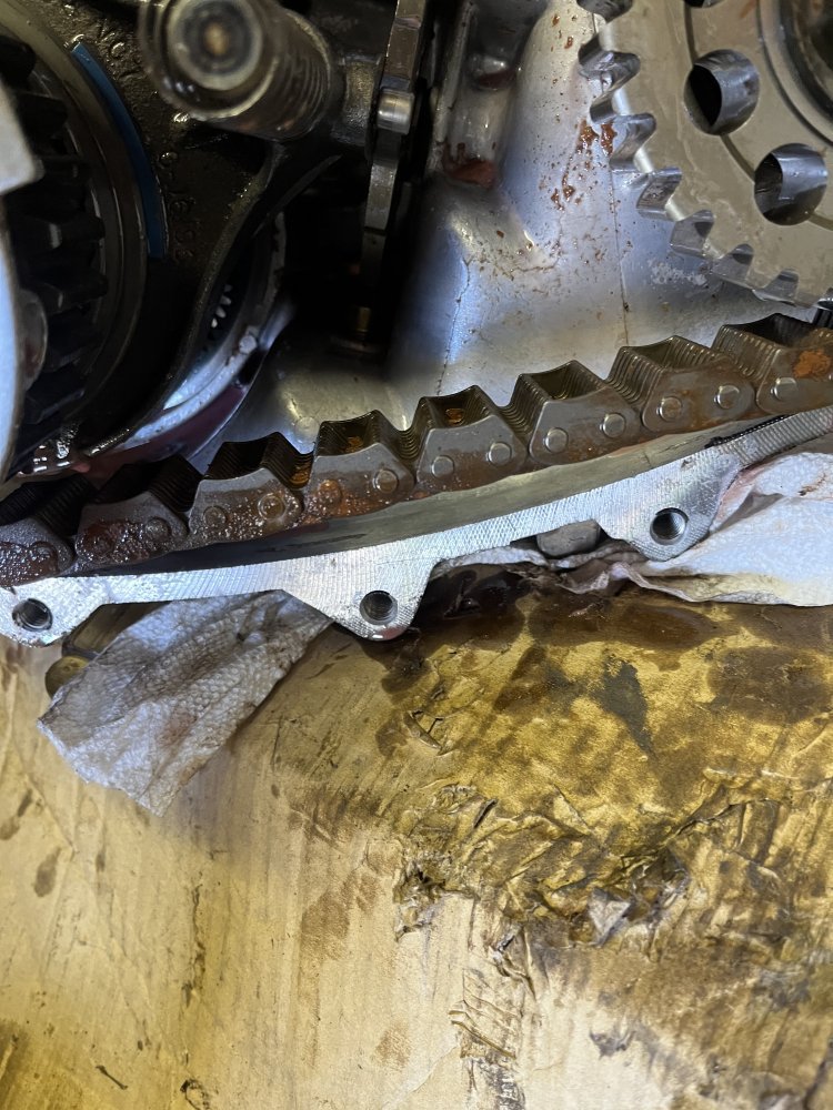

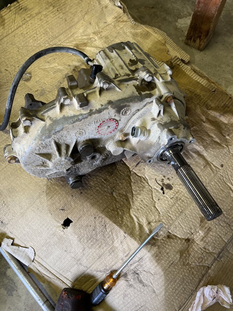

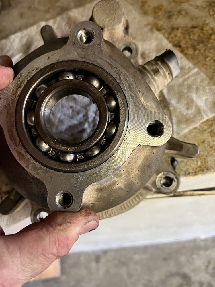

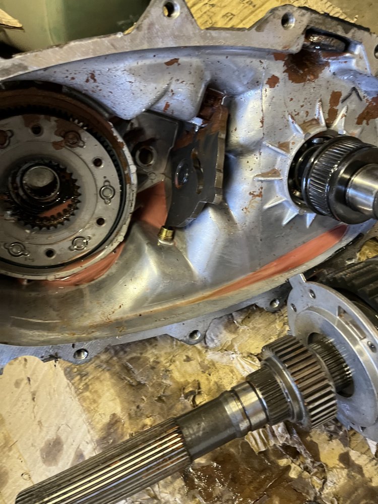

I never operated, just sat for a month or two with water in it from fall rains. The rear was tilted up so as to not dump ATF, but it must have been right under the edge of the roof.Water in that t case- replace that pump. Examine all the bearings and races extremely close. I can’t see which set up yours is, if it uses clutches they get replaced as well after water ingress.

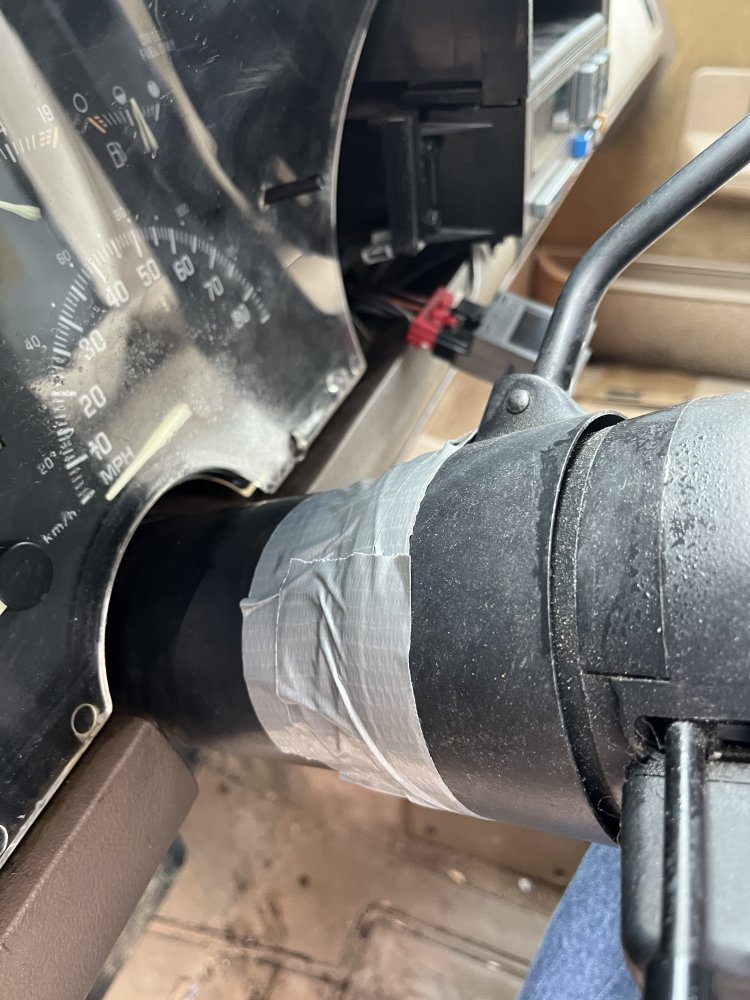

Just open it in YouTube and you’ll get full screen.Duct tape for the win! Now we have to duct tape your phone into landscape for videos and the world will be a happier place! Haha
Guy at Work was talking about his last jeep and how he had to count from park- 123. SMH. Amazing because he is ultra picky about most stuff.
