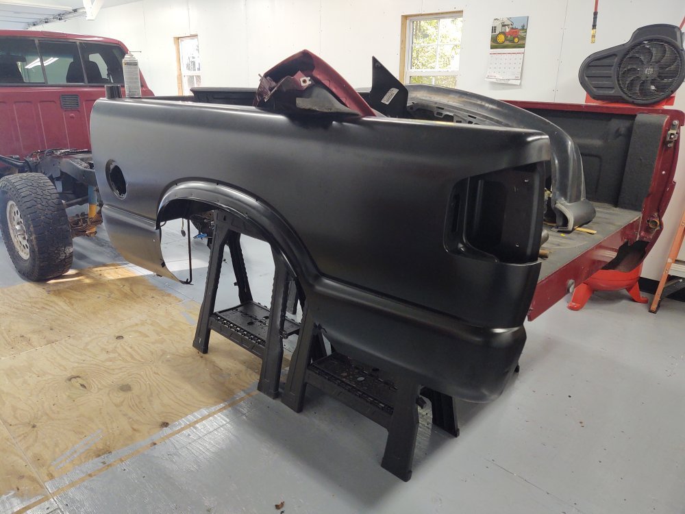

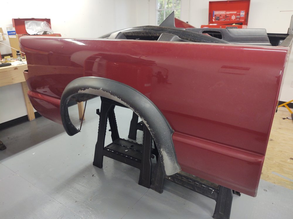

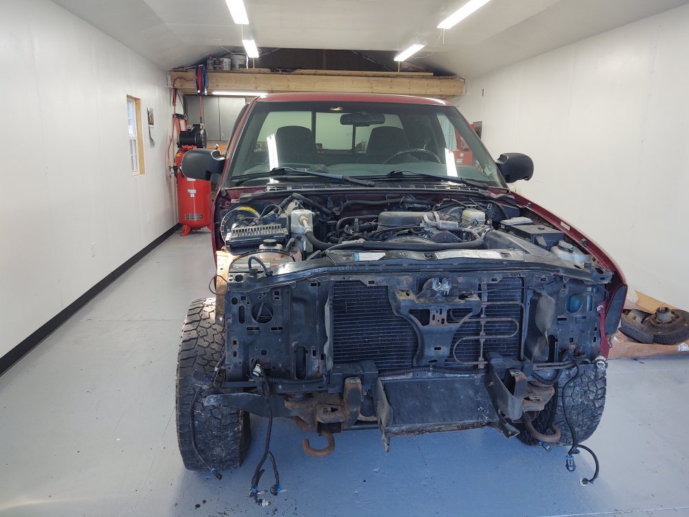

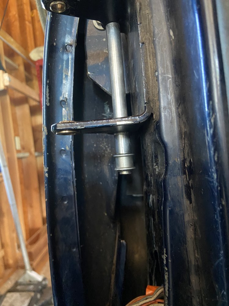

Those fender flares seem to be like the ZR2 units. I almost guarantee that the studs on the flare will snap off (not that it matters since you're replacing them). I have to get a new set for my little truck once I finish excising the cancer.
Not a GMT400 or a 6.5, but life isn't fun all the time....

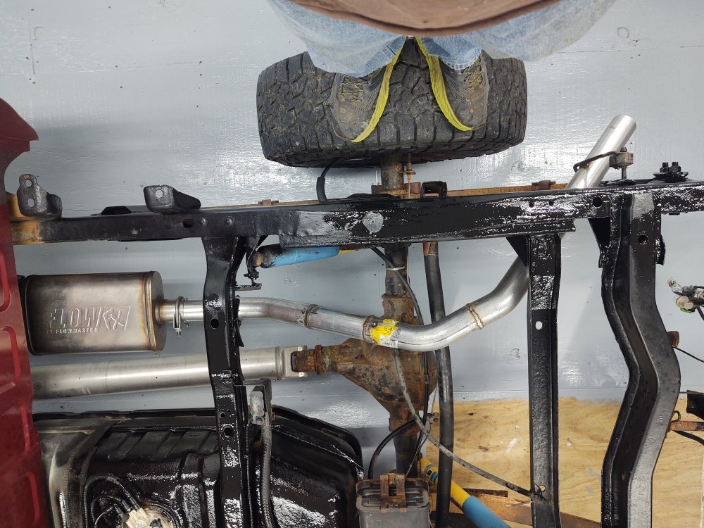

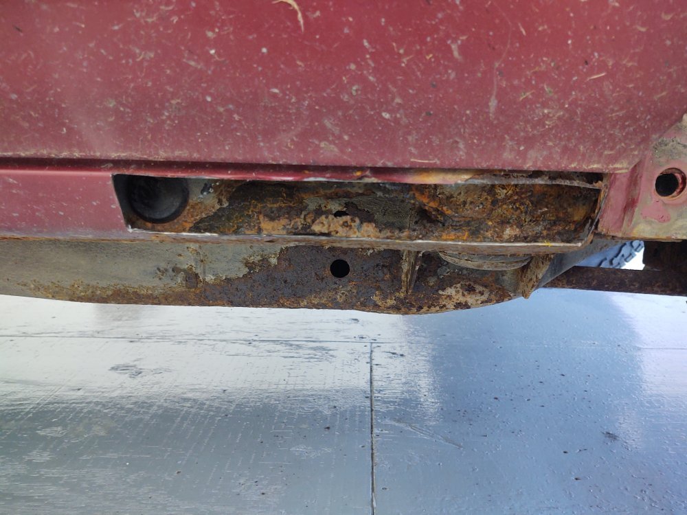

New rocker panel is on the way, new cat-back exhaust (first attempt at building one), new brakes lines, and a lot of Fluid Film on the frame.
I haven't had the greatest results with fluid film. I'm not real impressed by it's longevity.
I had better results with Amsoil heavy duty metal protector and other oils an lubricants.
I use anything that's handy. Marvel Mystery oil seems to work pretty good also
