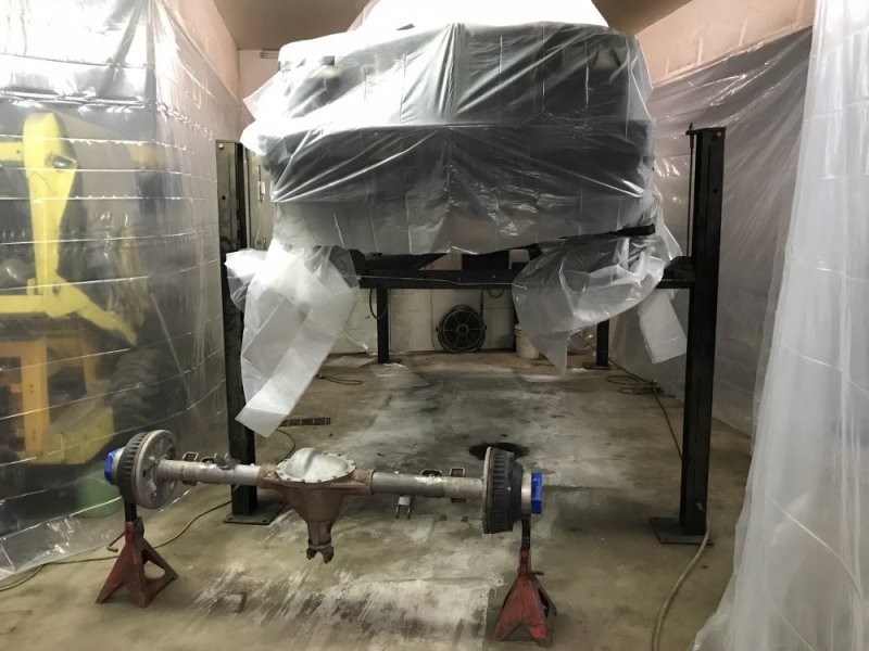

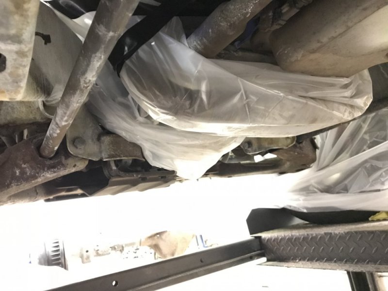

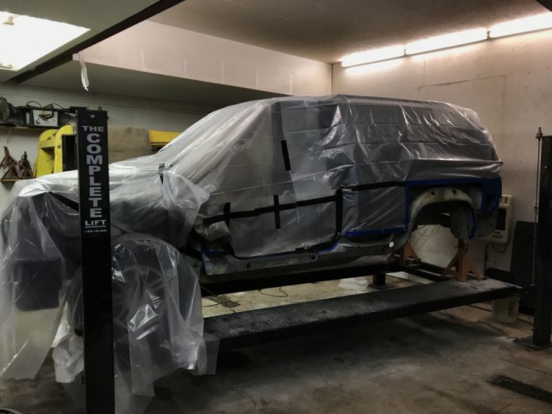

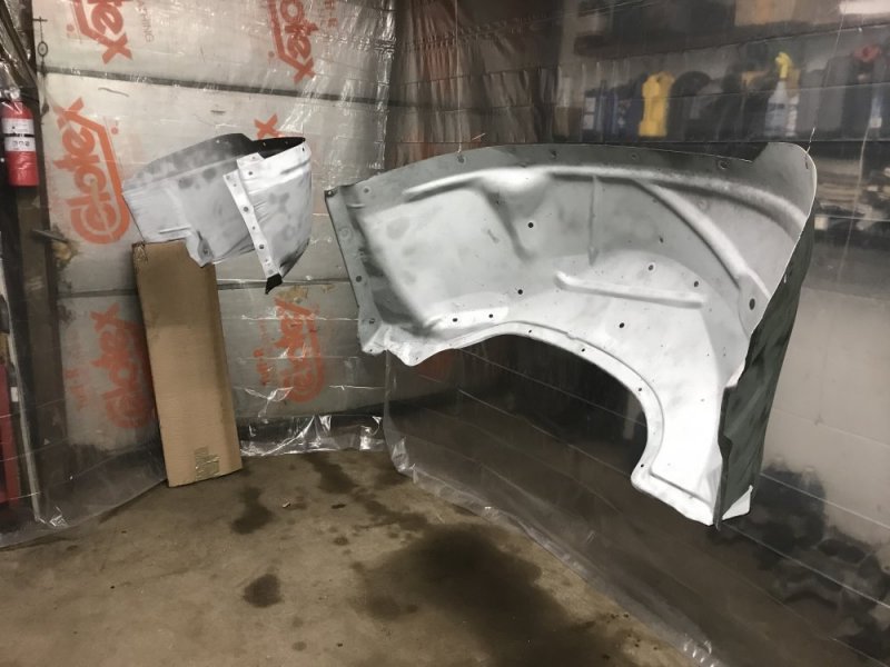

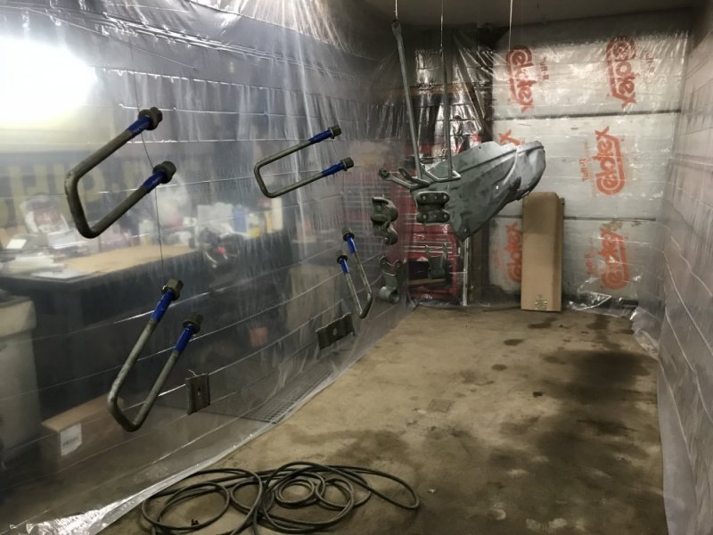

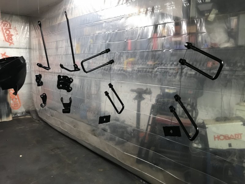

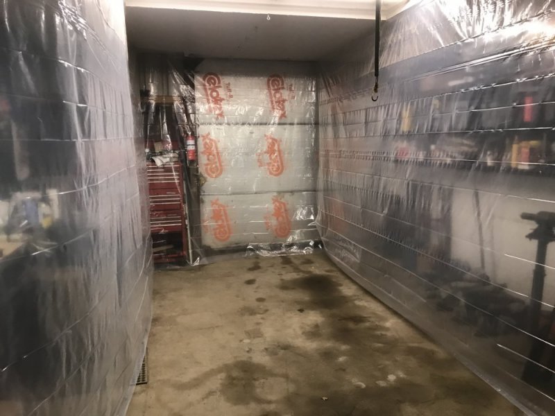

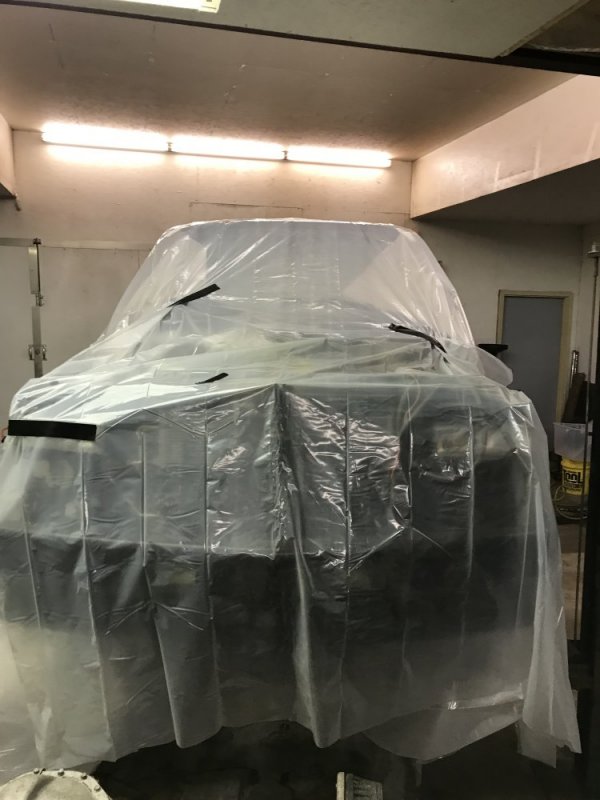

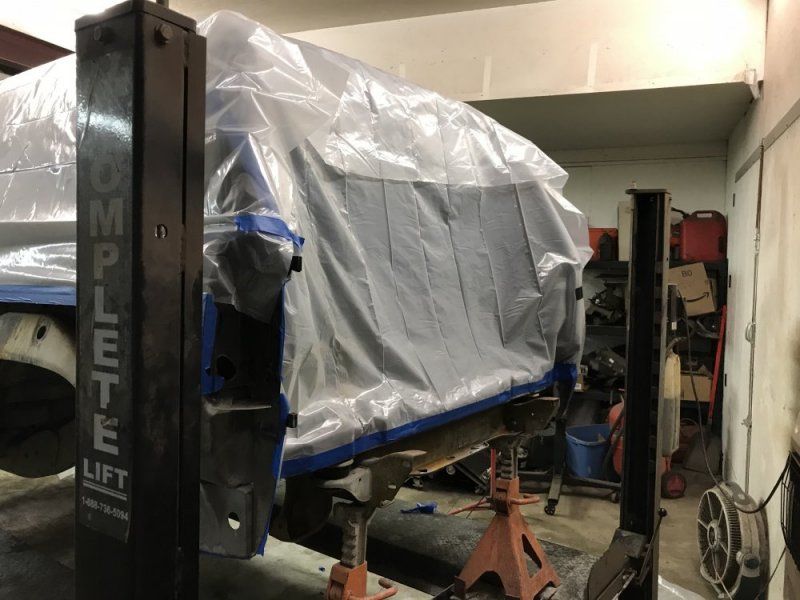

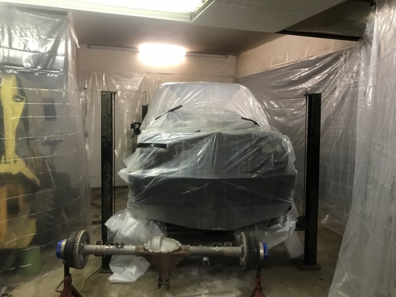

Ready for tomorrow! During my lunch hour I came home and hung the plastic - turning the barn into a paint booth.
Then after work I finished prepping everything and hanging stuff from the ceiling.
25DE71B4-E4C2-4CAB-BF64-9D582DC0BFED.jpeg89CCA3E3-0898-4BC4-B0E0-FA7D859CBFB1.jpeg9F24CCE3-AD90-4A5E-8724-7C8750A34EBF.jpeg94A7947B-E517-4EB4-AC43-4E1C342AD555.jpeg
I’m nervous and excited for tomorrow - it’s going to be a big step forward in the project, but I don’t have a ton of experience painting with a gun so I always worry about screwing something up.

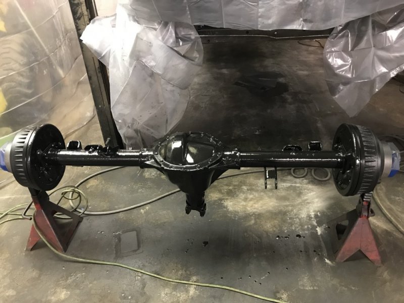

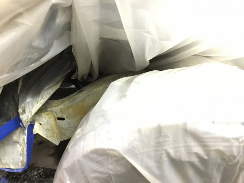

The big day is done. I started before 8am and applied the last coat at 10 pm. 3 coats of Rust Seal and 2 coats of Blacktop on areas that will get exposure to UV rays.

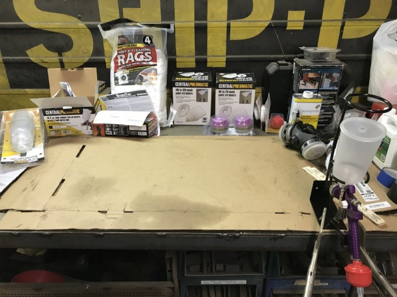

I started with a Harbor Freight HVLP gravity feed gun, but I struggled with this gun for 2 reasons: 1. The 1.4mm nozzle was a little small and it clogged on me a couple times. I finally had to thin the paint 20 percent to get it to flow through the gun. 2. The top paint cup kept me from getting close enough to the floor and into nooks & crannies and I couldn’t paint the whole underside.
So I went back to the store and got a siphon feed gun. This worked a TON better. The 1.7mm nozzle laid a bunch more paint down and I didn’t have to thin the paint which was a nice saver. The bottom cup allowed me to get everywhere I need to as well, which was a huge relief because I was worried that I was going to have to do a lot of hand painting to get everything coated.
I used these paint strainers.

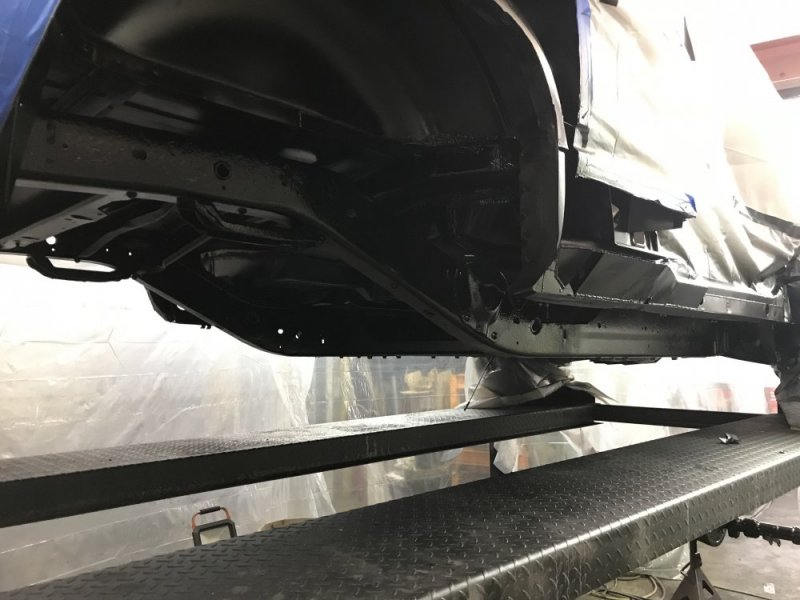

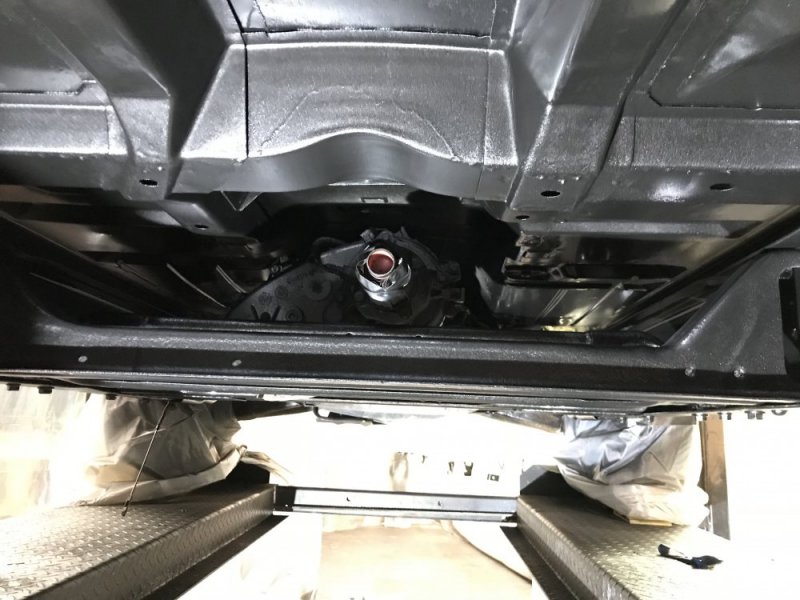

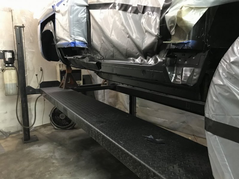

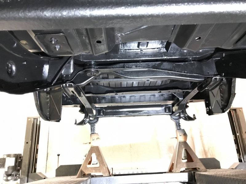

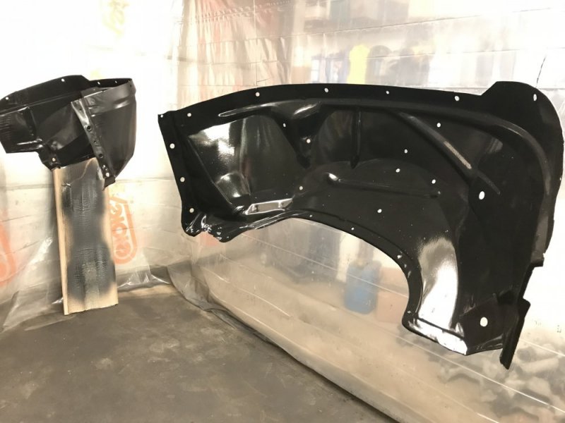

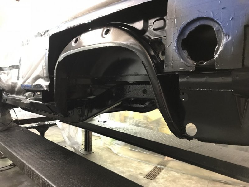

Here are the results. Sure is nice seeing it all black and shiny! I have some runs and drips, which I would of course rather not have, but it is just the underside of the truck and it was tricky for me to make sure all surfaces as well as all of the nooks & crannies got coated. Now I have a nice, solid foundation to build off of. Next up: body repair.
