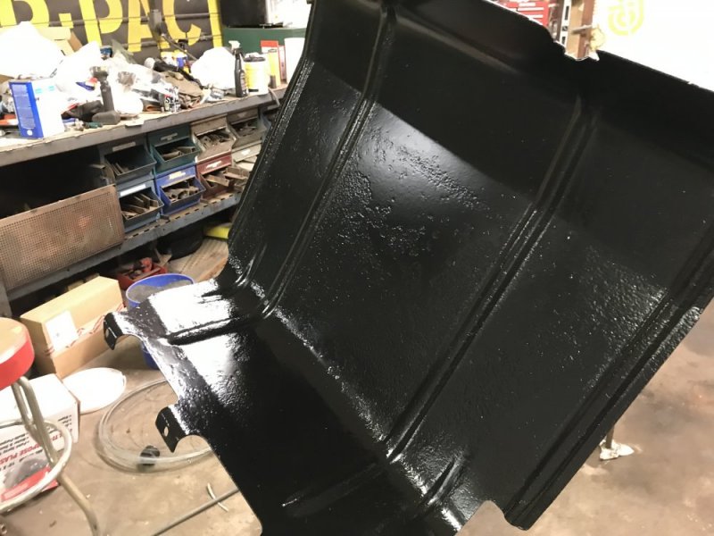

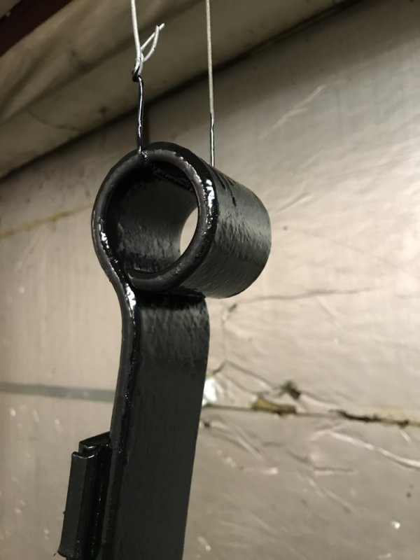

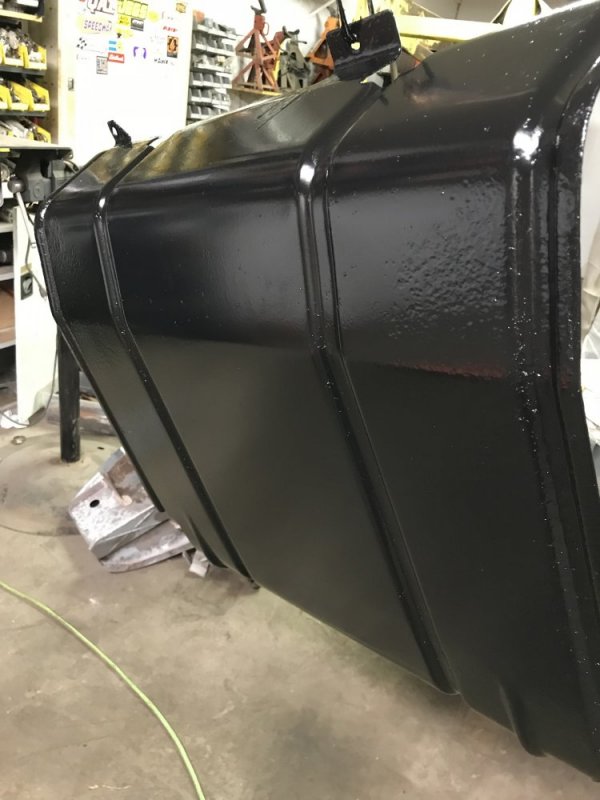

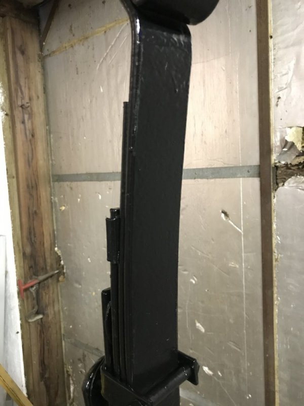

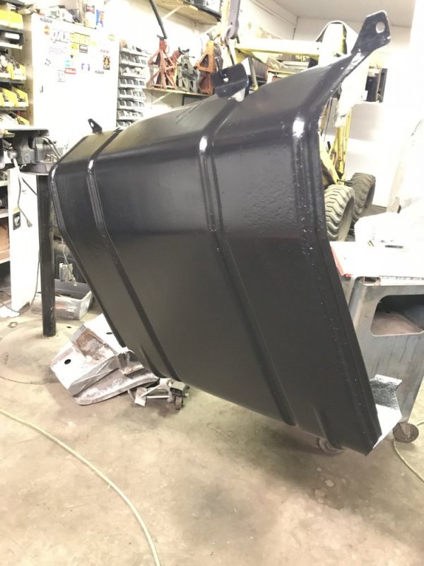

3 coats of Rust Seal are done. It’s a lot shinier than I expected a satin black paint to be. I applied it with a 1/4” nap roller and it flows out nice and smooth.

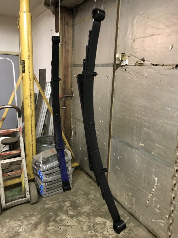

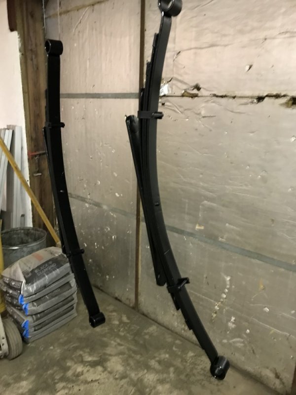

Here are pics of the parts 24 hours after the last coat of paint.
AA96FF59-499E-4A2B-B2DD-DCD0A7E69700.jpegC1169BF9-2AB9-4862-87F0-E6B3F04C5575.jpegF270DB5E-68D2-4F63-9D33-39CF4AE36E99.jpegF49C8792-B167-4B3F-83B9-D2CBC603C483.jpeg
In all they received 3 coats of Rust Seal and 2 coats of Black Top. They’re still a little shinier than I expected for a satin black paint, but it will look nice. I used about 1/2 of the Rust Seal quart and 2/3 of the Black Top pint to paint these parts. I think I’m going to try painting the axle and u-bolts & clamps this coming weekend. I’m going to try spraying those because of all the nooks and crannies I’d have to get paint into on the axle.....doesn’t sound like fun (which would be consistent with this project as a whole - not fun). That will also be good practice for the underside of the truck because I’m going to spray that as well - again due to all the nooks and crannies and also because of the square feet I need to coat.

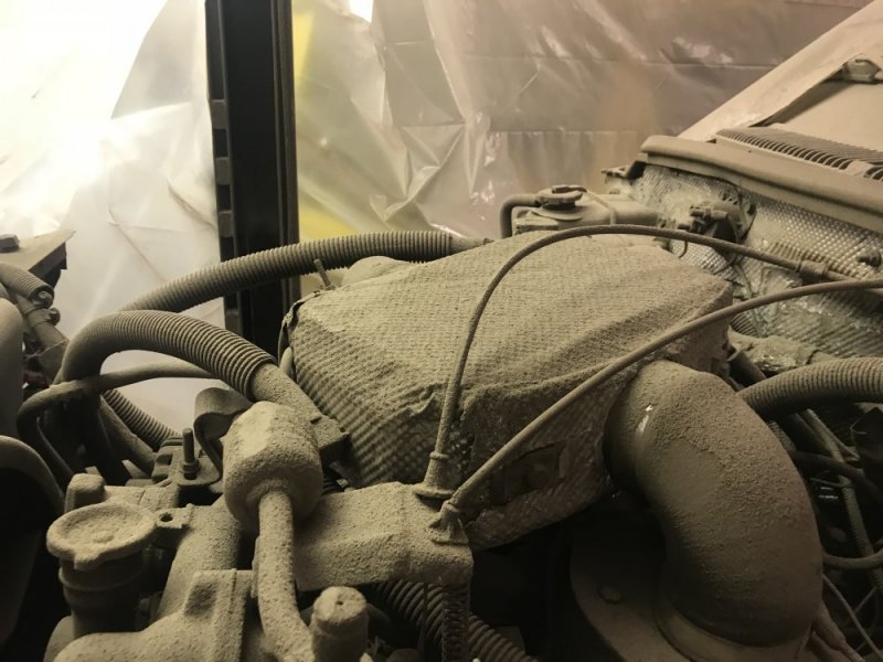

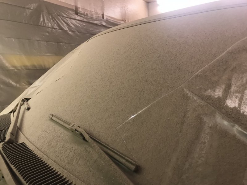

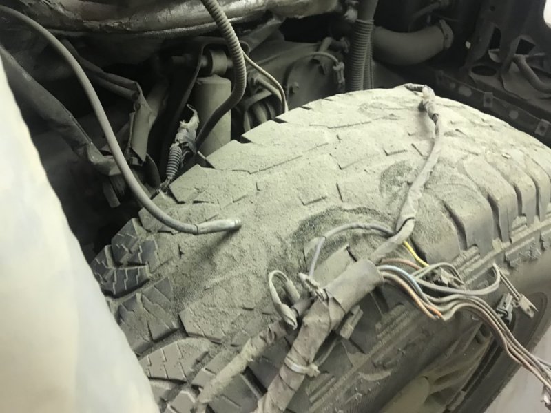

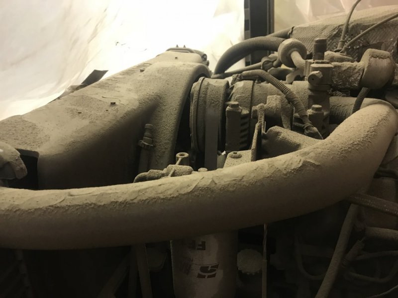

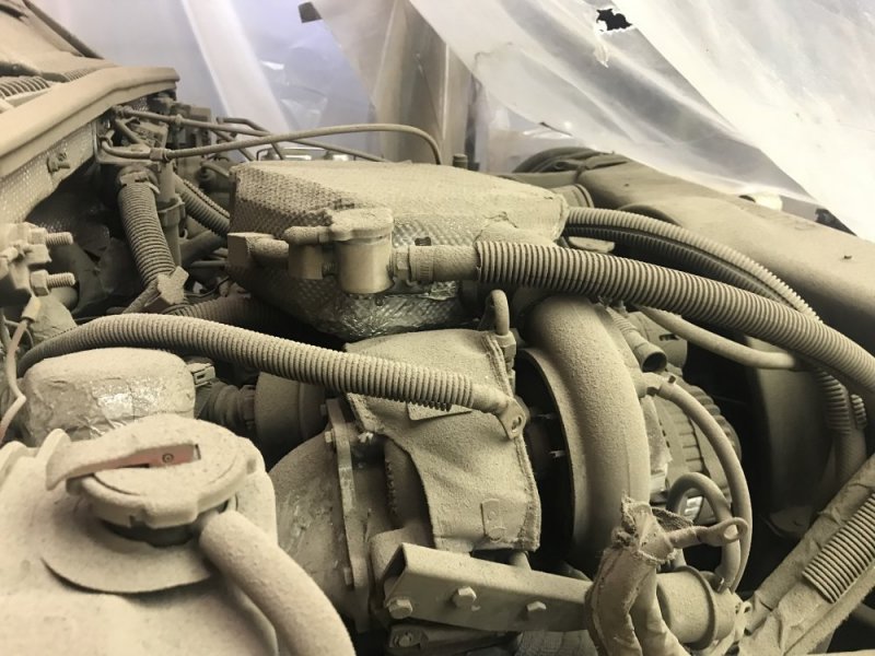

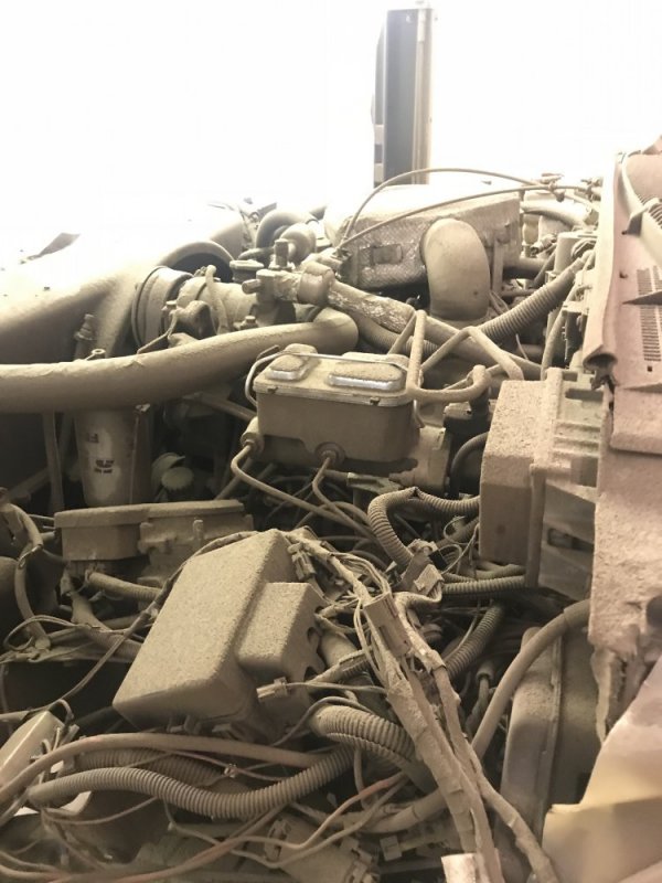

I lowered the Tahoe from standing height on the hoist for the first time after 3 weeks of sandblasting. Holy dust!! Talk about riding dirty. Makes me so glad that I hung the plastic to make the makeshift booth so the whole barn doesn’t look like this.1D7BA99C-D594-445A-8DC4-36D84C810F28.jpegA2E6E08C-985A-4550-A29F-9DC62956BDCF.jpeg9D914A2D-2943-4DBC-A251-812298CCA1C8.jpeg6D229390-A928-4025-B297-982FAD6B220E.jpeg636FD52D-C393-42D1-9FB8-1CA86AC9CBA2.jpeg5B175C9C-FA58-412C-9638-9439ED852B06.jpeg
