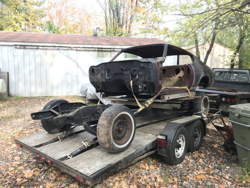

Ha! It’s been in pieces for over 20 years. It was the first vehicle I bought with my own money at 17. It came from Alabama, but had Gulf of Mexico rust....and then 2 Michigan winters didn’t help it. I stripped it down to the frame and that’s how it’s been since. I did have the frame sandblasted at one point and then I painted it with POR15 and put back together as a rolling chassis, but that’s as far as I got. I have a pretty solid AC cab for it and thr rest of the body panels are decent, I just need to do it. I always wanted to do a nasty gas engine for it, but I think I’m going to do a 6.5 instead - if I can build one that puts out more power than the one in the Tahoe and stick it in a truck that weighs 2000 pounds less?? That should be fun! The funny thing is that once I started digging into the Tahoe’s rust I realized that this was a larger metal project than the C10 that I’ve been putting off for years!!!
I have only 1 picture somewhere from when I was driving it. Here’s a pic of when I brought the chassis home from my dad’s friend’s lot....yes that’s a Chevelle body sitting on it....and no that won’t be permanent, it was just a convenient way to store the body.

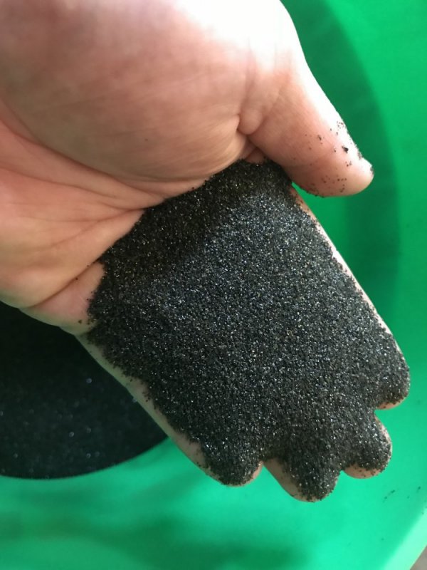

This is what the Black Diamond 3060 looks like.

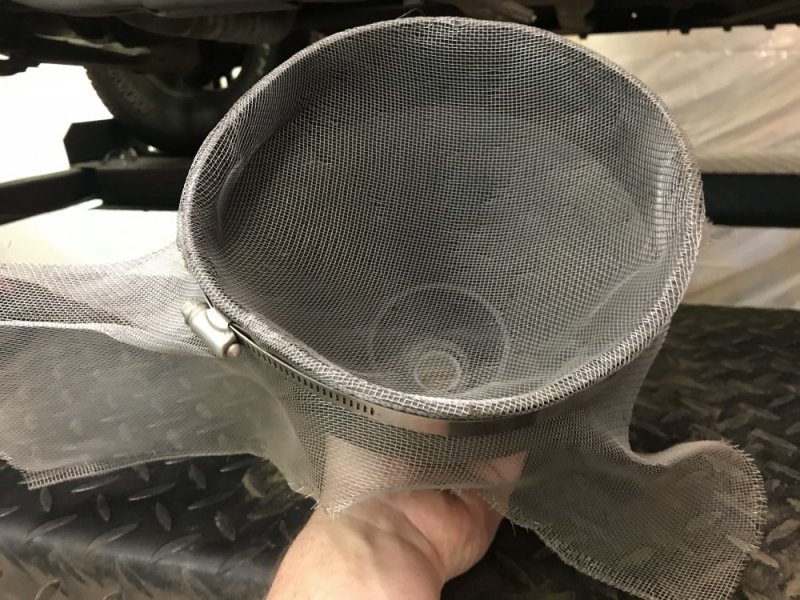

This is the funnel I use to strain junk out when I fill the pot. It’s just a standard funnel with a piece of aluminum window screen draped inside, held in place by 2 large hose clamps.

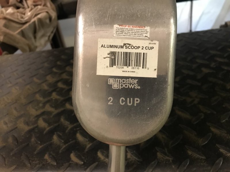

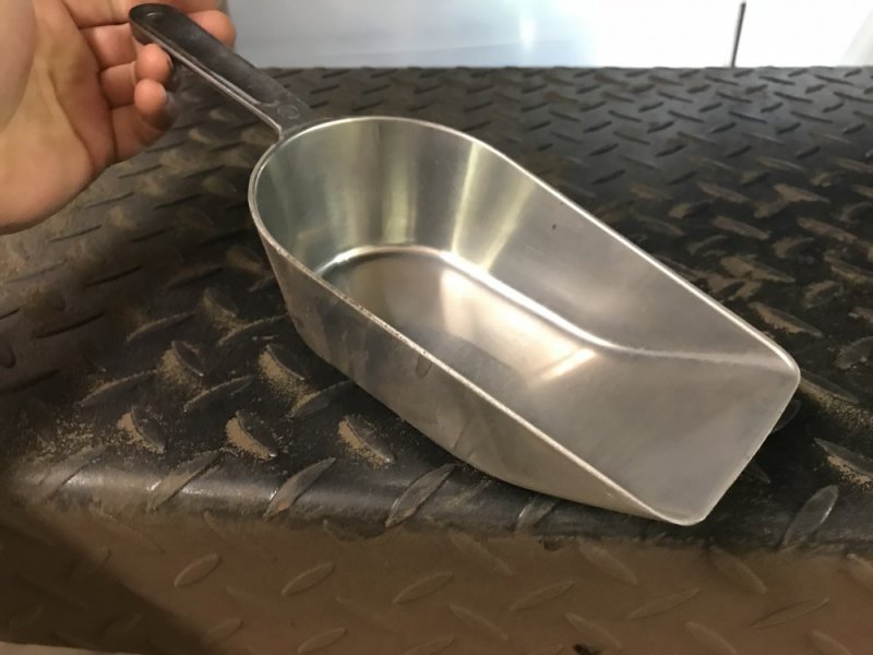

This is the scoop I found that works a ton better than a dust pan. It’s a pet food scoop that I picked up at Menards. Works perfect for scooping up abrasive with it’s flat bottom and sturdy construction.

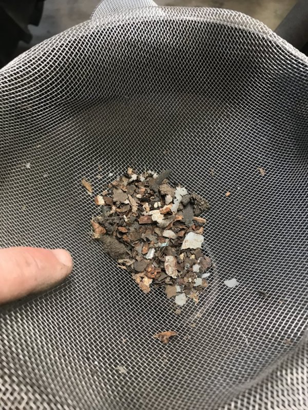

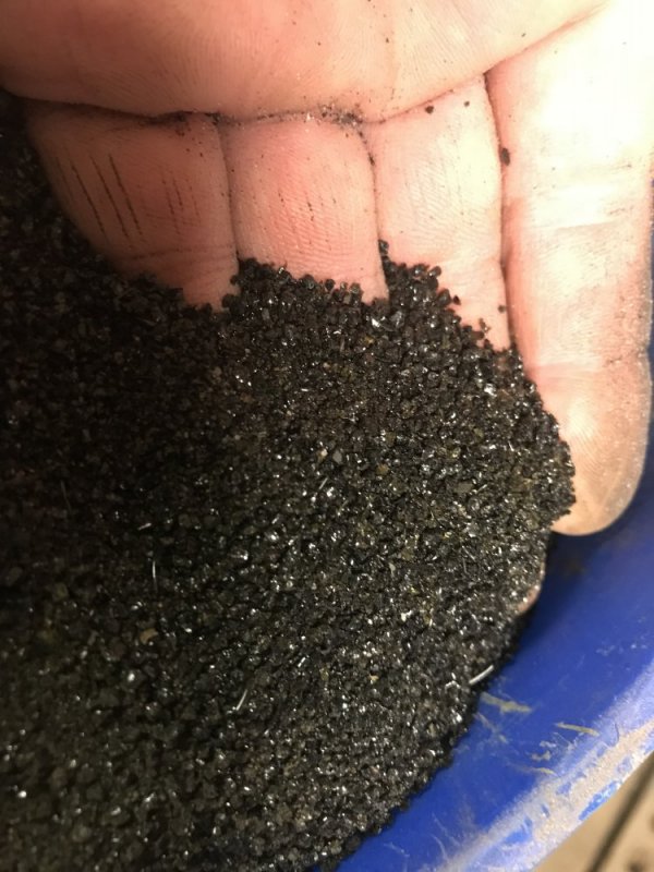

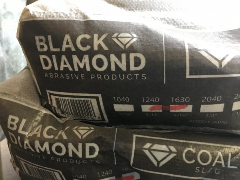

This is the first Black Diamond I tried. After reading their website, I thought this was the stuff I wanted. I waited for TSC to get more in and when they did I bought 400 pounds if it. The first clue that it wasn’t going to be good was when I dumped it in the funnel and it wouldn’t fit through the screen. Well I reasoned that after one pass through the blaster it would be knocked down small enough to fit through so I proceeded to dump it in through an unfiltered funnel. I started blasting and first thing it did was plug the nozzle. So I put a worn out nozzle in the handle and then I was in business again. Then the throttling valve plugged. I got it to unplug a couple times but then it finally plugged for good. So I dumped it out of the pot. I tried running the used stuff through the screen funnel and nope, it still wouldn’t flow. So unless you have a serious sandblasting setup, stay away from that stuff.

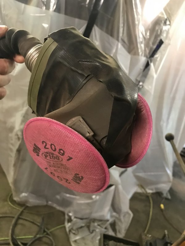

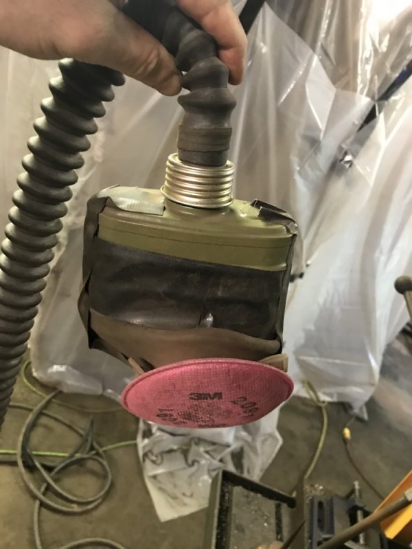

Then here’s a pic of my modified filter assembly. Looks crude but it works and now it’s easily servicable.

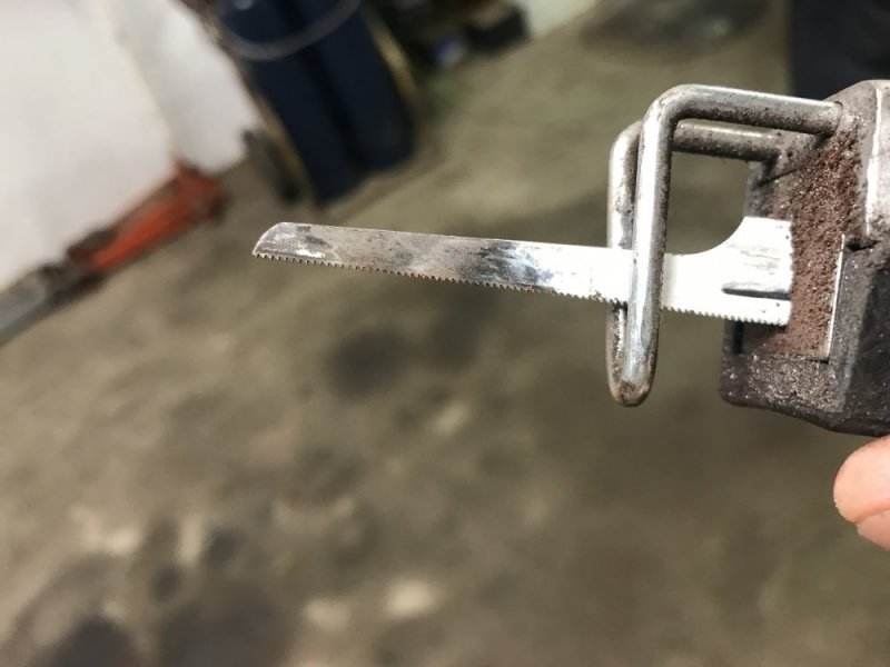

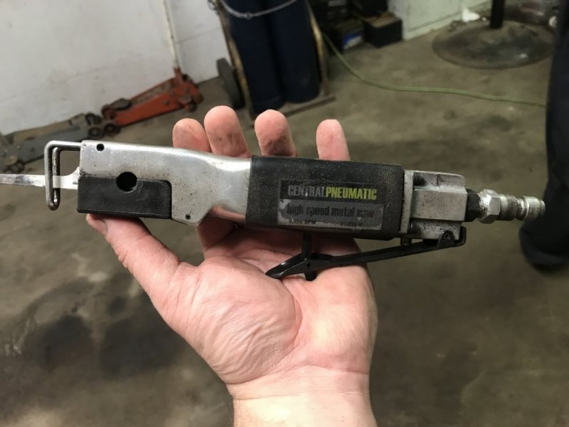

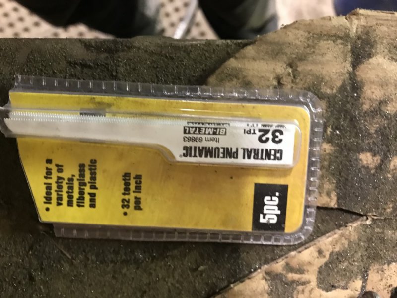

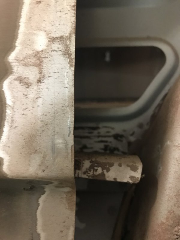

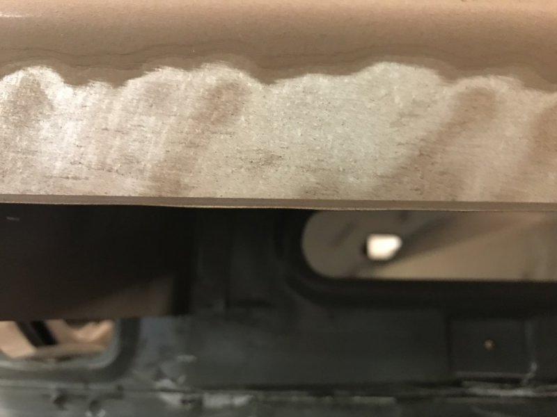

And I thought I’d show what I used to cut most of the sheet metal. I used this before when doing rust repair on another truck and I really like it. It’s light, super maneuverable and it cuts the sheet metal without tearing it and making rough/burred edges. And it’s cheap: $18 at Harbor Freight.

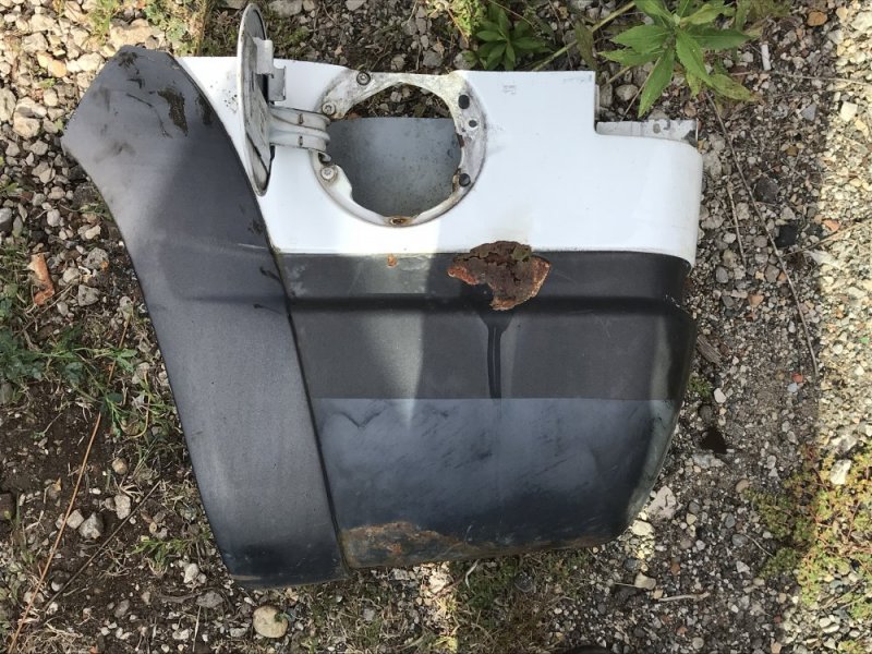

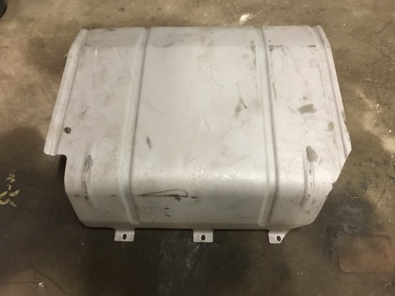

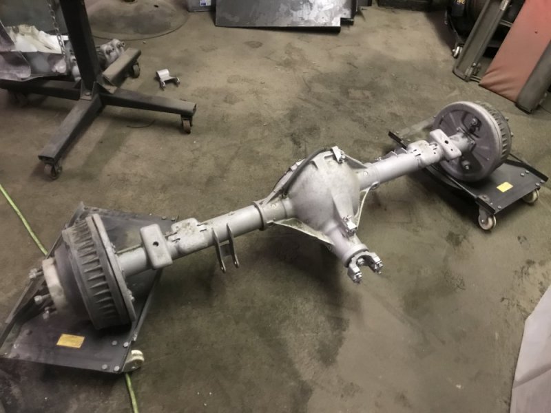

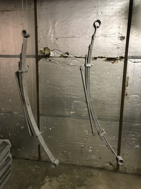

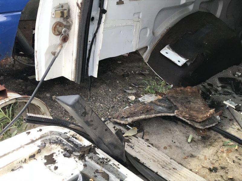

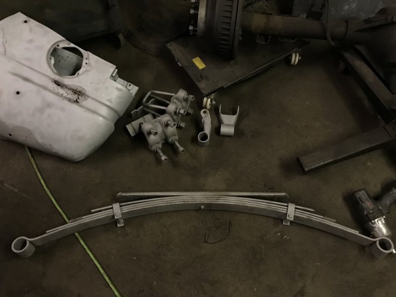

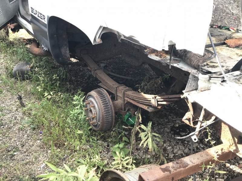

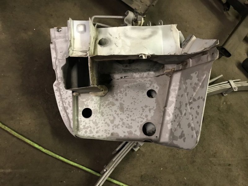

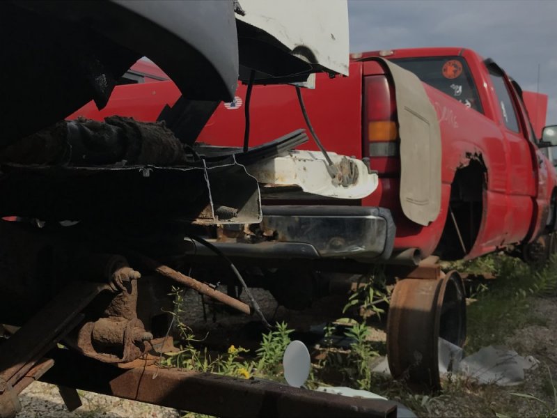

After the junkyard, more sandblasting of course. I pretty much wrapped up the underside of the truck today except for some touch-ups that I need to do. So next up I blasted that body cut I got today so i could see what I had. Then I started blasting suspension parts.
