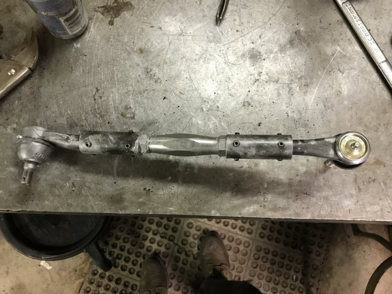

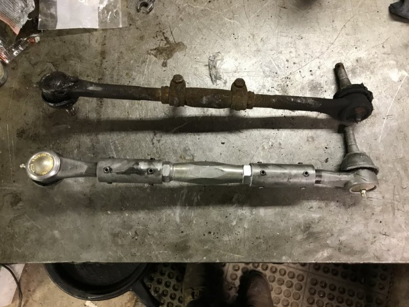

I’m hoping to participate in the local dirt drags next week so I wanted to reinforce my tie rods before I did a bunch of boosted launches in 4 wheel drive. First thing I did was buy some QA1 tie rod sleeves from Speedway Motors a couple months ago.

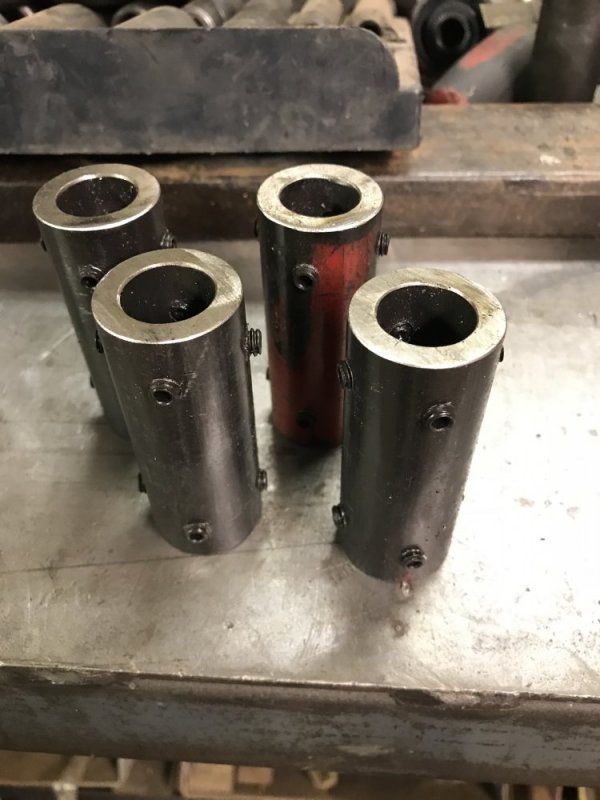

This weekend I made some slip-on sleeves to strengthen the rest of the tie rod ends. I bought a chunk of DOM tubing that was .750 ID with a .250 wall thickness. I cut this into 4, 3” long pieces. Then I drilled and tapped 8, 1/4-20 holes in each piece for set screws. Here’s what the sleeves ended up looking like.

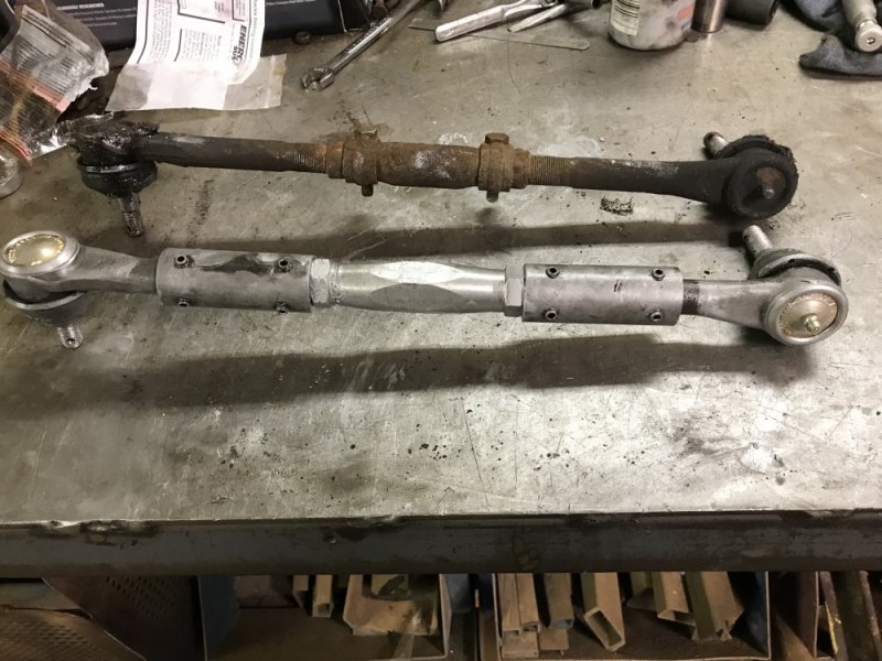

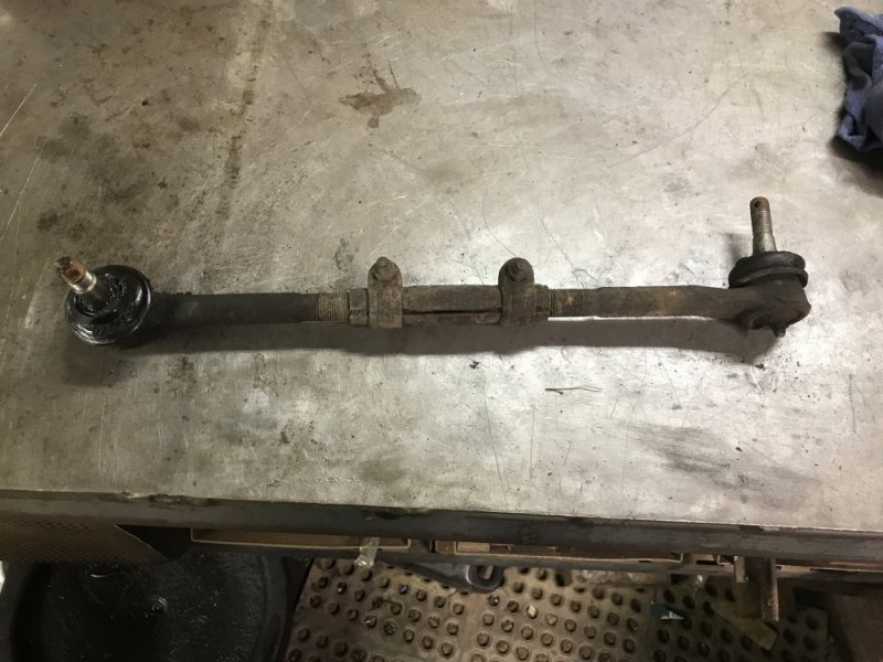

Then it was time to install the bits. Unfortunately, I couldn’t get the QA1 sleeves to thread onto the existing tie rod ends due to rusty threads, so I had to go buy new Moog Problem Solver tie rods. I wish I had planned on that ahead of time because I could have saved a crap ton of money by buying them from Rock Auto instead of O’Reilly....ah well. Hopefully somebody reading this learns from my mistake.

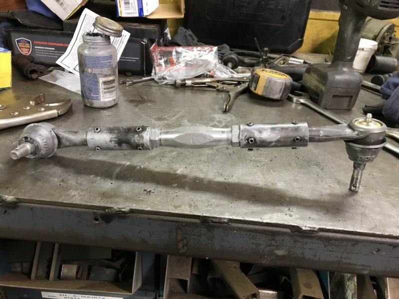

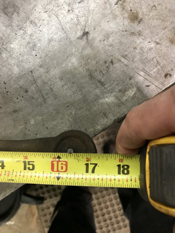

I installed the slip-on sleeves on the ends and then screwed them into the QA1 sleeves. I measured the existing tie rod assemblies and made the new assemblies the same length so as not to throw off my alignment. I could have made the slip-on sleeves a little longer, but I didn’t want to interfere with the adjustability of the tie rods.

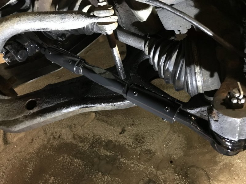

I tightened everything after installing them on the truck. Then I cleaned them off and threw some black paint on them.
Time to do some boosted launches in 4 wheel drive!!

Thanks. The CV boot just looks funky in the pic because the wheel was cramped all the way to the left and there’s a shadow on it.
I believe he was focused on the wet black being a leak, when it was really just your painting.
I like the tie rod aduster sleeves. Not sure what the other fabbed sleeves do?
Ah, I get it. Yeah, I didn’t mask anything off when spraying the paint on - I figured any paint on the Michigan rust was a good thing, ha.
The theory with the fabbed sleeves was to add some girth to the tie rods so they would be less likely to bend. Is that really a thing to be concerned with? I don’t know, but I’d rather not find out the hard way.
