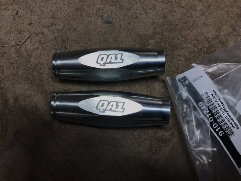

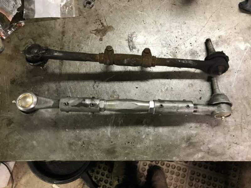

I’m hoping to participate in the local dirt drags next week so I wanted to reinforce my tie rods before I did a bunch of boosted launches in 4 wheel drive. First thing I did was buy some QA1 tie rod sleeves from Speedway Motors a couple months ago.

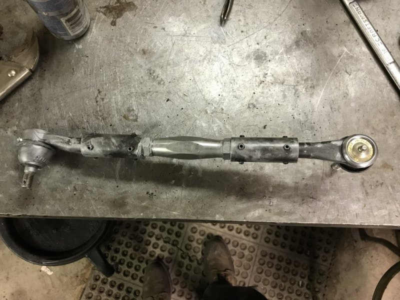

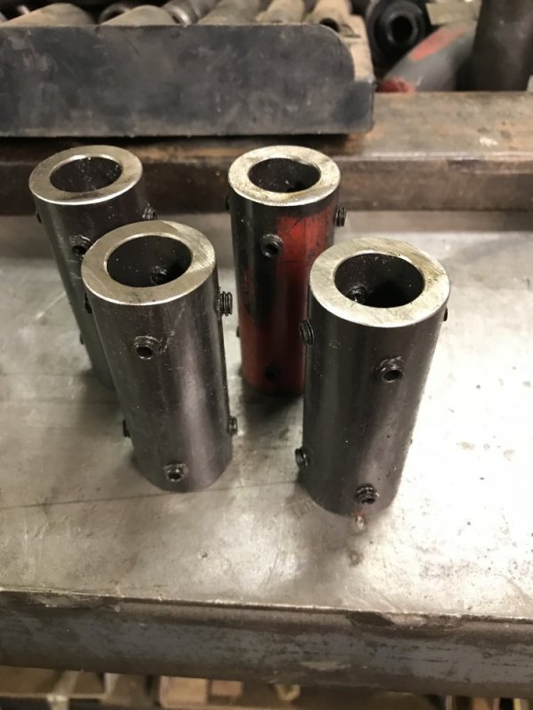

This weekend I made some slip-on sleeves to strengthen the rest of the tie rod ends. I bought a chunk of DOM tubing that was .750 ID with a .250 wall thickness. I cut this into 4, 3” long pieces. Then I drilled and tapped 8, 1/4-20 holes in each piece for set screws. Here’s what the sleeves ended up looking like.
Then it was time to install the bits. Unfortunately, I couldn’t get the QA1 sleeves to thread onto the existing tie rod ends due to rusty threads, so I had to go buy new Moog Problem Solver tie rods. I wish I had planned on that ahead of time because I could have saved a crap ton of money by buying them from Rock Auto instead of O’Reilly....ah well. Hopefully somebody reading this learns from my mistake.

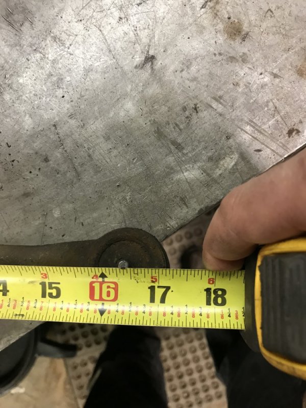

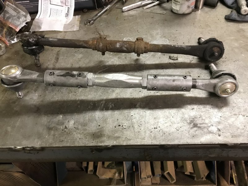

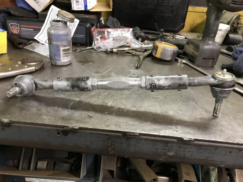

I installed the slip-on sleeves on the ends and then screwed them into the QA1 sleeves. I measured the existing tie rod assemblies and made the new assemblies the same length so as not to throw off my alignment. I could have made the slip-on sleeves a little longer, but I didn’t want to interfere with the adjustability of the tie rods.

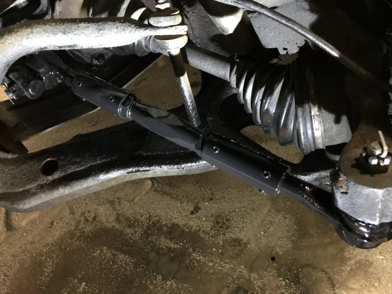

I tightened everything after installing them on the truck. Then I cleaned them off and threw some black paint on them.

Thanks. The CV boot just looks funky in the pic because the wheel was cramped all the way to the left and there’s a shadow on it.
I believe he was focused on the wet black being a leak, when it was really just your painting.
I like the tie rod aduster sleeves. Not sure what the other fabbed sleeves do?
Ah, I get it. Yeah, I didn’t mask anything off when spraying the paint on - I figured any paint on the Michigan rust was a good thing, ha.
The theory with the fabbed sleeves was to add some girth to the tie rods so they would be less likely to bend. Is that really a thing to be concerned with? I don’t know, but I’d rather not find out the hard way.
