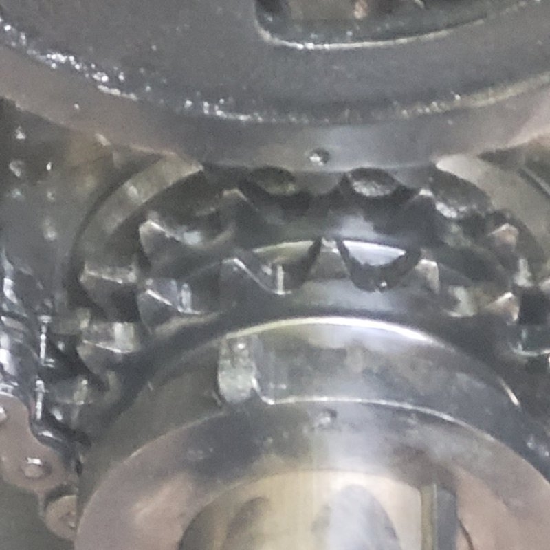

My son texted me this picture after using tho old gear and chain to set timing. He then took it off the time keeper. Unfortunately he didn't take a picture with the chain. He thinks he installed the time keeper off by 1 tooth originally. How does it look?
By looking at it closely it appears the dots are aligned in that picture but still could be mis-stamped.

So knowing that the crank and camshaft are in the correct factory position, you can slide off the chain set and slide on the gear drive. Do it without rotating the cam or crankshaft and you’ll know it is factory timed.
That's what I figured. My son is coming back to do it tomorrow. He did say that it felt like one of the gears onthe time keeper was a tight fit when he pulled it off. We'll see when he puts it back on.
