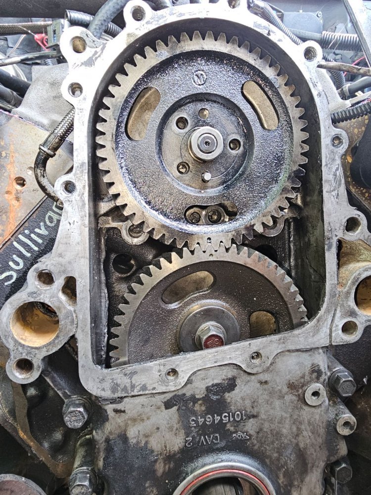

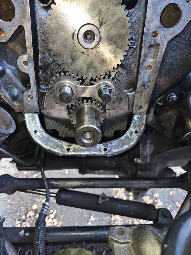

Rebuild about done
Just got her back together. I can tell the difference. It runs like it should. the TDCO is at .18. The desired timing is still around 8.5. When we do a tdc learn or time set it drops to 3-3.5 when they are on but when we turn them off that jump back to 8.5 range. Any thoughts?

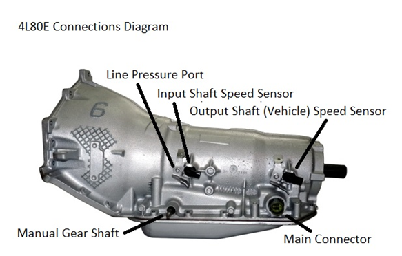

There is one code that won't clear. It is for the transmission speed sensor. I think it may not have been plugged back in after replacing the flexplate. Anyone know where it is located?
Speed sensors are on the side of the trans. one about center of the body, the other towards the rear. I can't recall which side they are on though.

All transmissions have 2 in place. All 2wd only use those two. The front is the input and the rear is the output.
4wd:
Some, not all transfer cases will use one.
Some, not all of the use only the input in the front and the transfer case as the output. For these ones the rear transmission location is only there to plug the hole. On these I have never seen a harness to the rear transmission one.
There are some applications that the signal is required from all 3 locations.
I have no clue which is which on these - just something I stumbled across over the years.
Found 2 identicle tss's on the trans and a different larger diameter one on the transfer case. One of the transmission ones had wires connected and the tc as well. I thought they were the same. I need to get the tc sensor now.
