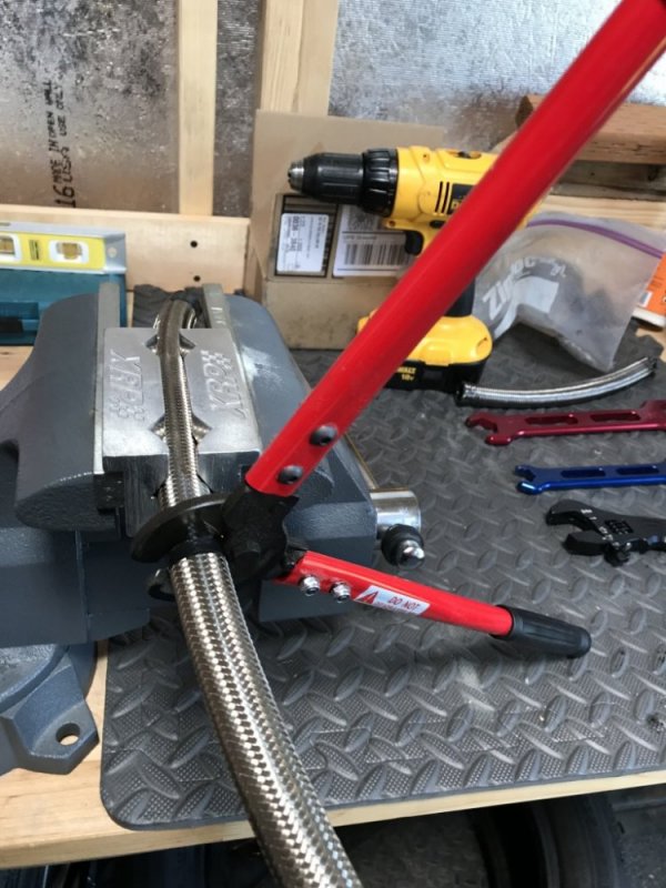

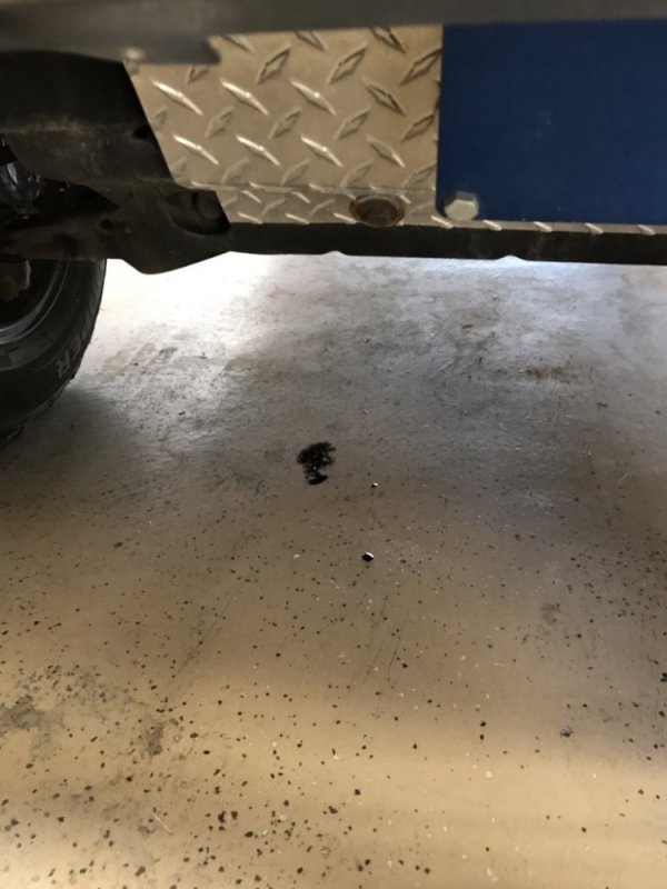

I got some practice at building lines today because the Turbo Oil Return line is piddling too.

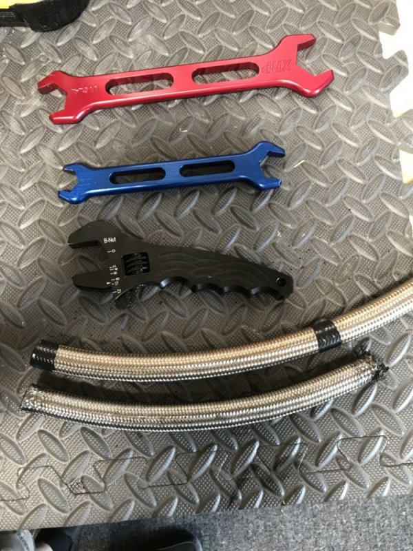

I've been hoping it was only a matter of tightening things up but, nope, no such luck. I've been cleaning the floor and attempting to figure out what's the real issue for a few days but, no avail while still in the truck. Since I consider oil higher priority vs. a slight fuel weep, I addressed the issue today between sanding and priming the step bar mounts...another story of no priority other than something time consuming: Scrap, brush, sand, grind, prime, paint, visit chiropractor to get rid of back knots...rinse and repeat.

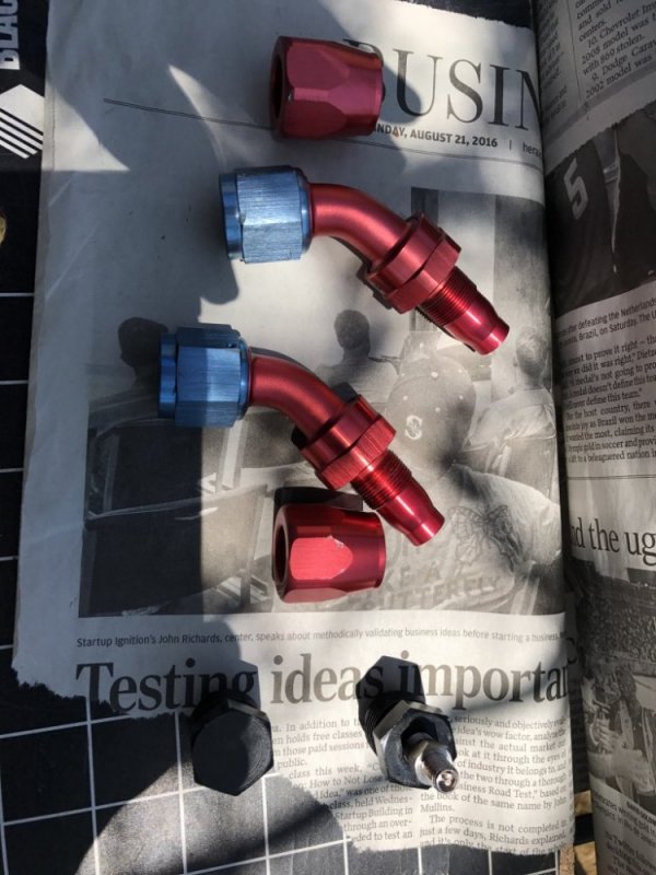

Anyway, I took the old line out and screwed in the pressure test caps (Kit from Summit that's proved invaluable). I aired up the line and dunked it in a bucket of water. One worries about braided steel lines rubbing on unprotected rubber lines so I was surprised to find that the leak was in the middle of the line. The line depressurized almost as fast as I could air it up.
Pulled and cleaned the fittings off the damaged line. They seemed functional and safe to re-use (test caps are the black objects below the fittings)

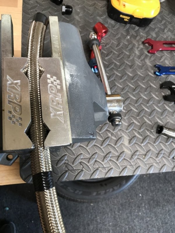

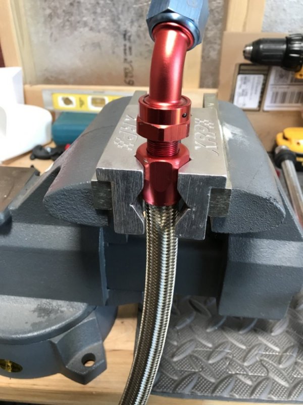

Measure off the new line against the old one and shorten things up a bit. Insert into the aluminum protectors for the bench vice and then cut using another line specific tool (although it creates a slight issue that needs to be addressed later). A single wrap of electrical tape through which one makes the cut prevents the fresh cut braids coming apart / fraying and making assembly a frustrating and bloody endeavour.

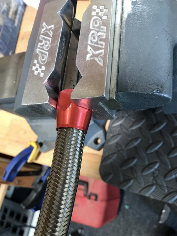

20170703-Oil Return Line-2.jpg 20170703-Oil Return Line-3.jpg 20170703-Oil Return Line-4.jpg
Using the vice to hold the fitting's base secure while inserting the line.

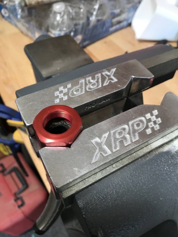

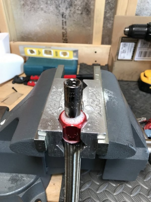

I use a 9mm deep socket to flare out the rubber that gets squished during the cutting (the drawback I noted earlier) along with a soap and water solution to assist in final assembly.

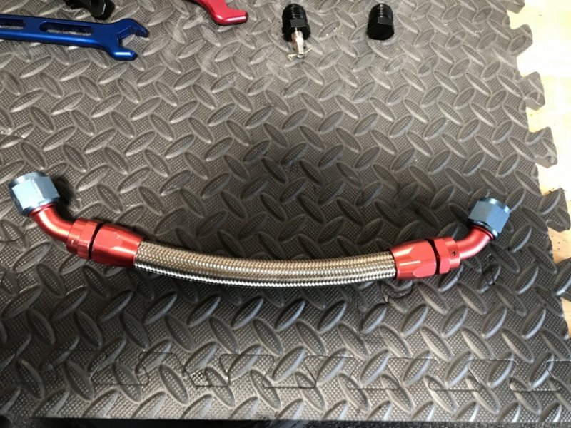

Screw in the fitting to complete the job and tighten.
Rinse and repeat for the other end.
I retested the completed line even though I was sure things were fine (not the first time I've done these things) and was glad I did because one end was leaking pretty badly so I redid things on that end and whatever I missed the first time I got right on the re-test.
Completed, the anodized fittings took a little bit of a beating because of my haste.
