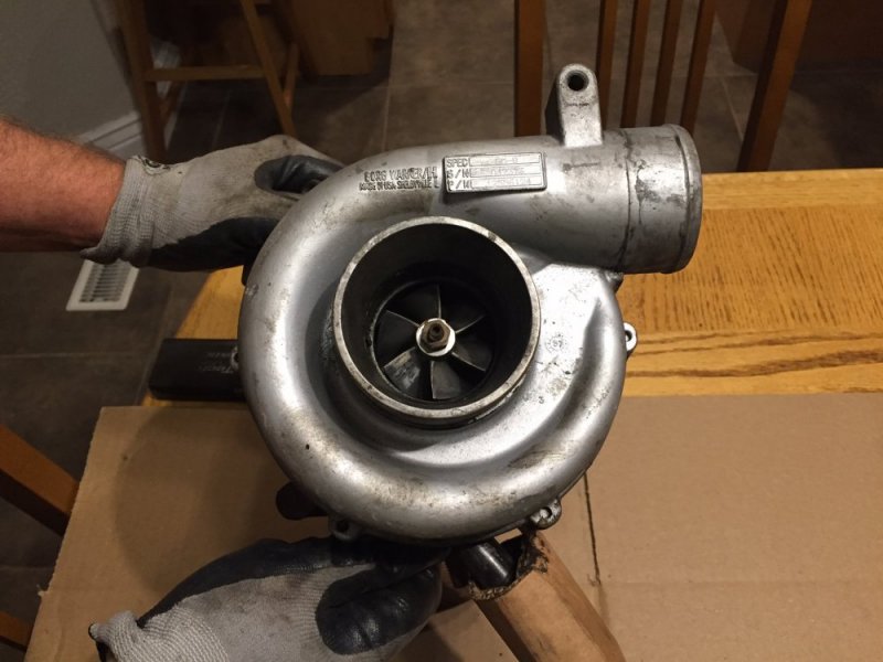

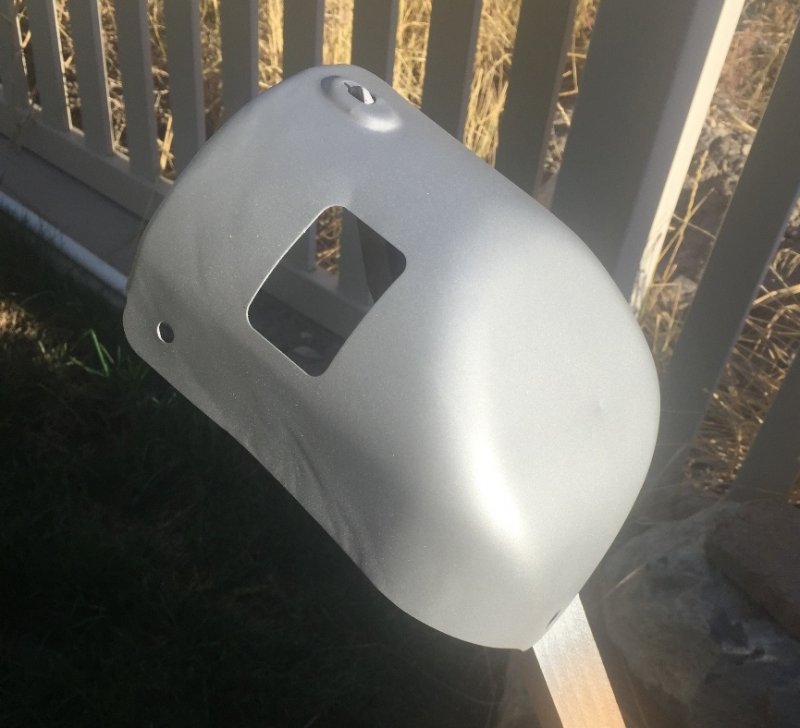

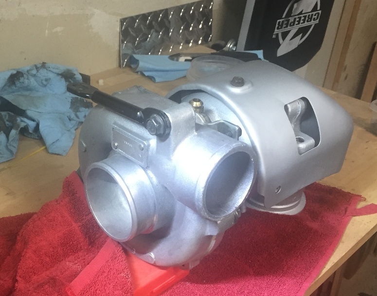

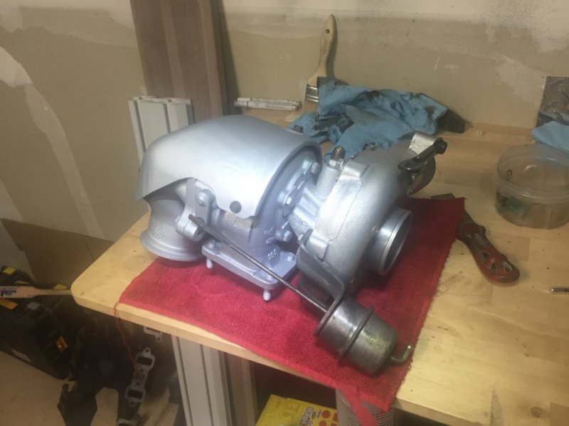

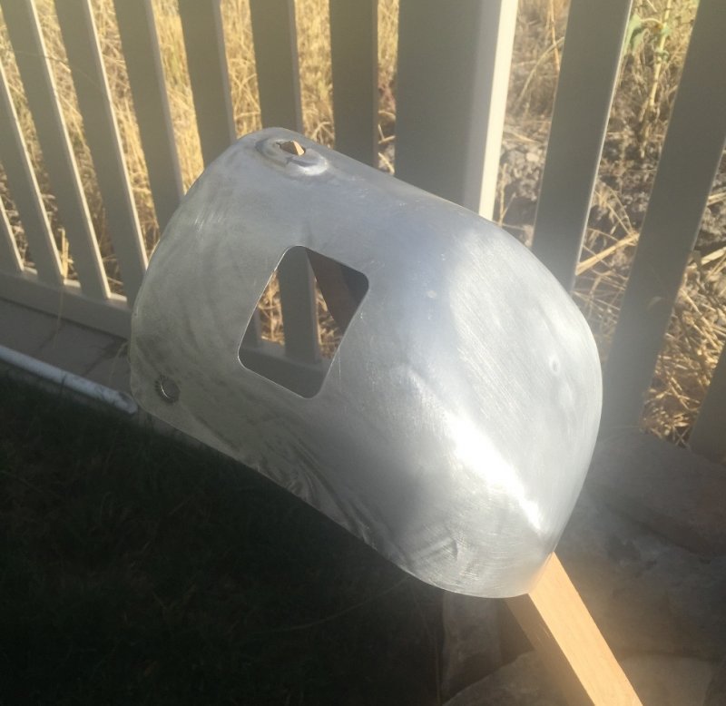

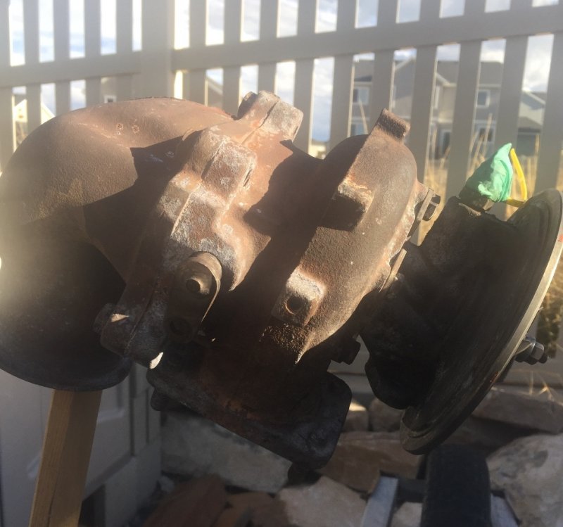

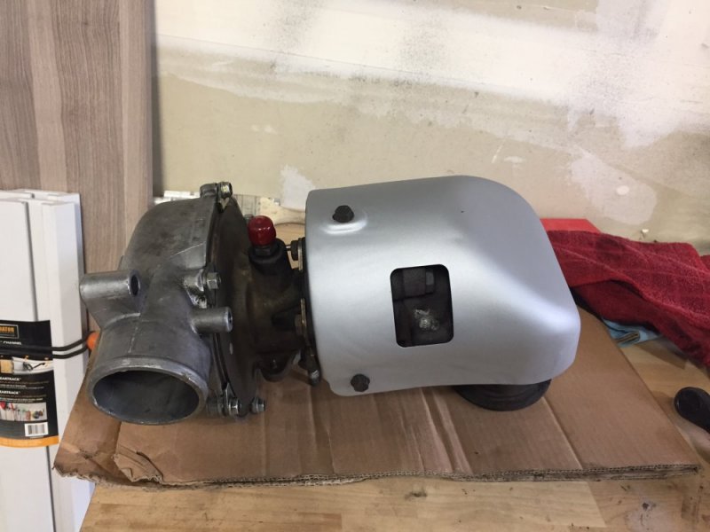

As I'm not interested in running on the salt flats or making great speed anyway, I've decided to try a GM-5 turbo on the motor again and see what it does for boost at lower RPMs. So, I went and got out one that was given to me by...I can't remember. It was greasy and rusty etc. but it spins well and there's no shaft play to speak of. It doesn't have a turbo master but I have one for the GM-5/8 'for just such an emergency' and, since I'm thinking of getting experimenty again I ordered the 'built to our specifications "Hurricane 7 GM8 Center Section"' from Heath (fits the GM5).
So, taking it from dirty, oily & grease encrusted lump of HAZMAT with cleaning and scraping to looking better...001.JPG 003.JPG 002.JPG

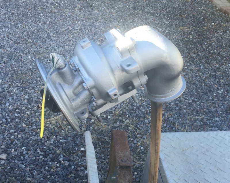

Then add some header paint so it will look good for a week or two...
And, Presto!

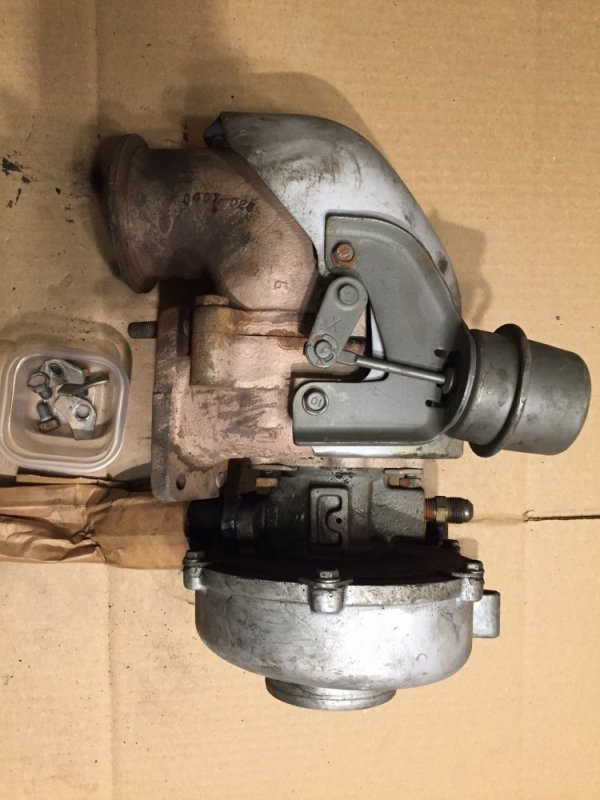

Except, I found the old Vacuum Waste Gate set up under the bubble wrap when cleaning up. No, I'm not planning on using the vacuum WG but, anyone care to guess what issues I'm facing with my plan using and upgrading this turbo are going to be (besides a very slight bend on one of the impeller blades and needing to get another short 10mm bolt for the heat shield)?

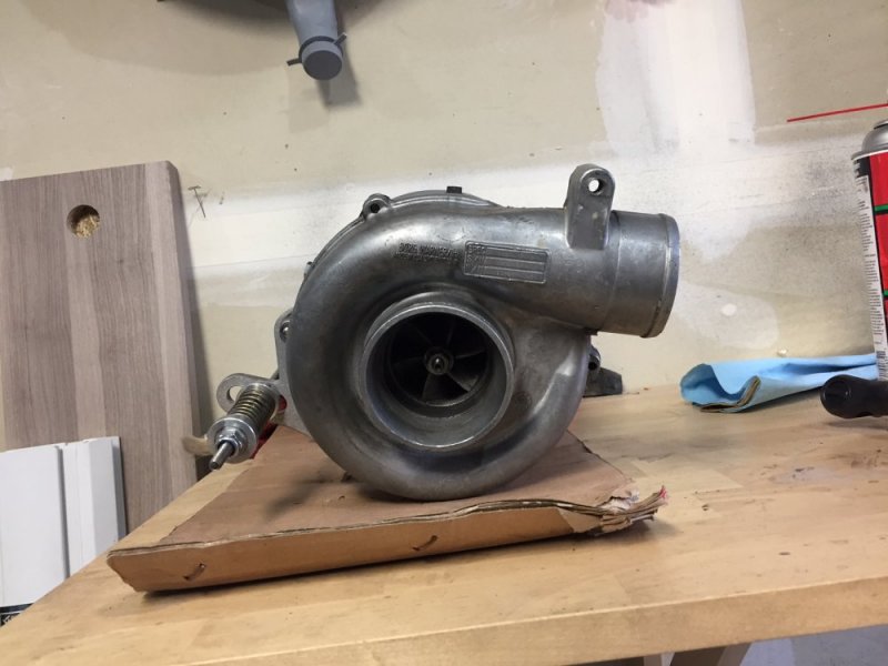

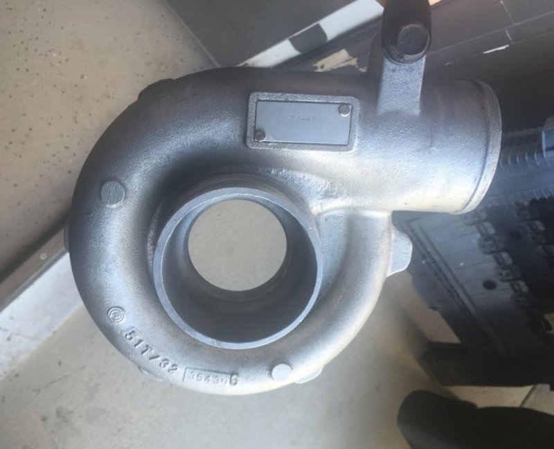

Back from another trip to Texas. Two turbo's waiting for me when I got home yesterday. I needed either a GM-5 or 8 to put the new center section into since the GM-4 isn't going to work with the one I ordered. I'd seen a GM-8 on e-bay and in desperation ordered it. Then, AK came through for me right after I'd pushed 'buy now' and sent me a GM-5 to use in case the GM-8 was complete trash. I was in a bit of a rush with more trips coming up on the 23rd only, I don't need to be in a rush because as it turns out, another Heath innovation is on back order (Bill was on a road trip and Joe failed to mention that detail). So I unboxed the GM-8 and it has at least 1/8" off axis shaft play on both the compessor and turbine sides. The back center section came off with out hardly a hitch and the housing looks great. The compressor housing is good too. For a destroyed turbo, it was amazingly clean.
Then I unboxed AK's GM-5 and its in great shape, tight shaft w/o any play. Spins great...excellent unit. No need to use it to upgrade the new center section too (when it comes in) so I'll do some test runs with it as well. I spent a little time on the heat shield only as the rest of it was already pretty clean and installed a Turbo Master I've had on the shelf for whenever the day came that I ran a waste gated turbo again.
