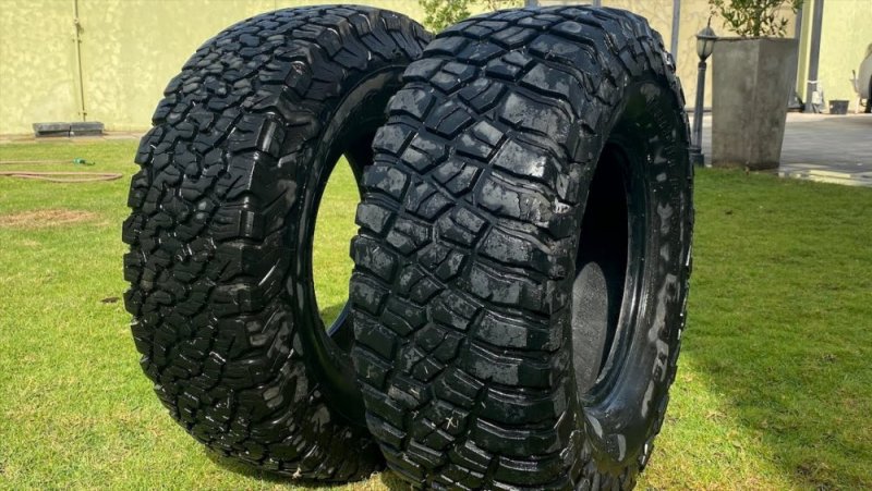

Mud Terrain is big lugs with lots of void, very noisy on pavement. All-Terrain is civilized on the road, with very good off-road manners on dirt, in mud, snow and sand. A lot of the winners of the first ten or so DieselPower annual Diesel Challenges (which included sled pulling, drag racing, mpg competition, maneuvering with a trailer, etc) where competitors could only use one set of tires throughout all the competitions, were won on a set of BFG All-Terrains.
No doubt and they are a damn good all around tire

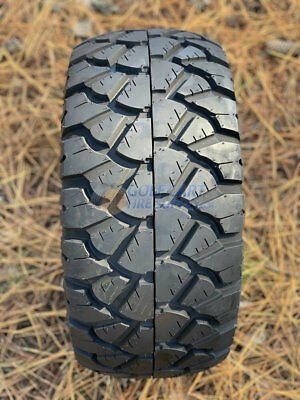

I just haven't seen anything quite like it in a 23x10.5x12 size. I'd be ok with a 22x10.5x12 but they are normally different widths than 10.5

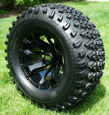

Our v twin swapped Club Car DS rides on these:
They are definitely hummers and I may be able to get these used for cheap as he wants to upside to 25's. Personally I have yet to get a tire on a golf cart louder than the gas engine running it yet.

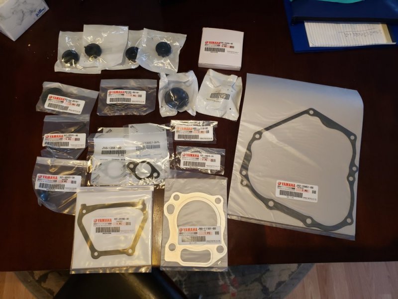

Still waiting for all of my engine parts. Purchase date was the 16th. Parts were stuck in a lot for 2 days in GA till the 18th. Should have been 2-6 day shipping. So much for that. I really hate the partnership when UPS and USPS deliver packages together. So delayed and tracking is absolute garbage. So much for motor work during this week off! I expected a delay for the Holidays but not this much.....

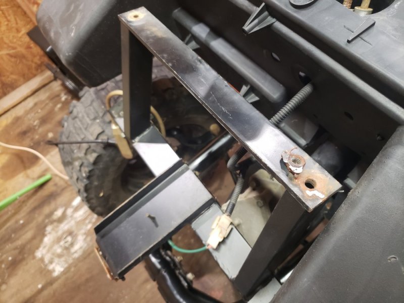

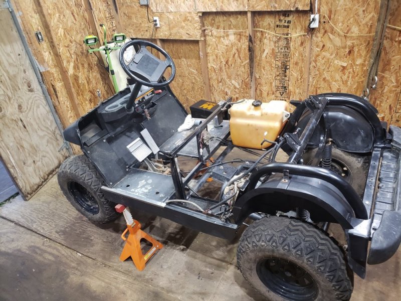

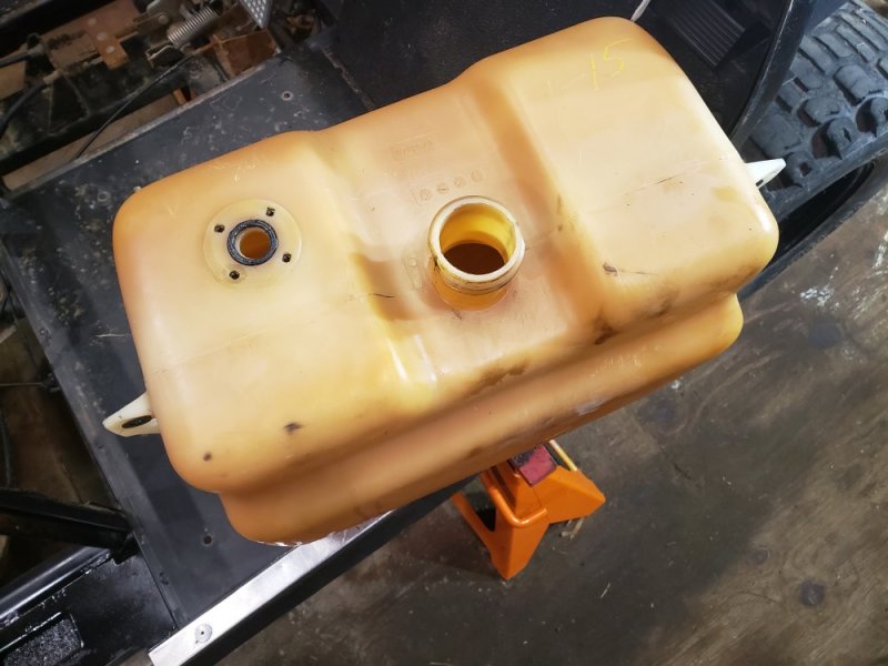

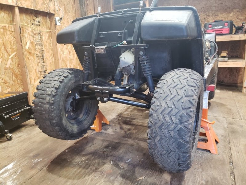

Continuing on with assembly. Got the old fuel drained and tank cleaned the best I could through 2 small ports. Temporary junk tires are on as the stock 8 inch rims no longer fit with the front a-arms. Also ground off the booger welds from the front roof support. I will drill it and helicoil to the correct size again.
Apple cider vinegar will clean that tank quite nicely. Shake it from time to time. Give it about four or five days, drain the tank, vinegar back into the jugs, strain it with a piece of scotch brite in a funnel.
Rins the tank with hot hot water, see how it looks, if needed, dump the vinegar back into the tank and give it another four or five days. Repeat the rinse process. By the end of the second round, the tank should look near as new inside.
