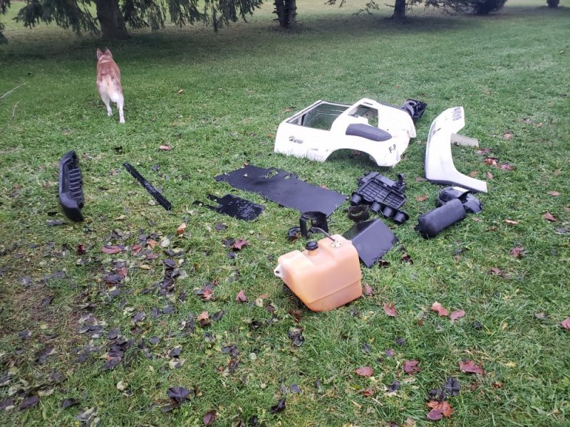

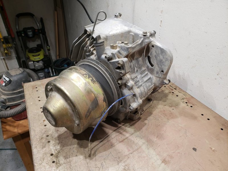

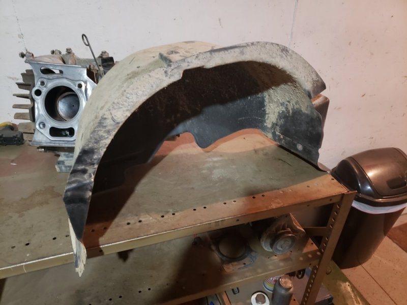

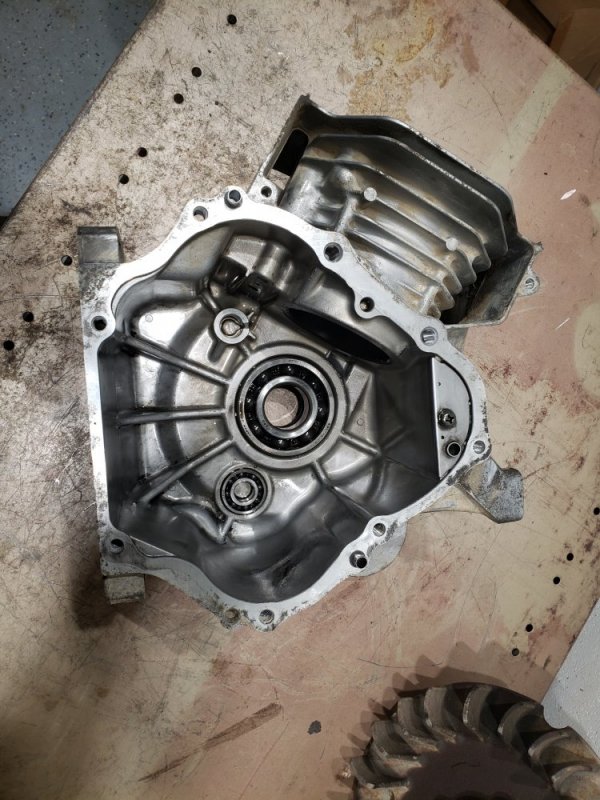

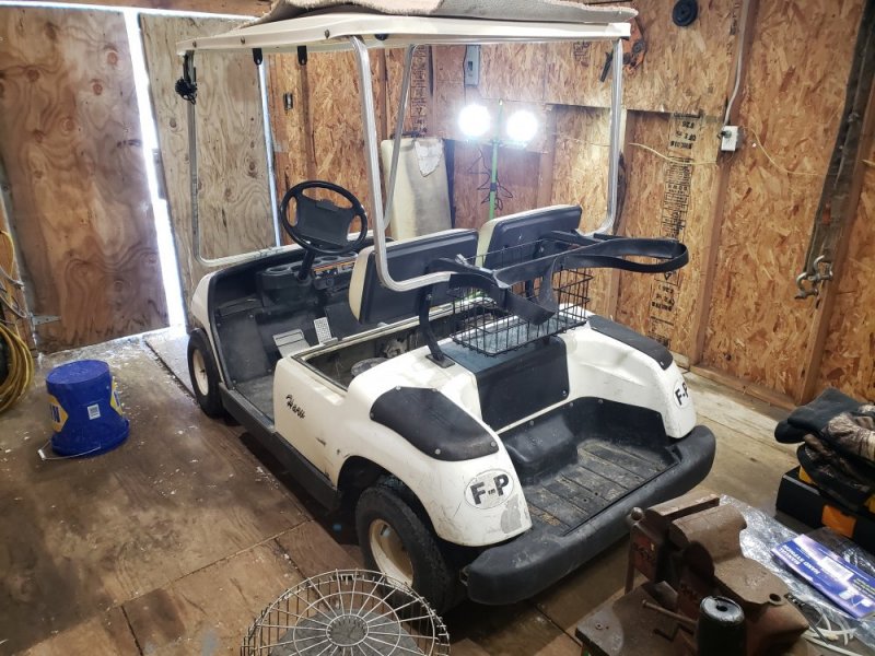

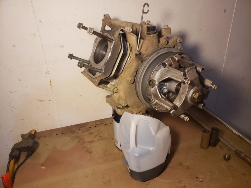

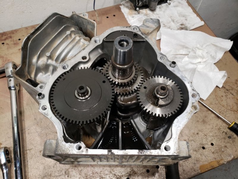

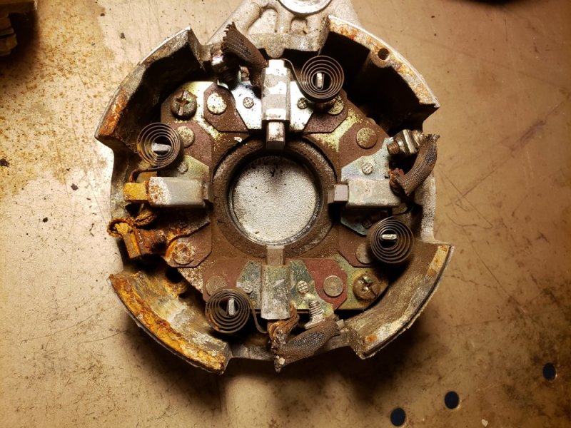

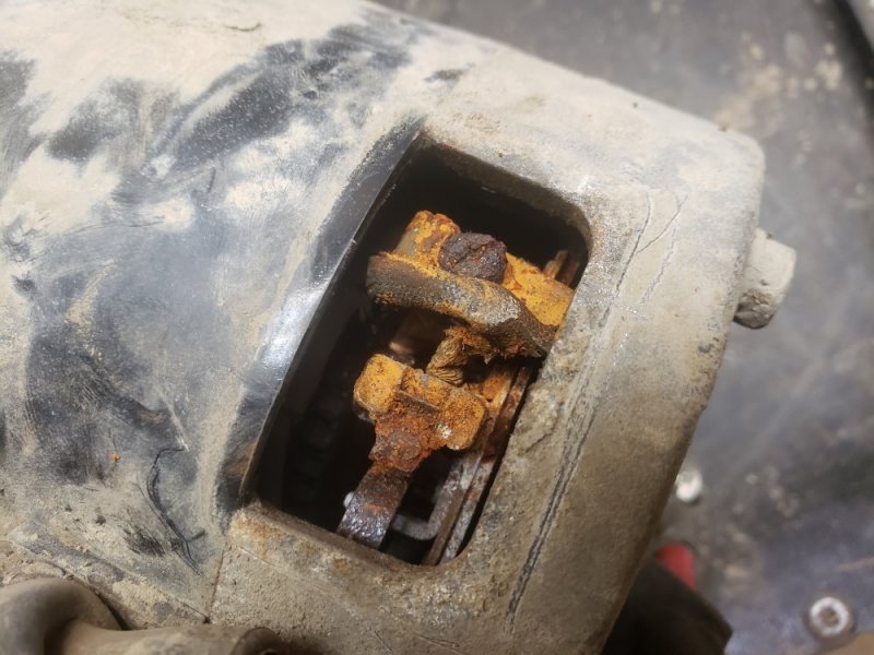

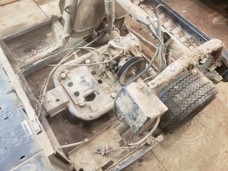

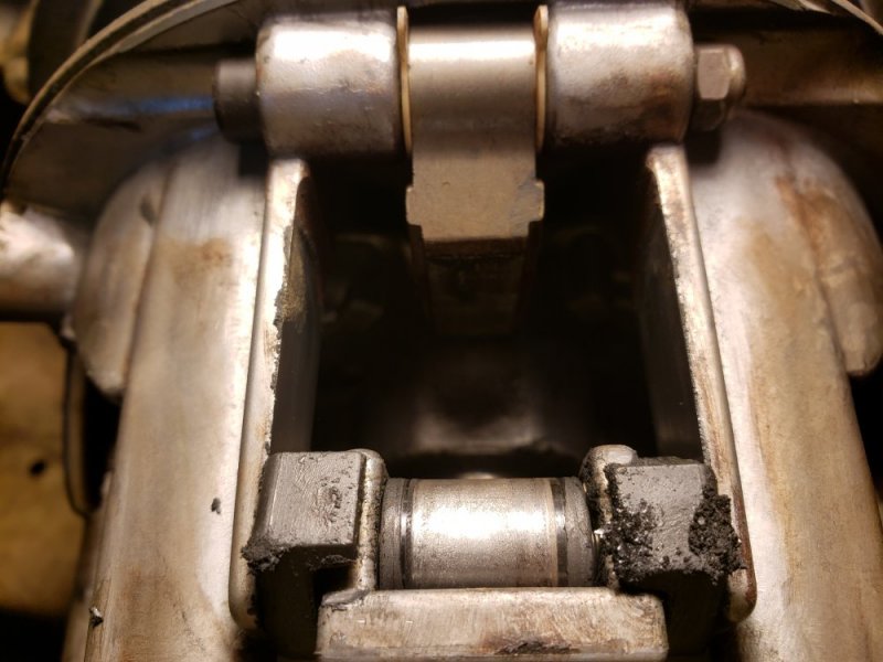

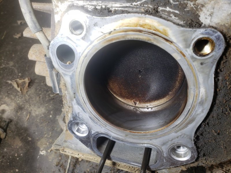

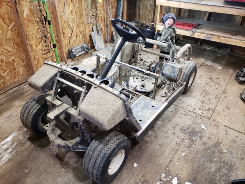

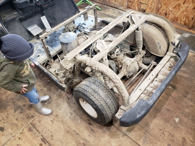

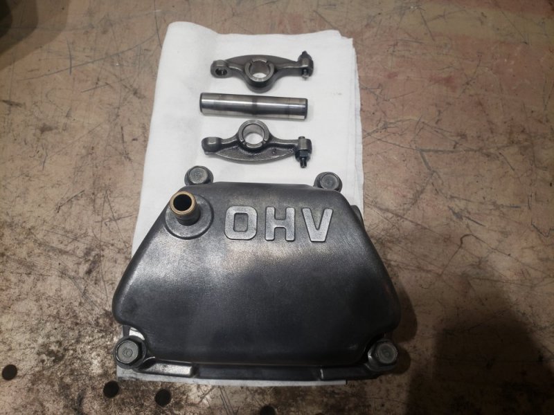

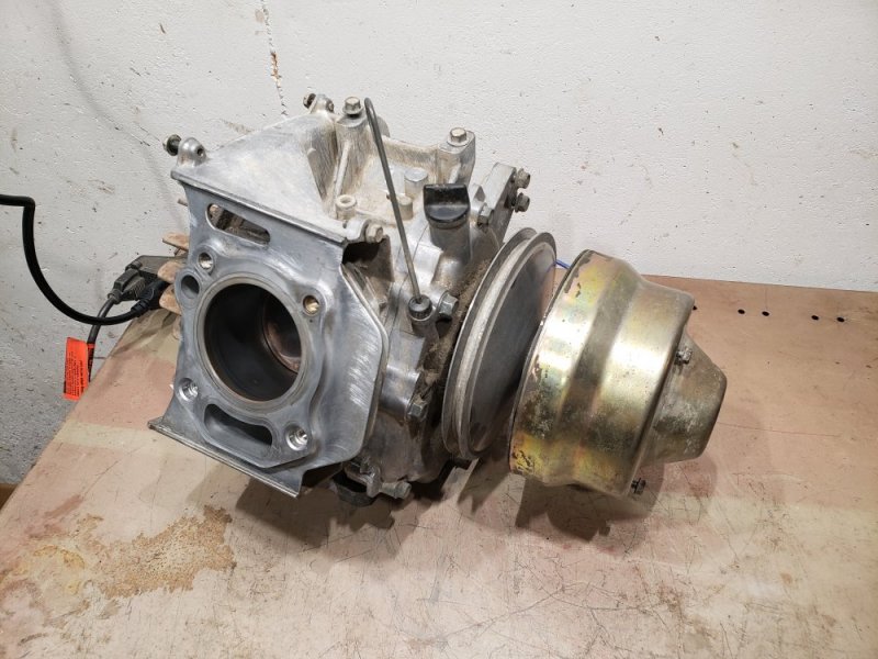

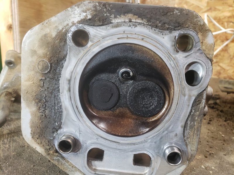

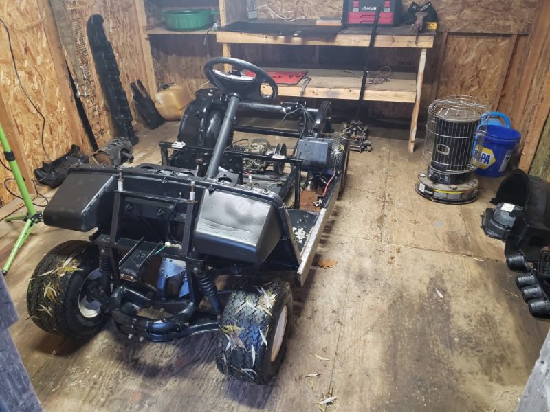

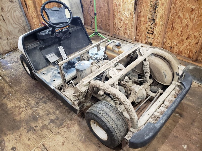

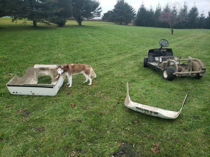

We have been avid campers for the past 2 years now at a local site about 15 minutes from our house. Several other family members have carts up there from stock (89 EZ Go Marathon) to not (02 Club Car 670 swapped). We have so many people at camp that we really needed another cart. I ended up picking up a 97 Yamaha G16A that has been used in the cornfields prior to my procurement. Hope to get it running for now and do a health check. Lift, tires and a back seat in the short term and then maybe an engine swap down the road.

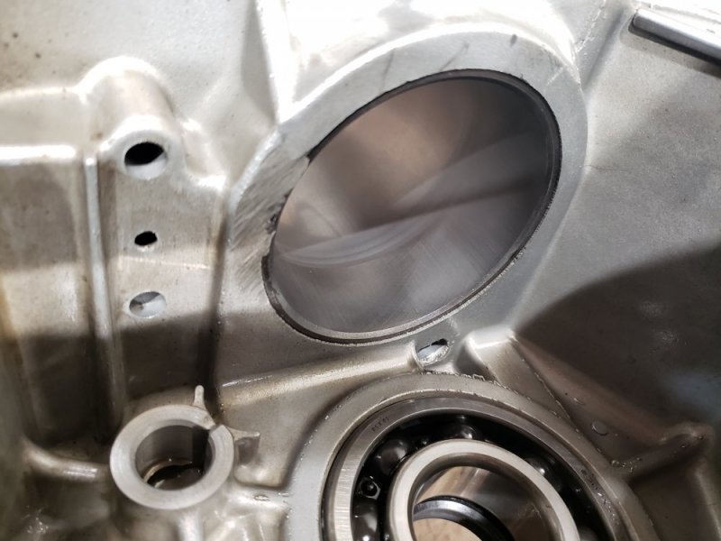

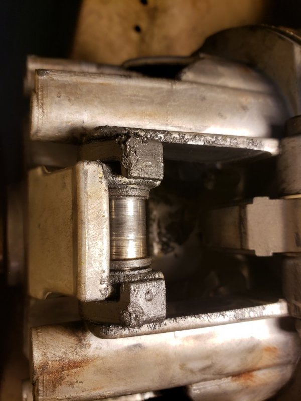

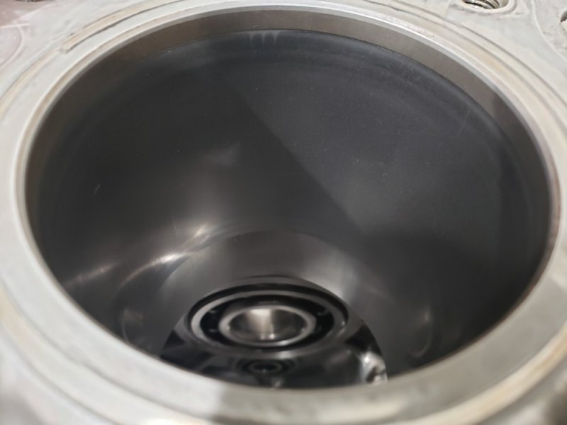

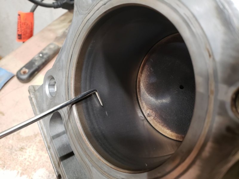

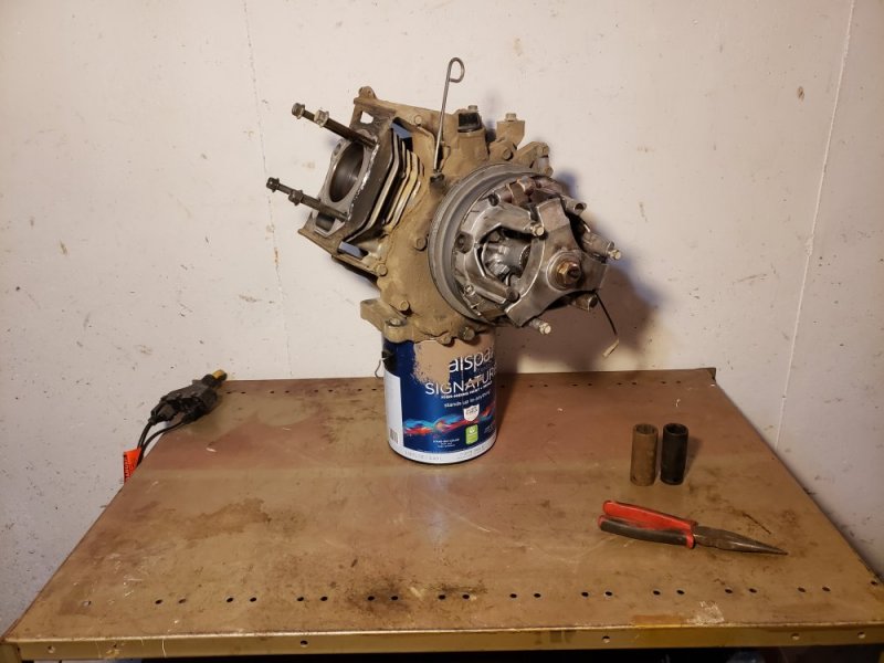

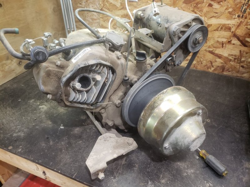

Compression test was informative, 125 PSI max. This engine is a mosquito fogger. Lets get into it!

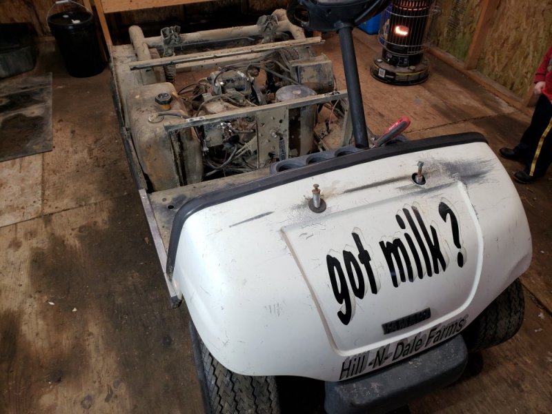

Nice pics! The kids seem to like the sticker as well, my daughter goes Moo when she sees it! Story behind this cart is that it was originally owned by a local farmer who used it as his farm cart. I remember this thing as I drove by on the school bus. Fast forward and it was sold to a friend of mine where I purchased it a month or so ago. The original owner of this cart actually just passed away a week ago.

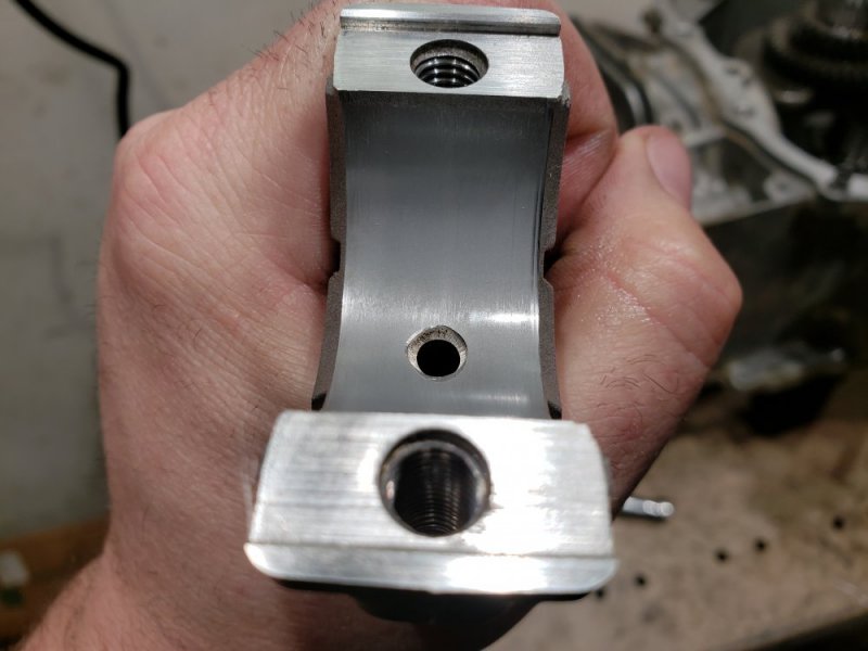

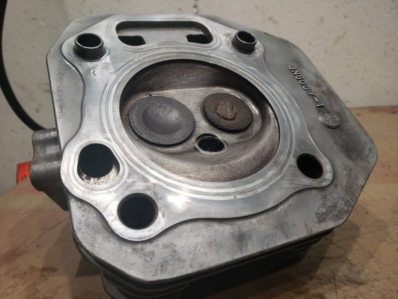

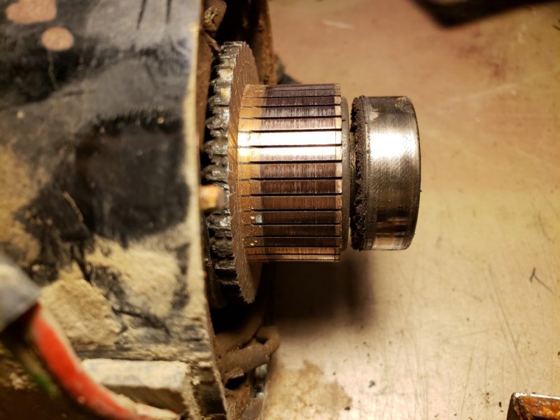

That looks like oil build up. It’s usually worse on exhaust valves because it cooks on the hottest place.
This is where doing a wmi or just the spray bottle version of it helps before tearing down an engine makes clean up time less.
Yes after you gap your piston rings, you can send one off to total seal for gapless. Just remember on gas engine you do the top ring.
