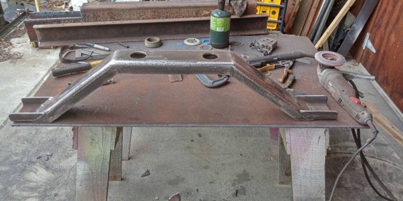

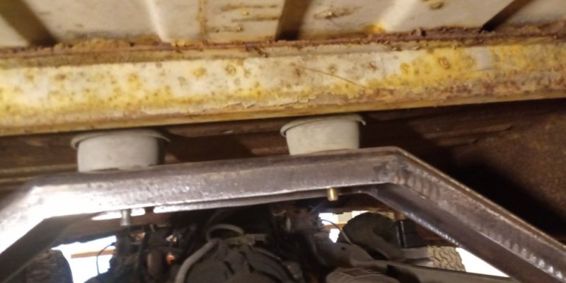

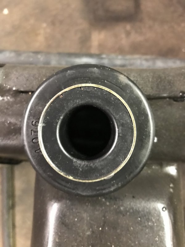

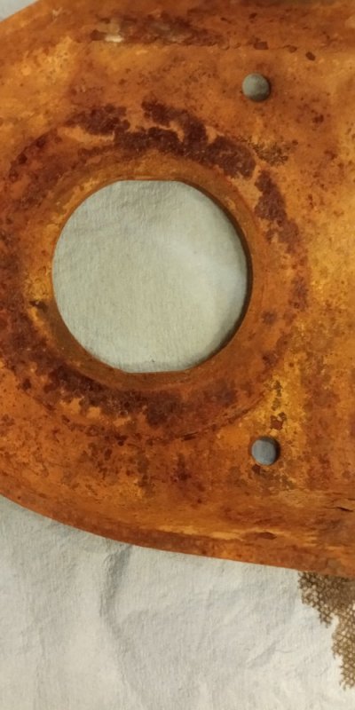

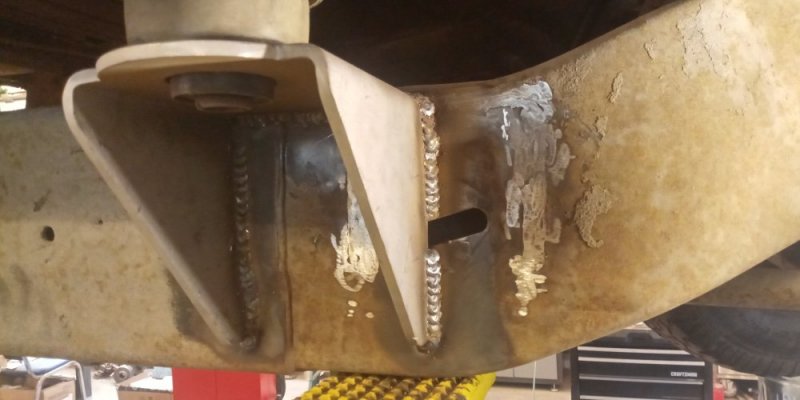

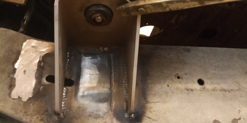

Nice work.

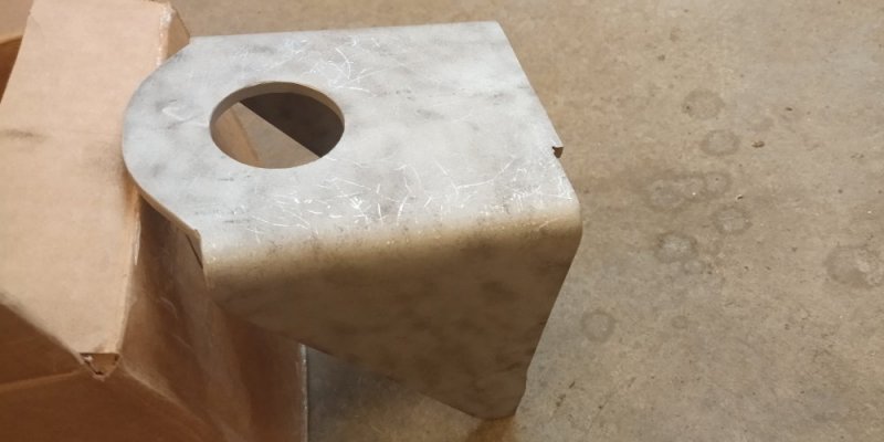

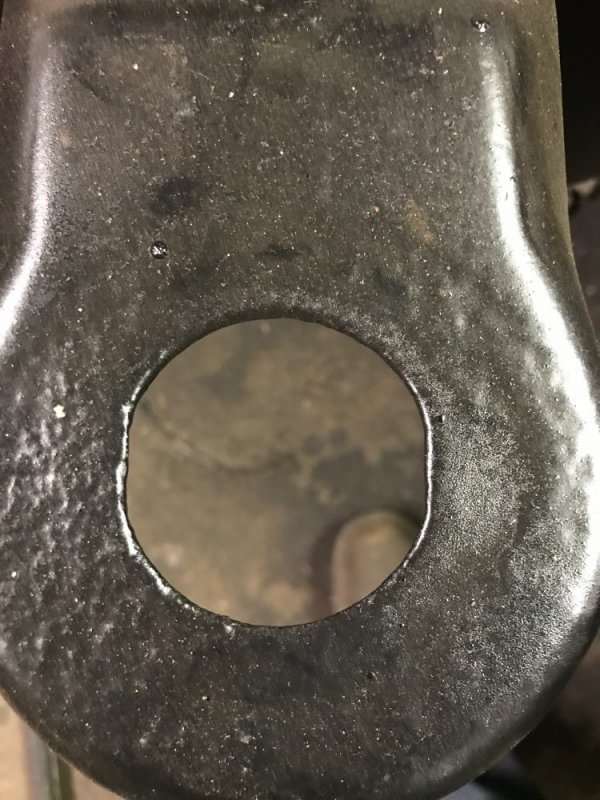

How about if You are in question of the mounts having a flat side, run a bead of weld on each side of the hole ? That should stop them bushings from turning.
