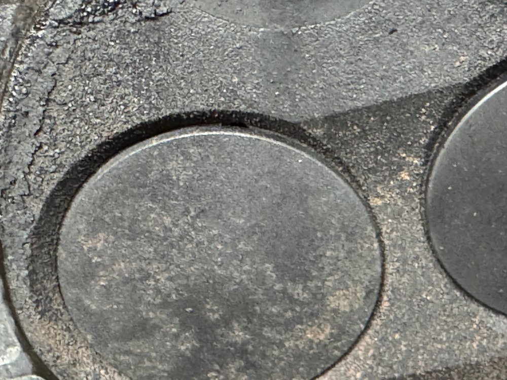

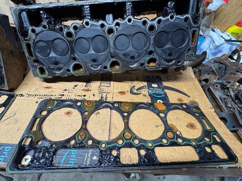

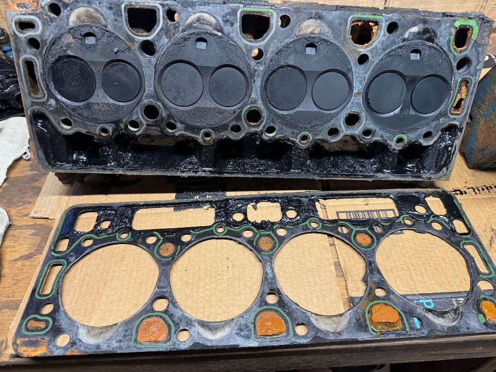

both heads look crack free between the valves but there is quite a bit of carbon buildup on the faces. the only thing I found is on the exhaust valve seat looks like it might be burnt on #7 though that cylinder had 300psi compression, it's hard to tell, but I will need to remove the valves to see it better.

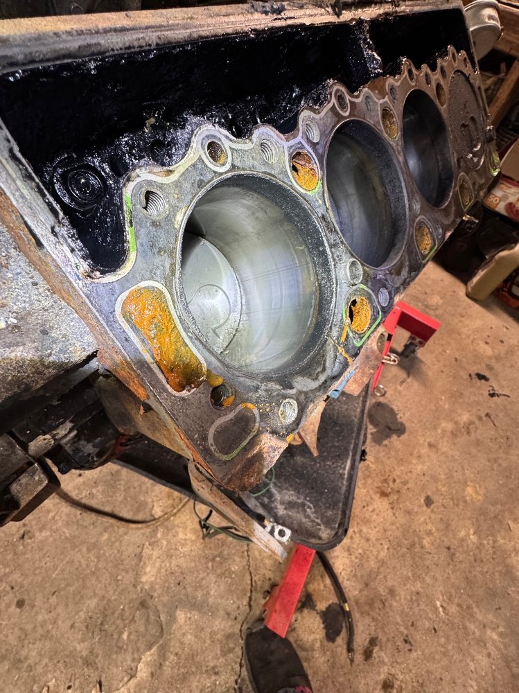

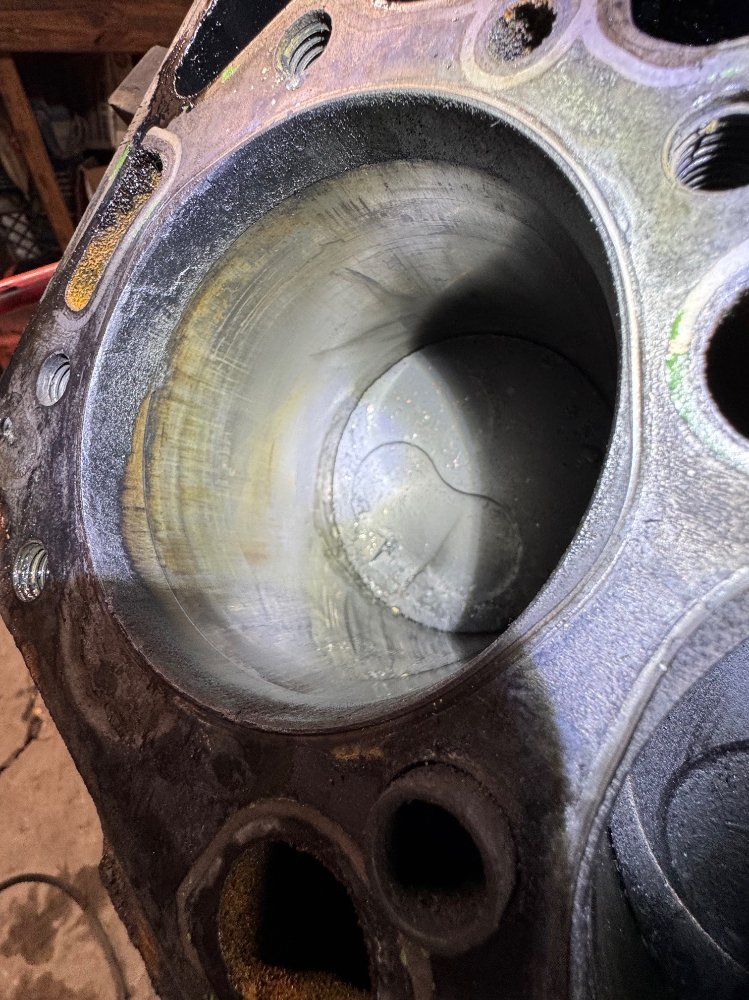

cylinders all have a very small ring ridge that I can catch with my fingernail. no scratches that I can see or feel in the walls. and if I shine the flashlight just right I can start to see what's left of the crosshatching about half way down. some of the cylinders have what looks like some staining that is kinda orangish in color, it's smooth and I can't feel any pitting. maybe it's old diesel but not sure.

Passenger head (#8 left)
Drivers head (#1 right)
#7 exhaust valve. look at about the 12:30-1 oclock position you can see a gap This cylinder had 300 psi compression
#1 cylinder. the lines cannot be felt with my fingernail.
#8 cylinder. this one had zero compression, but by tapping on the valve stems and pressurizing the cylinder with air, it sealed up

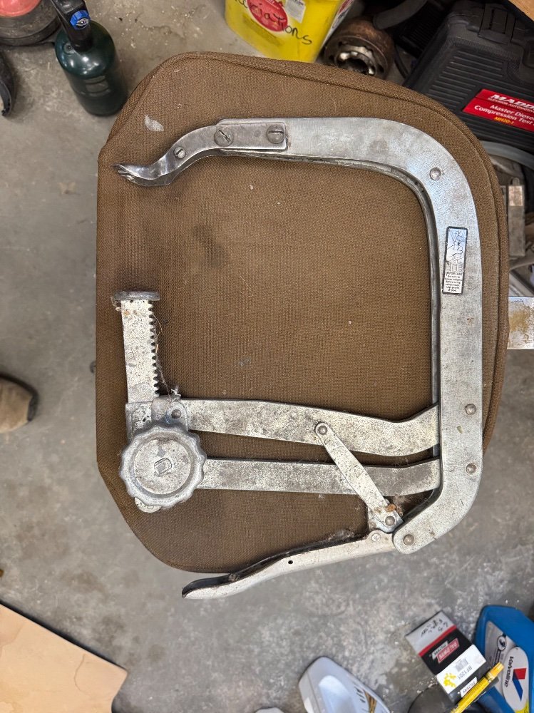

Moving forward, I have a couple questions. I need to purchase a couple of tools to dissemble the head further.

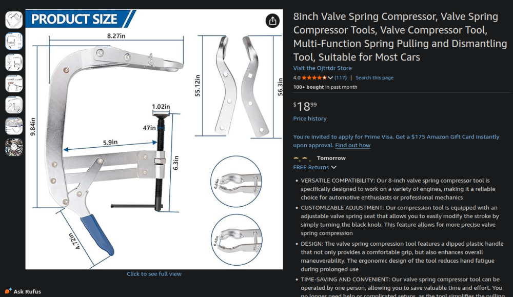

I need a valve spring compressor. Which one should I get. don't need an expensive one since this will most likely be the only time it gets used.

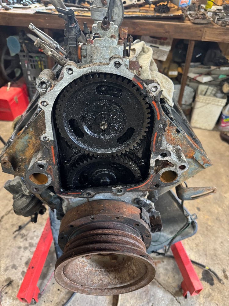

another question: I plan to drag the heads outside and go to town with some de-greaser and the power washer to clean off as much of the sludge as I can along with the carbon. Can I safely do the same with the block leaving the lifters, crank, cam, and pistons installed. I plan to strip the block down further removing the IP, water pump, HB, timing cover, and oil pump prior to blasting it clean.
another tool I have been thinking about getting is a "super scraper" to clean off the head gasket surfaces. am I safe using that on those surfaces, I have been told not to use anything abrasive on those surfaces. also can I safely wire wheel the cylinder top edges where all the carbon buildup is with my drill.
Valve spring compressor can often be rented free at auto parts stores doing the pay first then return for refund. If you are planning on rebuilding multiple engines- then yes you can buy one. Otherwise there is also some diy tricks you can learn on YouTube to just lever it.
DO NOT use a carbon scraper, razor blade, roloc disks, etc on the head or block surface. It is easy to damage it. Engine degreaser, oven cleaner from the dollar store works. If you do scrape with anything, it should be something way softer than cast iron like aluminum. It will destroy the edge of the aluminum and not hurt the head or block. Wire brush by hand. Taking the time and effort keeps you from causing damage.
Whenever you see someone using a steel or carbide scraper - the plan is to check out if that part is worth sending to the machine shop or they just are unaware.
There is a ton of tricks you can do to avoid paying a lot of money if you rather put in more effort to save cash. Like resurfacing head & block deck via glass sheet & sandpaper. But if the valves are burnt- there isn’t a lot of options outside of a machine shop. If it’s going to a machine shop, cleaning it more than a pressure washer is a waste of time because they will need to hot tank it once valves are out- before they redo the valves and clean up the seats.
