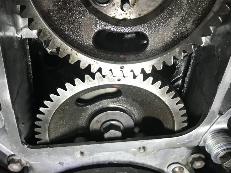

Here is the cam gear installed and torqued with the DSG gear drive gear. Note the position of the timing dot on the gear which rotated a little while torquing the cam bolt to 125 FT LBS.
I have always wondered about the small half moon key in the cam and why it wasn't a full slot ?
I may just mill the slot in my cam and use a full length key... as is only about half the key engages the pump gear..
