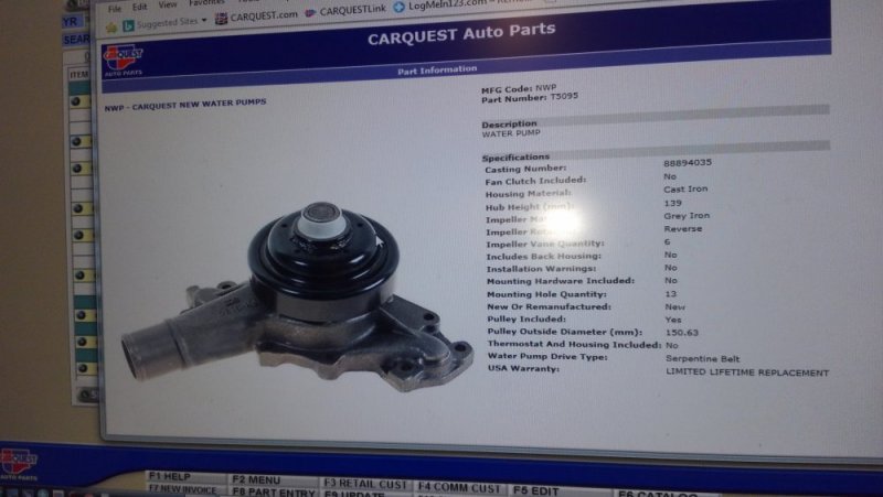

Ok than ill return the 4 bolt pump in a.m.. I'm sure AK remembers our conversation about the 99 pump and the confusion we had LOL..the guys at CarQuest said they were going to put it on the shelf and keep it they weren't going to send it back.. that was a spin on style..I'm going to go down there first thing in the morning and grab it after I return the 4 bolt one..(hopefully it's still there).. if not they can have one overnight worst case scenario...AK I gladly take you up on your offer but I would have to insist on giving you something for it.. plus shipping from Alaska is gonna cost a bit.. if he happens to decide to get my truck into the shop before yours gets here I can go to the junkyard and get a spin on one from there.. even if it's no good it doesn't really matter cuz the one I have is no-good LOL at least the pump will be on the truck..

On the waterpump it counts to get the ac delco. It being a balanced flow is the ig factor.
