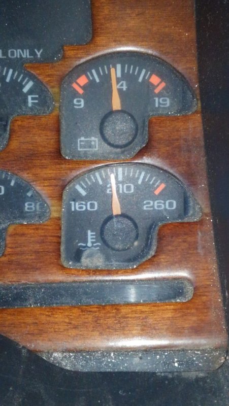

Somebody please correct me if I'm wrong.. but if my temp needle is reading 1 1/2 lines under the 210 mark that means I'm running at 200 degree correct? I'm attaching a pic (Sorry haven't cleaned the truck in quite a while..) I am sitting idling and the temp keeps bouncing between there and the line just below it... I'm pretty sure my temp gauge is reading a couple degrees warmer than the truck actually is.. cuz these are brand-new 195 thermostats and she almost hit the 210 Mark before they opened.

My buddy has one he will let me borrow...but after I posted that question I ran her up a steep hill.. power-wise and she blew right up it... But by the time I got to the top she was waaay past the 210 mark.. I don't know what's going on.. just seems like for some reason she can't stay cool..
The #8 cylinder is the hottest point of the engine that has a location to read temps from. I normally add a manual gauge there.
The dash gauge is junk imo.
I agree with AKDD- scan what the crossover is reading for comparison.

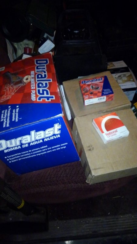

The stock water pump is still in it.. have a brand new duralast one sitting on the seat.. right next to the brand new AC Delco harmonic balancer and pulley and timing chain and front main seal.... They were supposed to be put in 2 weeks ago.. but as is always my luck other things are always in his shop....
Look real pretty sitting there don't they..

And go ahead and start yelling I know I should not have bought a duralast... It's what I could afford
No one yelling. I have had to get a waterpump from junkyard so- we get it.
Was wondering if 4 bolt pump or spin on. And was thinking you already put on the new one mentioned before but could not remember which you got
It really sucks no more new take offs from peninsular. $70 after shipping for a new spin on delco was killer. Ah, back in my day, could see a flicker show with a soda pop and popcorn for a nickel....haha.
It's a 4 bolt... Only because nobody in my area could get the spin on style tow haul fan clutch..... Of course it doesn't matter because that was a waste of money to because it doesn't kick on till it hits like 215degrees. On the gauge

I would seriously consider either sending that pump back and find spin on online cheap as possible if you can return the fanclutch.
Or maybe you can do the electric fanclutch like AK Diesel Driver did, but find clutch and fan at junkyard.
The other option is get the hmmwv full lockup fanclutch on the 4 bolt. Just have to watch ebay, or try Teds.

That spot on the gauge is roughly 195. The large mark between 160(should be 100) and 210 is 180.

To save their gauges leave much to be desired is a great understatement... I was actually thinking about getting one of those OBD2 plugs someone told me about that Bluetooth to a tablet or smart phone.. I know there's apps you can download "not sure which ones are good or bad" but some of them will give you a real-time digital gauge display that's actually accurate..
