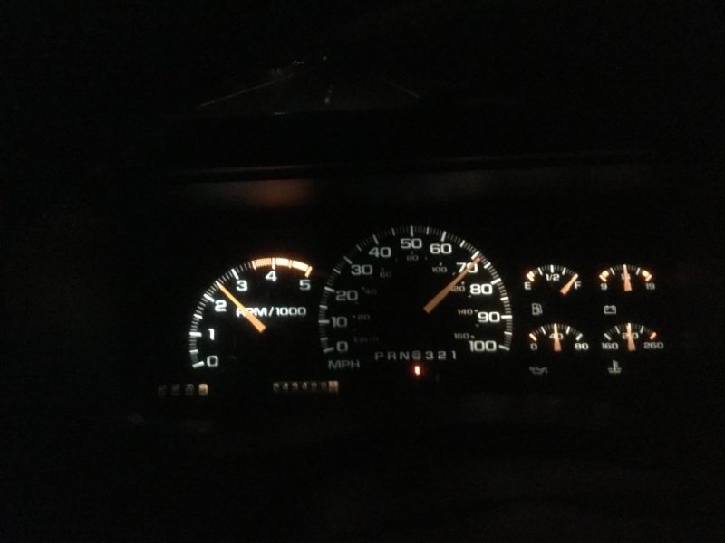

My girl and I drove the 99 diesel Tahoe up to Greenville NC to buy the Suburban. Driving back we spoke on the cell phones and compared RPM's at different speeds. Here is a shot from our ride back of my RPM's in the 95 BURB.
As you can tell by the pic... first my gas gauge wasn't going crazy and my speed was about 72 MPH @ 2.5 RPM the 99 Tahoe 6.5 was doing the same speed 72 MPH @ 2 RPM's. Now I was thinking... The suburban might not get as good gas mileage as the Tahoe because at higher RPM's you burn more fuel... Please correct me if I am wrong. So my rear is geared differently then the Tahoe, Right?
Or might the difference in RPM's at the same speed between the two be because the Tahoe doesn't have the stock wheel size and the suburban does????
The Tahoe is running 18' rims and I don't even know what size tires. Now taking that into account I was wondering how that would affect RPM's...ETC...
Even though the suburban was running higher RPM's I was surprised to see that I only burned 1/4 tank of fuel all the way back to my driveway. It was a total of 202 miles.

. . . my speed was about 72 MPH @ 2.5 RPM the 99 Tahoe 6.5 was doing the same speed 72 MPH @ 2 RPM's.
Based on those RPM's the Burb probably has a 3.73 rear (which is common). Also, as mentioned, make sure the TCC is locking (feels / sounds like a 5'th gear when you hit ~50 mph).
The Ho might have a 3.42, but the question is whether those different tires have the same diamater as OE. If they are the same diameter as OE, then you are basically Ok. If they are a different diameter, the question is whether the PO modified the VSSB to account for this. When the two of you compared RPM's on the drive home, did you also compare indicated speeds? If so, and the speeds were close (within a few mph of each other), then the Ho either has OE tire diameter or the VSSB was adjusted.
