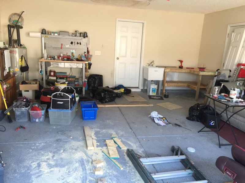

Okay today I starting making room in my garage for her. Should have her in there by tomorrow night. Then I get her on jack stands and clean her up underneath and take a slew of pics both under and from engine bay. Built a work bench today.

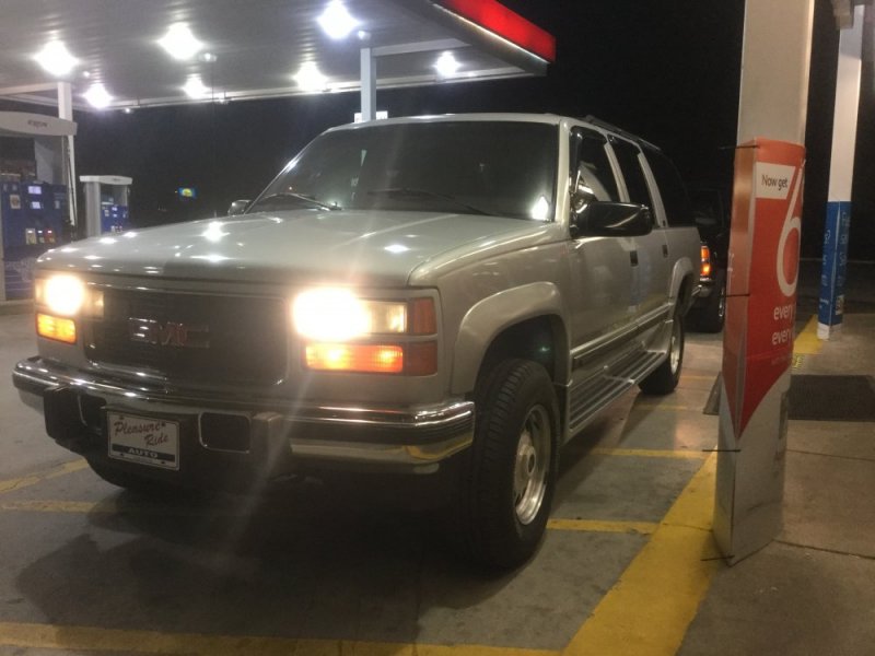

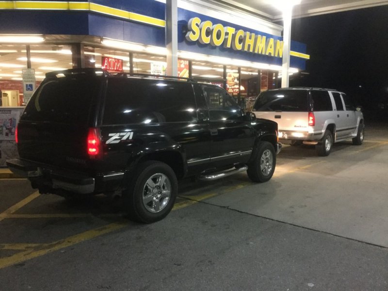

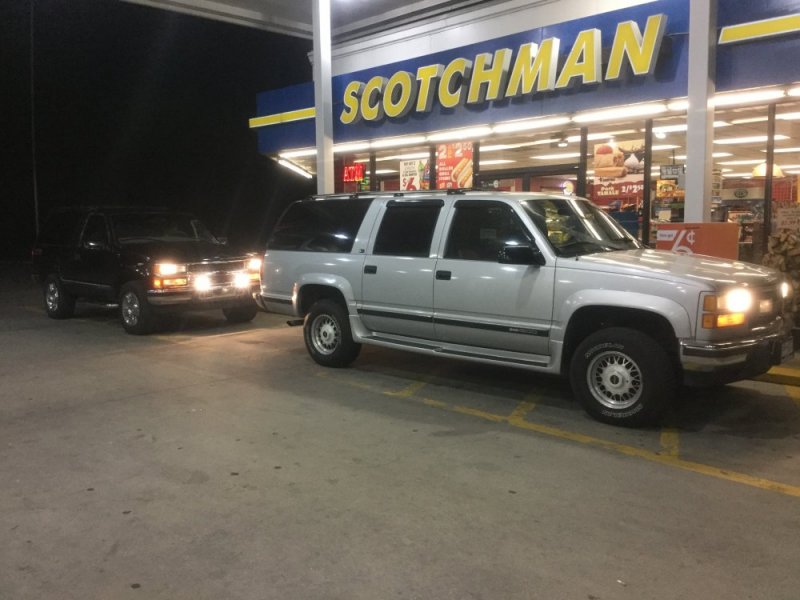

image.jpeg image.jpeg image.jpeg Just an update. I'll be working on her soon. Just been busy past two days with family life, and work. I also bought the 1995 GMC Suburban 6.5 TD. She runs just as good if not better then my 1999 Tahoe 6.5. She's got 8 lug but she is the 1500 not 2500. I am proud second owner. She has a button I have to push with the key in turned to on position count to 10 and start her but she doesn't start as easy as the 99. The Og Owner had the PMD relocated inside the front grill as you will see in the pics. Also he said super go plugs or something like that is why push that damn button! I am not crazy about the rims and want to tint the Windows. She recently had wheel bearings and hubs replaced. I think it's time for new struts/shocks.
Here are pics from last night driving her back home when we stopped at a gas station for drinks.
Well still need to buy some jack stands and get the Tahoe into the garage. I bought some degreaser and brake cleaner to clean the bottom of her.
Will the dash light come on without pushing the button? If not you can always wire it back proper. Replacing his magical insta-junk glow plugs (I too have wasted $ on them) with some Bosch duratherm or AC Delco 60g will fix that annoyance.
Never use starting fluid, a touch too much will toast your engine. Any amount will destroy a good set of glow plugs.
