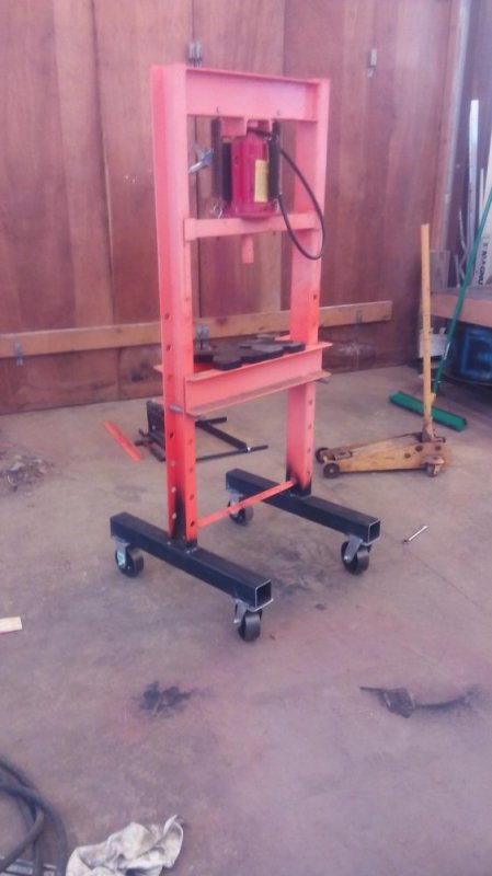

So I'm trying to decide whether to put my press on casters. Anyone have an opinion? If you do I'd like your reasoning.IMG_20160316_163232.jpg
Definitely on wheels, but maybe not casters. I think 2 wheels on a bracket off to the side is better (with a light weight press) Then you just tip it and move it on the wheels. When in use it is stable and you don't have to fight the casters moving it around when your working on a piece.
I plan on putting mine on castors, one fixed set and the other rotating. You can get them with brakes. This way I can push it against a wall when not in use.

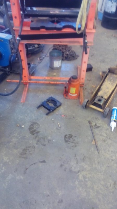

I' think I'd have to build a new base for it to put it on casters as the angle that sits on the floor is pretty thin. I don't think it's even 1/8". The other thing that I'm concerned with is it keeping me from getting close enough to it.
I guess I could get some square or rectangle tubing and just replace the angle and then put the casters directly on the tubing
Unlike the bolt bin, I like casters on the press idea. Replace the 2 angle iron feet with some 3" channel iron or 2x3 rec tube. Wheels at the corners. You'll be able to work In-between the legs just like now.

I am all for things on wheels so occasionally when you need to sweep up stuff under it. And sometimes you have to move stuff for any number of reasons.
But I like machines stationary when in use. It helps rigidity and stability slightly with the foot friction. Also machines like to be level and plumb. The small stuff is not as critical but I have seen milling machines shake, jiggle, and vibrate from a bad heavy cut. Climb milling is the worst.
I like the idea of the casters with built in leveling and wheel functions but bet they are more expensive. Or retractable wheels of some type.
