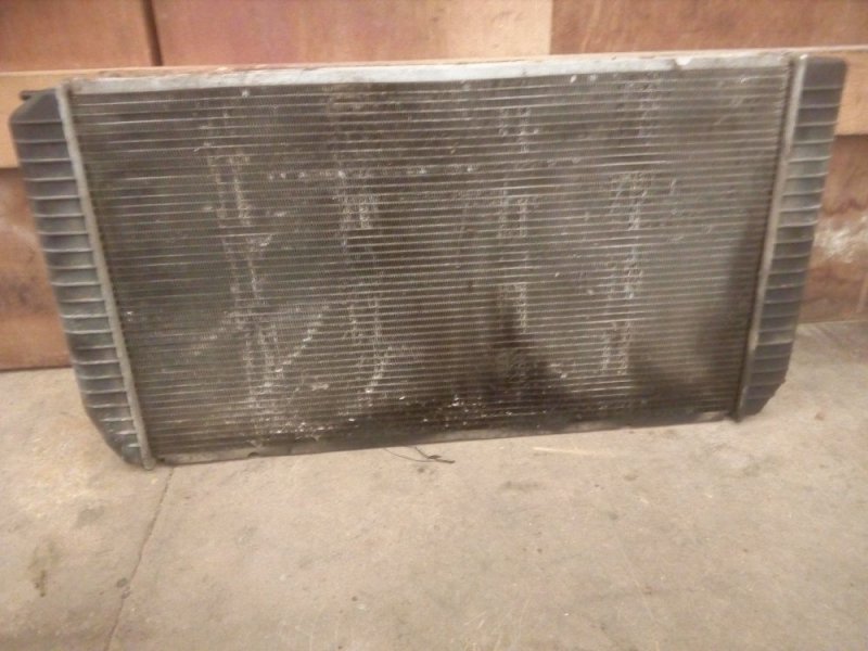

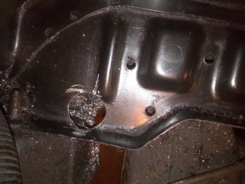

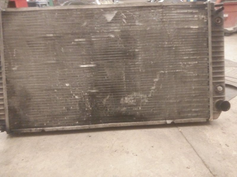

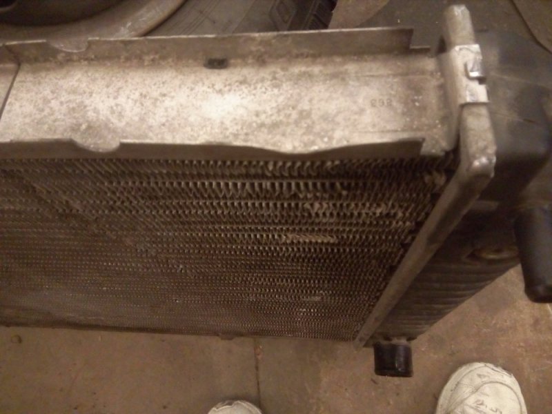

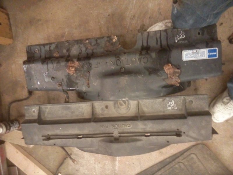

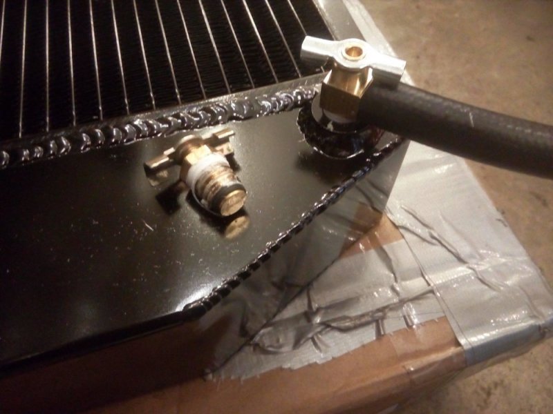

So pretty much got it back together. Drilled a hole in the core support for the drain tube to go into. The champion radiator is a good looking rad albeit a little too universal. There wasn't really much going into the rubber brackets on the bottom but the bottom is better than the top. I ended up bending the top brackets down a bit to get some tension on things. Other than that the only other thing is the metal tube going to the reservoir was one size too small. I ended up taking a piece of clear tubing that fit the tube snugly and sliding it on first then cutting it off flush with the tube then the rubber hose fit pretty snugly over that.

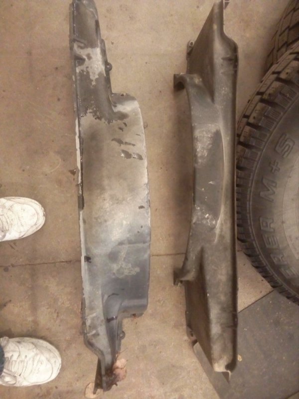

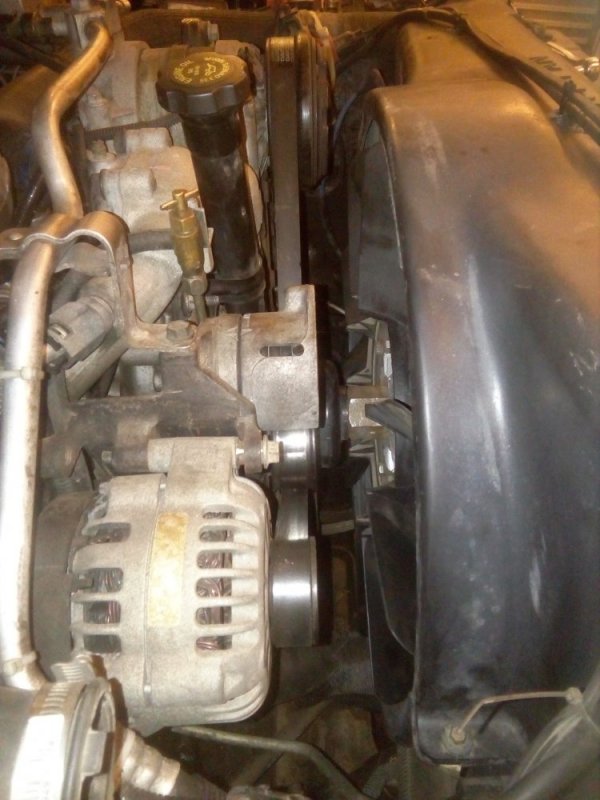

So as you can see now the fan is mostly covered but not totally, so I think I'm going to call that good.IMG_20190109_180102.jpgIMG_20190109_200808.jpg
