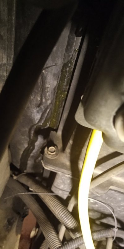

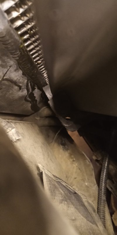

While it was in the shop I decided it was time to see where my coolant leak was. It was dripping on the floor about where the draincock is so I was hoping for an easy fix. Alas no.

Hmm I was just on champion radiators website and they have a lifetime warranty, I wonder if I can get in on that? Hopefully the coating Chris applied doesn't nullify it.

So I have been hesitant to post this but my hard hot start seems to have gone away. I'm thinking my ignition switch might have been the cure. Also Chris thinks Champion is going to warranty the rad and he will coat the new one and send it to me. I actually wasn't expecting Chris to recoat it for nothing as it wasn't his coating that failed. Gotta say that's REAL customer service.

I have a radiator that is seeping there as well. Not bad enough to make me do anything about it...... yet............... Glad to hear that Champion will warranty it.
