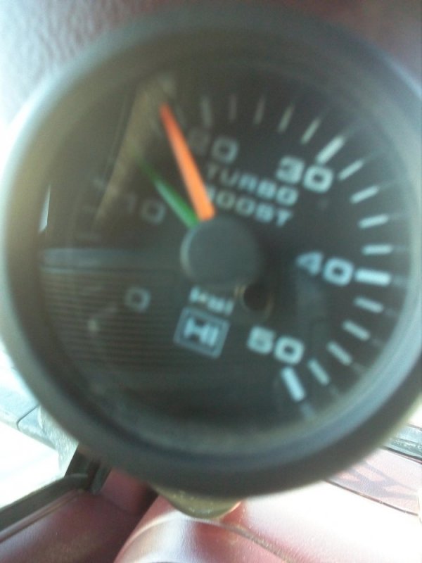

Looking at the pic. of the gauge, is it the green needle or the red needle that shows the boost pressure.

Green needle is boost orange is drive pressure. That's last pic is reading about 12 psi.
