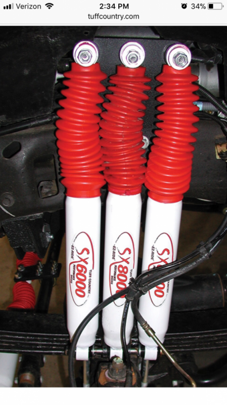

129_1205_01%2Bsix_pack%2Bmetalcloak_six_pack_shock_exploded_view
