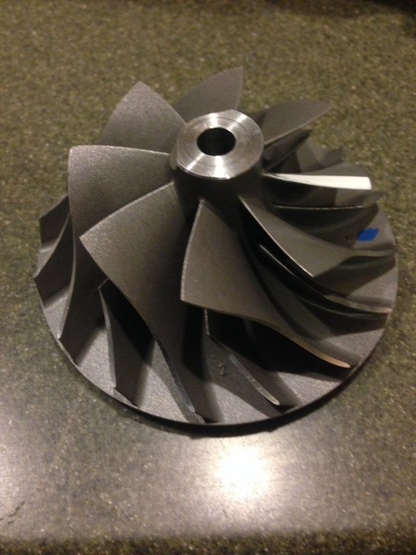

Oh also, my new 58/83 wheel came in for the HX40. Based on how the 35 behaves, the 40 will probably suck on stock fuel, but it will be kept for down the road, or as a spare in the event that something happens to the 35.

You need to identify if the smoke is fuel or oil. Higher boost pressure can push oil past a seal that is not perfect easier than it can at lower pressure. Oil past the seal burns up partially in the exhaust causing smoke. Just saw this in a friends furd 7.3 that once the turbo rebuild was done he is somewhere in Wa. currently headed for Ak. without any smoke now.
If it is not oil, then I would think fuel curves after that. Keep in mind I know jack squat on program capacity, So I always look for what I understand first, then come to the pros to teach me...
My HX40w CKO lites up right away w/Heath's Maxi Torque tune, bellows a good amount of black smoke when I nail it (way more than w/GM8) which soons dissipates and my Burb hauls a__ and mean really hauls. I'll be getting the HX40 specific tune Bill recently did for someone for their 6.5td w/4L80. My driving style has changed by not having the need for lots of pedal input as before.
I suspect the later smoke on your 6.5 is bypass under boost!
