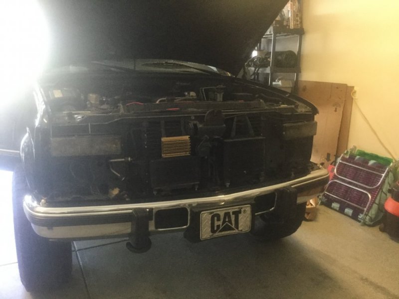

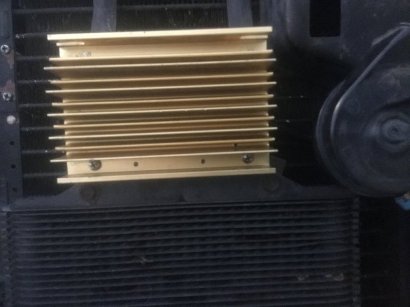

Well I installed the new PMD I bought from Leroy. I also ditched the old wire harness and used the harness from Leroy however I didn't use his heat sink because it was considerably smaller then the one I had and I already had mounted my older PMD with this heat sink in the grill. Now my old PMD will be my back up which is in plastic and a foam insert in a nice little box in the truck under the passenger seat. Here are some pictures.

Yeah I wasn't sure about blocking part of the radiator though.
Check airflow over it with engine running, use stick incense or even a lit cigarette 'smoke' so you can see the flow. You will notice the smoke is pulled around the heat sink 'not through its fins then around." However, turn the fins 90 deg and the smoke will be pulled through the fins and back side of heat sink indicating best flow and cooling effect for that design when engine is running and at speed.
You can see the results w/laser thermometer too...
