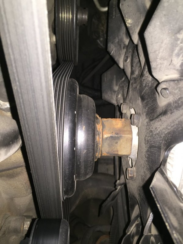

On the fan clutch/ waterpump that is the old style. At some point in the future you are going to want to replace the waterpump, fan clutch, and fan. Hopefully someone here smarter than me can post a link to a thread teaching the part numbers and what is involved. The nonsense involved with the 6.5 water pump vs the gasser gm engines is ridiculous. Twice the work.

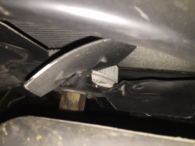

It looks to me like you have the new water pump already. Could you get a picture with a flash. Sure looks like a screw on clutch to me?
