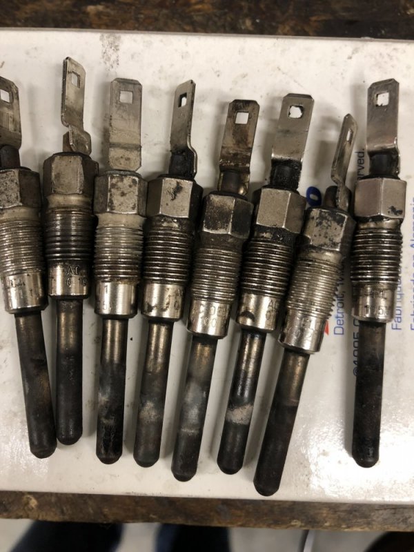

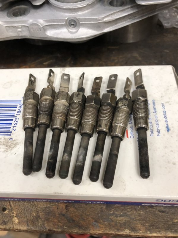

They all are marked 10.5 volts so I am sure that they are 60Gs.
I didnt know the history on this truck so I installed new injectors and GPs. These looked too good to toss. Poked them into the boxes and have had them setting in the tool box ever since.
A couple of pics.
I used a brass wire brush and brushed off the diesel soot from them GPs. I think the PO must not have tightened them to spec.

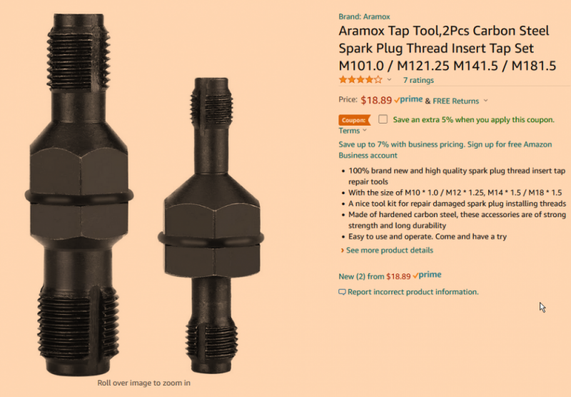

M10x1 thread chaser is good to know. I often chase threads of things that need to be torqued.
Does anybody have a link to a M10x1 thread chaser or set that containes one? I found thread chasing dies, but no taps

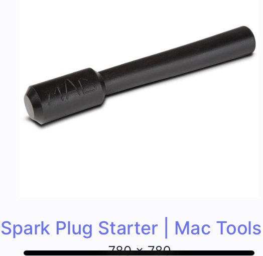

With a non-rusty glowplug, try hand threading it in. When it goes in all the way by hand, you are done. A trick to hand threading in or starting a glowplug or spark plug and not cross threading or just simply getting it to start in hard to reach angles: slip a 6” to 12” piece of vacuum hose on the end where the socket goes. I can’t believe how many of these Mac Tools spark plug starters I sold when I was the tool guy. Ift guilty and told everyone “you know you can just use a piece of vacuum hose, right?” 90% still bought the thing for $14.99 instead of $2 worth of hose. (See pic)

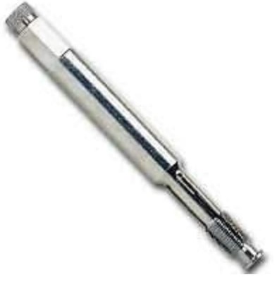

What if yours are so rusty you had to use a propane torch to heat the glow plug enoung to remove it? The bottle brush (brass is best) didn’t get the job done after 5 minutes of drill spinning. Then you still should not use a regular thread chaser and NEVER A NORMAL TAP!!! This is where this tool comes into play. It’s pricey and you use it once, then it sits forever in the bottom of the tool box, Then 20 years later you sell it later for $5 at a yard sale. Look close at the threads. They collapse and expand. You spray wd40 on it, collapse them, slip in the hole, expand them and unscrew it from the hole. Rinse with wd40 and do it again. Then go back to the brush 1 time only for a couple seconds. Then try the glow plug by hand, preferably with you $18,000 mac tools chunk of rubber hose. Haha
How often this tool is actually needed? Almost never. If it is zombie day and I could not get this tool, but really needed to- can you use a normal thread chaser- yup. But I would supply shop air into the intake manifold so it is blowing out the glow plug hole non stop while i used it.

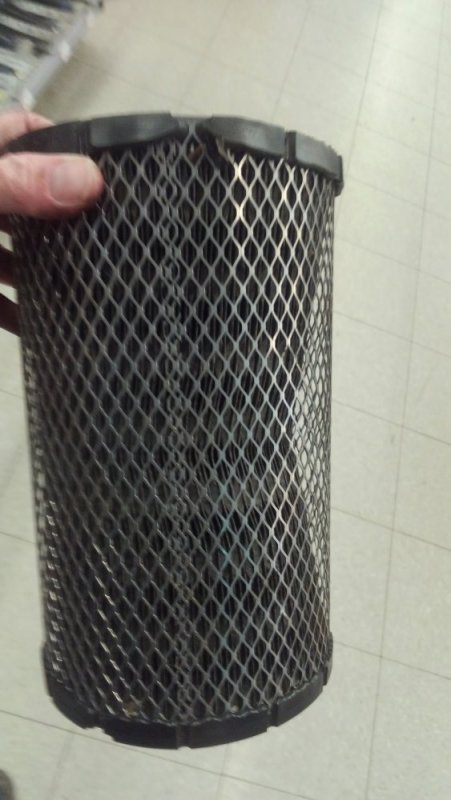

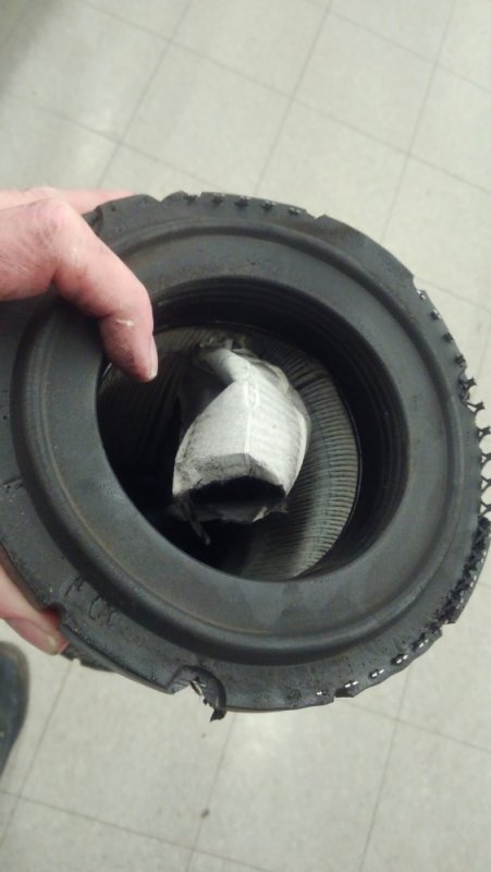

Yipes!! I have only seen this on some of the equipment at work. the last one had an exhaust leak where soot got into the air cleaner and choked it off. you's doesn't look that dirty to cause that. maybe cheap quality filter looking at the end cap had torn also.
I hope it didn't dust your engine.
