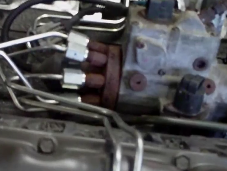

I found it. It is leaking on the passenger side of the IP from just behind the little module (not sure what it is) phillips head screw. It looks like I need a new IP. Take a look at the video. It's hard to see the drips underneath the little module.

It looks like I will need to take the IP out in order to fix it. It is down in a tight space. I couldn't see exactly where it was coming out but I saw it drip right under/behind the phillips head screw you see there.

The module on the passenger side is the timing stepper motor that advances or retards the timing. It's complex in it's workings, but, you may be able to simply reseal it without a pump rebuild. Make sure you know where the leak is coming from as the video isn't good enough for us to help. A good pic is worth 1000x more than a bad video.

I used my snake camera to get a better look and it was hard to get it bent in the correct position but it looks like it is coming from behind that stepper motor. Here is my question, since I have to take it out to seal up the leak and the IP has at least 150k why wouldn't I just replace it?
