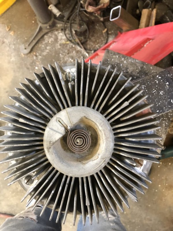

If you have an old junk one, take a self tapping screw that’s about 1.5-2” long. Run it through the fan clutch. The hen it will be locked up 100%. This is a get-you-home fix if ever needed btw. Then you will know what it is fully locked up. It will also show you if being on solves the heat issue. It absolutely should keep it at the thermostat temperature. If it doesn’t- there is a big problem somewhere else.
@Will L.
I just happen to still have the original FC and I will give that a try tomorrow.
Its suppose to be up next to 100 degrees again, and, I should be able to hear the FC too.
Any suggestion as to the area where the screw should be run through ? Or does anywhere work ?
just so it foes through all 3 parts.
Not exactly same clutch, so location and angle is wrong for our clutch, but you get an idea.
another method: i never tried, but makes sense:
Probably go with two clamps to keep the balance a little closer. Place the screw mechanisms opposite sides of each other.
I’ll be running the clamps until I can get the electro fan set up here.
If you do it and it helps keep temps down- yeah. If it doesn’t, that tells you any different fan clutch won’t solve it- time for water pump.

I did drill, thread and install screws into the old leaky fan clutch.
Just now getting the fan loaded onto it.

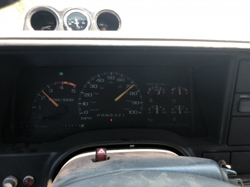

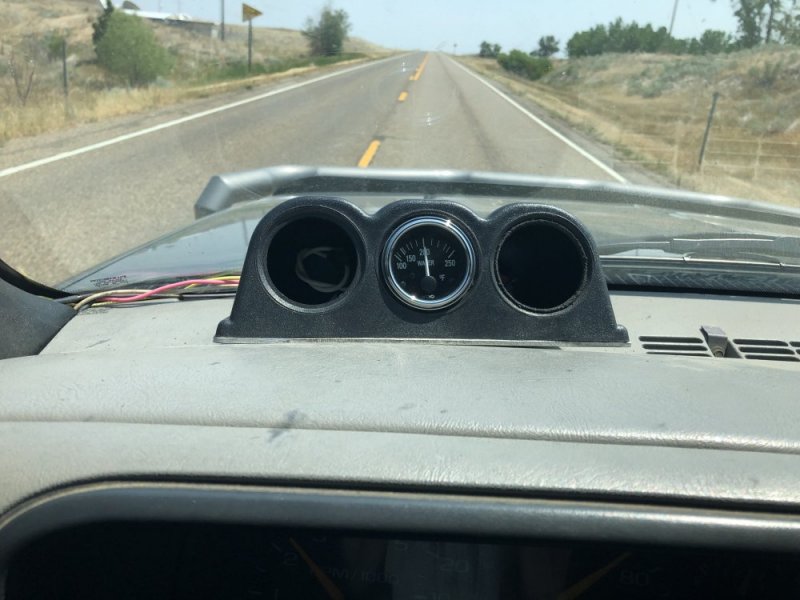

Coming back home, aimed the truck for the Yellowstone bridge and up over the hill. Went out about five or eight miles 🤷‍♂️ Turned around and there is quite a pull coming out of Sunday creek to the top of the Yellowstone hill. Just sort of cruising along and snapped a couple of pics as I was getting close to the top of the hill.
Beats the crap out of that 217 that it was running pre locked up fan clutch.
I’ll run with this FC for the rest of the summer, switch over to that phoney Kennedy Diesel unit after the temps gets cool then work on getting funds to pick up on the electro viscous unit. 😵‍💫😹
And the right rear cylinder temp too.
