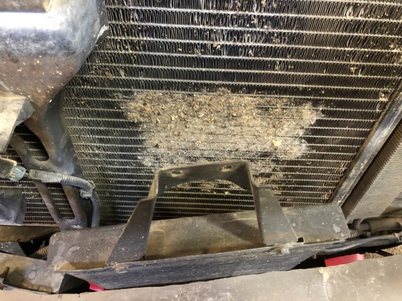

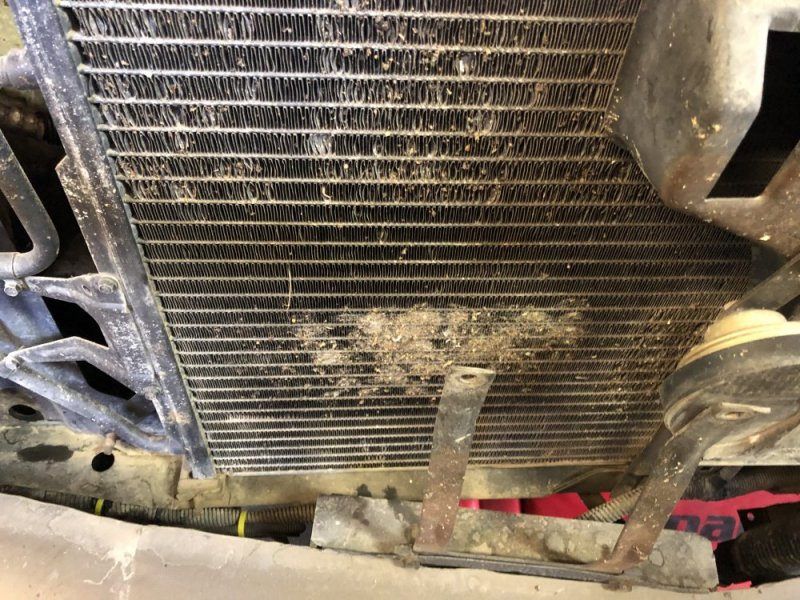

Stack was quite clean. After getting the truck, going into the cold season, pulled the grill and loosed the engine oil cooler and trans cooler, had an old H2O extinguisher, detergent and water and soaked it all down then blowed it out through the fan blades.

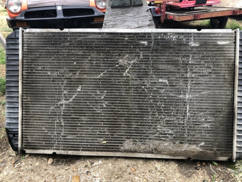

I think those are before pics...
Yup, just pulled and set it outside.
I have a new aluminum radiator from Chris that is now in the hole.
I did not use any solvents or cleaning agents on the condenser or on tje oil and trans fluid coolers and I now am wondering if that is something I should do.
Pull the new radiator, scrub the coolers and condenser with solvent, wash with detergent and water then rinse and blow dry.
Maybe that will be tomorrows project. Only bad thing is no floor drain in the garage but I have dealt with woreser. 😹😹😹
Pulled the new radiator, scrubbed the coolers and condenser with solvent, then attacked them with detergent and water and a thorough water rinse. Got the radiator back in, hooked up and the lower shroud back in place.

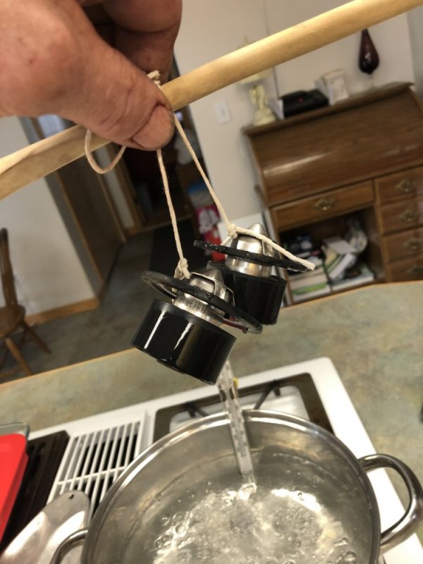

I hung the stats on a piece of string. Using the wifeys candy thermometer started heating the water.
At 190 degrees the one stat cracked open. At 195 the other stat cracked open. Got the water temp to just over 200 degrees and this is how the stats looked at that temp. If they would open any wider I know knot. It seems that the water had quit absorbing heat about that temp.
Going to put the 195s back in and see what the temp of the engine does with just the new radiator.
Then if necessary I’ll install the 190 stats and see what happens with those.
I know 5 degrees is not much but, if I can get the engine temp down to 212 from 117, that would be closer to a reasonable goal.
