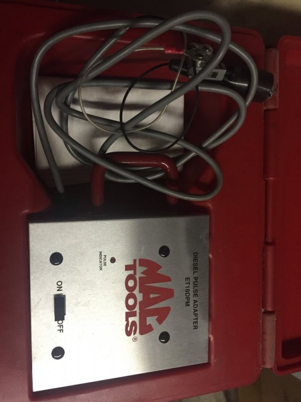

If your timing cover does not have the score mark in it for timing the db2, timing it will be annoying. Used to be multiple tools available like the snapon with the pickup device that wears out as you use it. Or the Mac ET18DPM diesel pulse adapter which requires a timing light also.
There is a kentmoore tool for stamping the timing mark in the cover, but I forgot that number. Knowing the exact sound of your engine, you can time I to mimic the same sound, but it wont be perfect.
And since I like pictures:
Incase anyone sees one with words rubbed off ata yard sale for $20...youll make your money back. Yes thats the instructions paper incase anyone needs a copy.
I bet an electronics guy like @greenmeanh1 could build a unit like my Mac and sell them for extra cash (hint), I remember seeing lots of guys looking to buy the snapon because it was more popularly known to exist. But imo one that doesn't have parts to wear out is better and gets its signal from the injector firing instead of an adjustable timing tab.
