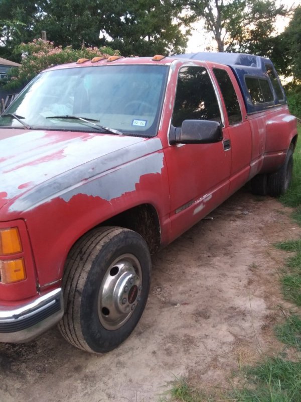

Just for kicks here's a picture of my first big truck. The Big Red Beast. A still life to old diesels.

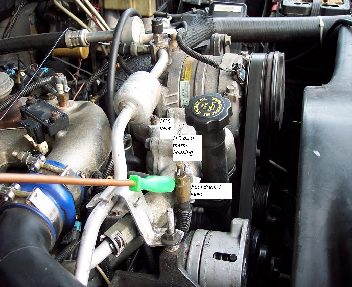

A mechanical pressure gauge attached at the T-valve located at the front of the motor by the T-Stat will give you some idea of the state of the fuel system. At least with 4-5lbs at idle, you'll know not to toss money that way. Picture credit to TurbineDoc. 57328
