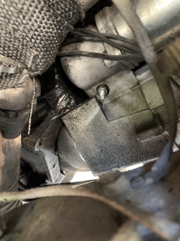

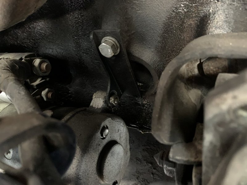

If you guys wanna see the damaged block that I found shortly after I bought the truck. All because if the starter bracket! And the new bracket I installed is actually bent!
another reason to ditch this engine

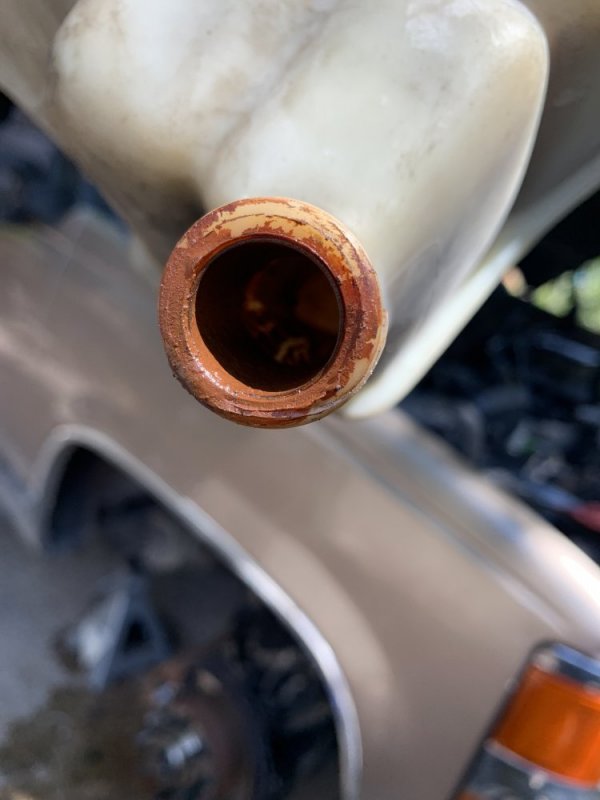

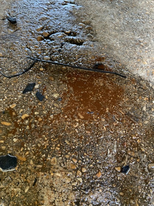

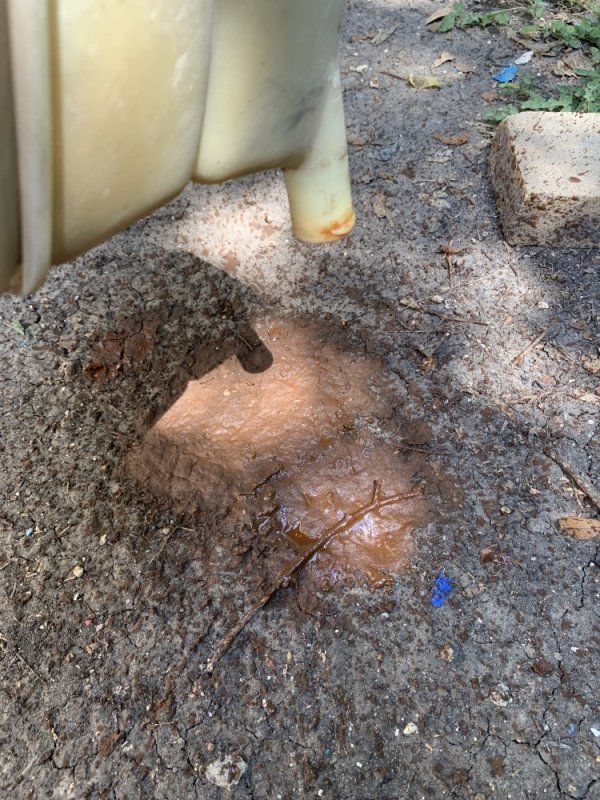

And it way over due for a flush!! Look at what drained out of the coolant tank!!

Well guys just ran to Wally World and grabbed some green antifreeze, engine restore, and some CLR. Gonna soak the coolant bottle in the clr while I flush out the truck and change the oil
let’s see how much krap I get flushed out

@dbrannon79 have you experienced any of the symptoms of cooling system over pressurization or unexplained coolant loss prior to this? Be on the lookout for those after you do your flush and coolant refill, from your pictures it looks like a lot of that "crud" you flushed/drained is leakstop and/or sludged up DexCool. Just my two cents worth.
I’m sure there was leak stop in there at one time. When I bought the truck the radiator was cracked around where the top hose went. It was patched with all kinds of cement. I pulled it and had the tank replaced and rad cleaned out. Since I have never had any overheating issues. Haven’t noticed any mysterious coolant disappearing but then again I’ve never paid any attention!
