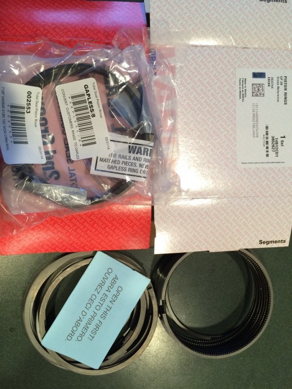

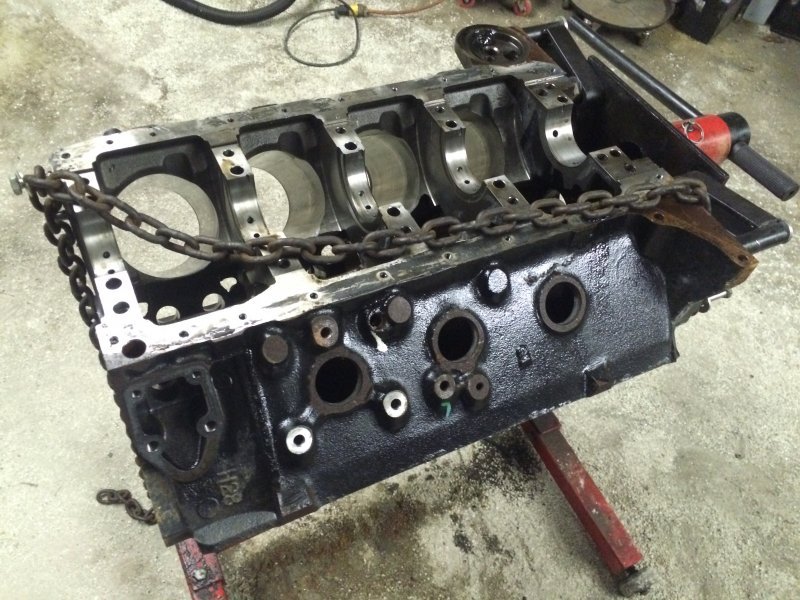

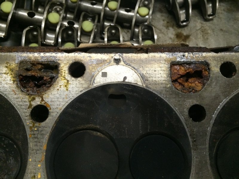

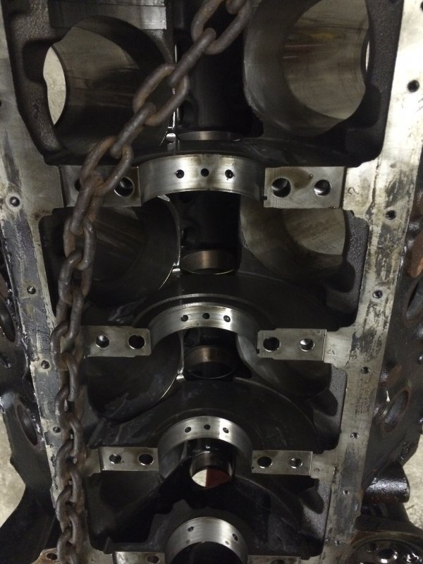

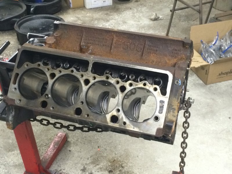

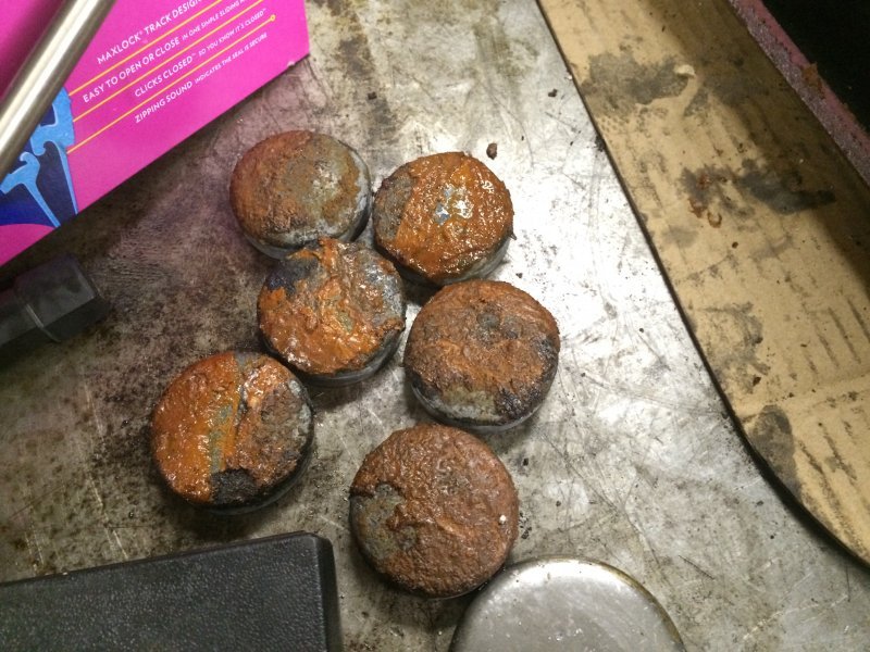

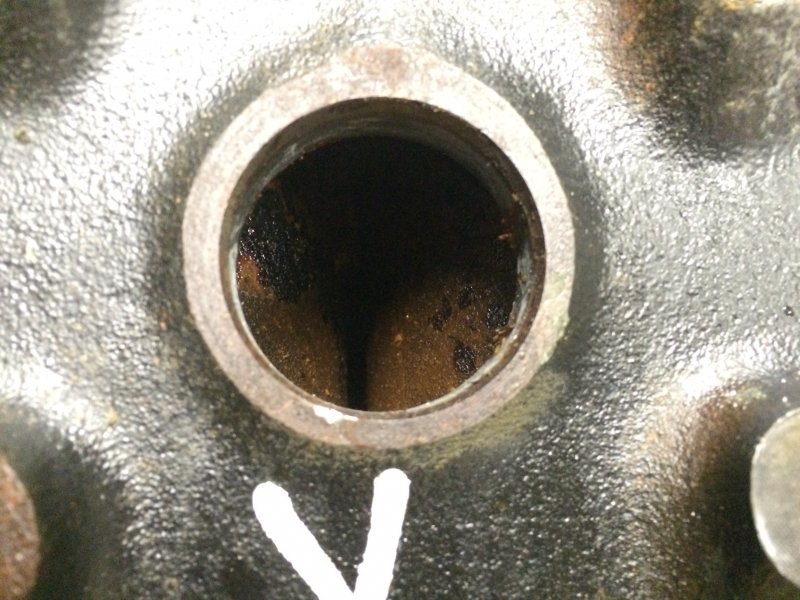

I got the block stripped the rest of the way tonight. All of the cam bearings are showing hints of copper!!:eek: Tomorrow it's going to the machine shop for a good bath, new cam bearings and a fresh hone to cuddle Leroy's gapless rings:D:D I'm mildly stoked right now. I wonder if they used straight water to cool this thing? The water that came out was brown and the coolant passages sure were crusty. I also found a couple fine scratches in the journals so I'm going to see if they think those should be polished or not. I can't wait until this bullet is sitting in the correct end of the Tahoe!image.jpgimage.jpg image.jpgimage.jpg image.jpg
I'm thinking it had water only for those coolant passages to be that crusty!:eek: But its nothing a good cleaning, and some new freeze plugs won't take care of. ;) I'm really quite green with envy. :D

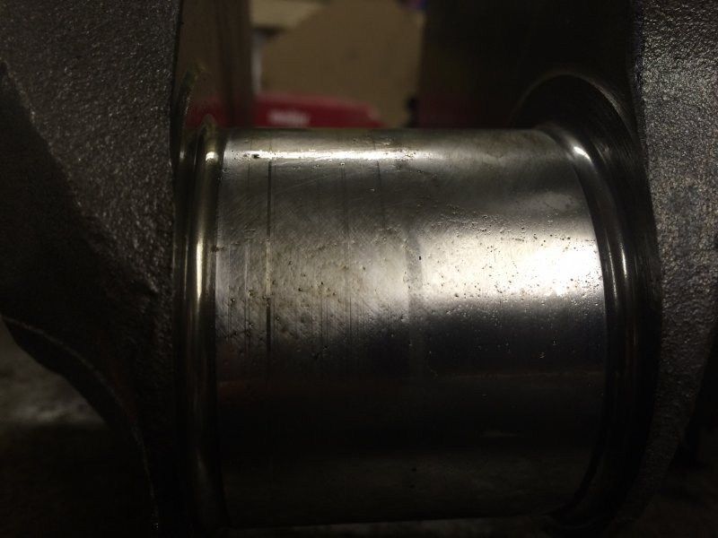

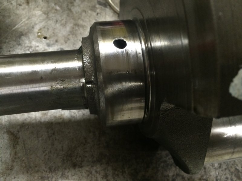

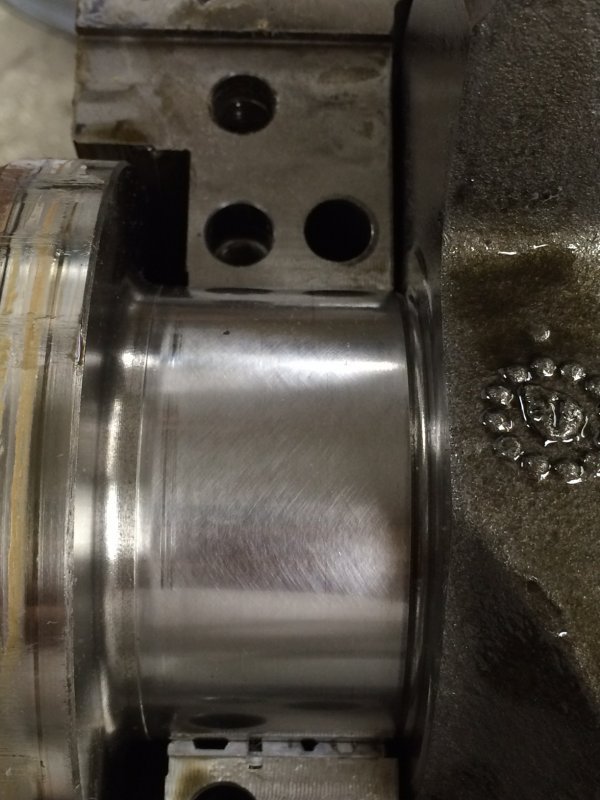

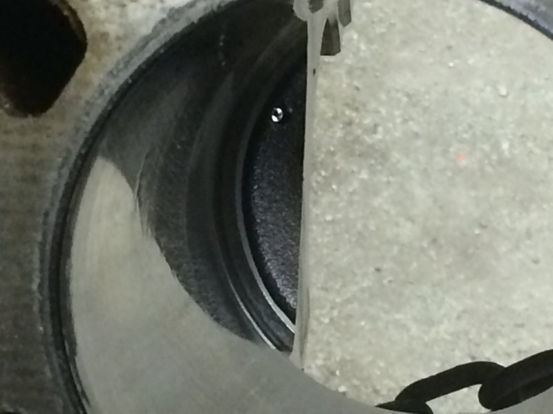

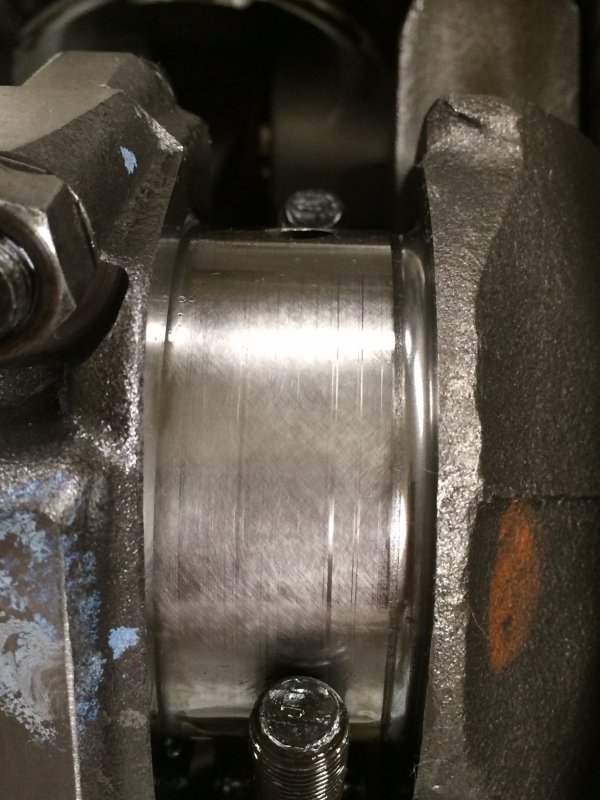

maybe it's just the pic but that crank looks like it needs attention
AK, yeah, that's just a bad pic. I uploaded those from my phone and didn't really take a look at them. Here are a couple better pics. I have never seen crank journals this pretty before...it almost looks like they have a random orbit surface to them. However, there are a couple, like the #1 rod main that have some circumferential scratches that I want them to look at. You can just barely feel the scratch with your finger nail, so I'm interested to see what they think.main 5.jpg rod 1.jpg

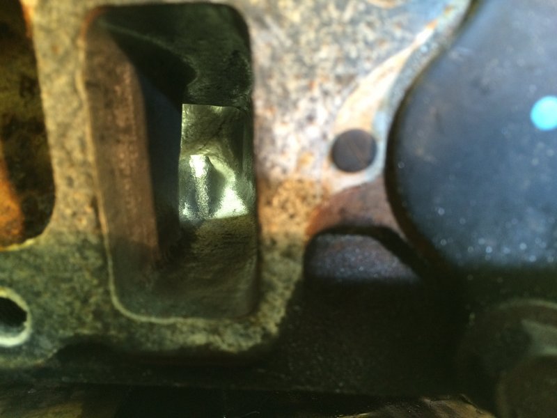

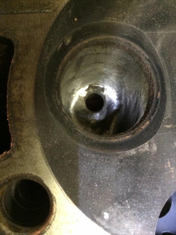

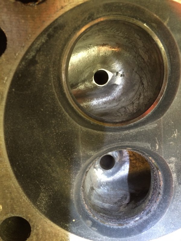

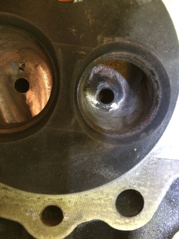

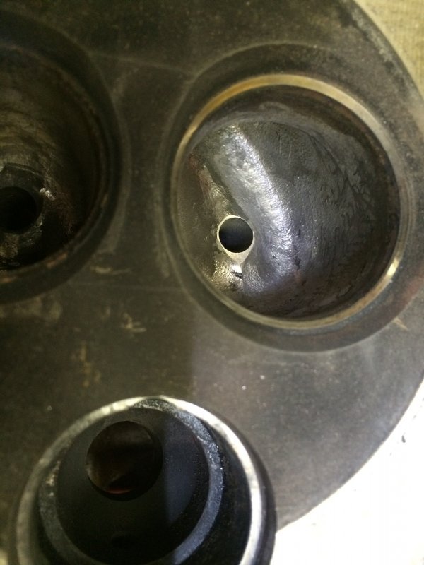

A little more fun tonight....I got one intake and one exhaust port ported tonight. Just with burrs. I'm gonna see how much some stones from Summit are tomorrow. image.jpgimage.jpg image.jpgimage.jpg image.jpg
A little more fun tonight....I got one intake and one exhaust port ported tonight. Just with burrs. I'm gonna see how much some stones from Summit are tomorrow. View attachment 44079View attachment 44080 View attachment 44081View attachment 44082 View attachment 44083
Nice work Nate. Personally, I like using the carbide cutters like your using there I think. Then I have a set of all different sizes, lengths, and grits of drum sanding rolls. They work amazing for smoothing, and polishing. I guess I never thought about spending much time porting on a 6.5, but maybe I should, especially if I want to try keeping your Tahoe!:D
That exaust valve seat you have pictured must have been in the open postion while that engine was sitting, as it looks a bit ruff, but I'm sure nothing a good valve lap wouldn't take care of. Loving the updates.:)

Hmmm ok I'll have to look for sanding rolls. Yeah just looking for aomething to maybe smooth it a little. I like the carbides for material removal and shaping but i would like these to be just a little smoother. Even as they are I'm happy with them...just wouldn't mind them to be a little smoother if I can. I've only ever used carbide burrs so it's exploratory from here...which is fun!:D
